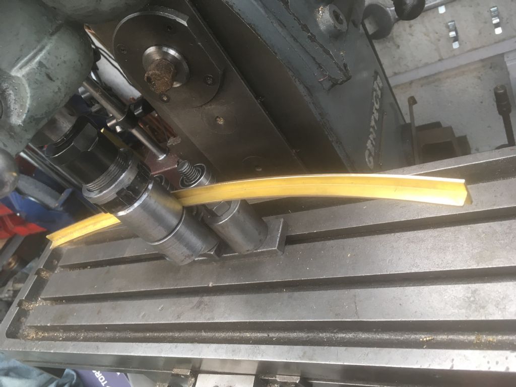

              #446668
                As seen on Traction Talk only a couple of days ago using two freely rotating rollers and the mill on slowest speed For your size of strip a couple of bearings would do as rollers.

                #446680
                John Haine
                  @johnhaine32865
                  Thanks Jason! I knew that bending rolls would do the job from an article in HJ but not wanting to buy a set just for one job I need to improvise the same method. I hadn't thought of using the mill but that looks much better than the lathe. I've got a couple of big bearings too.

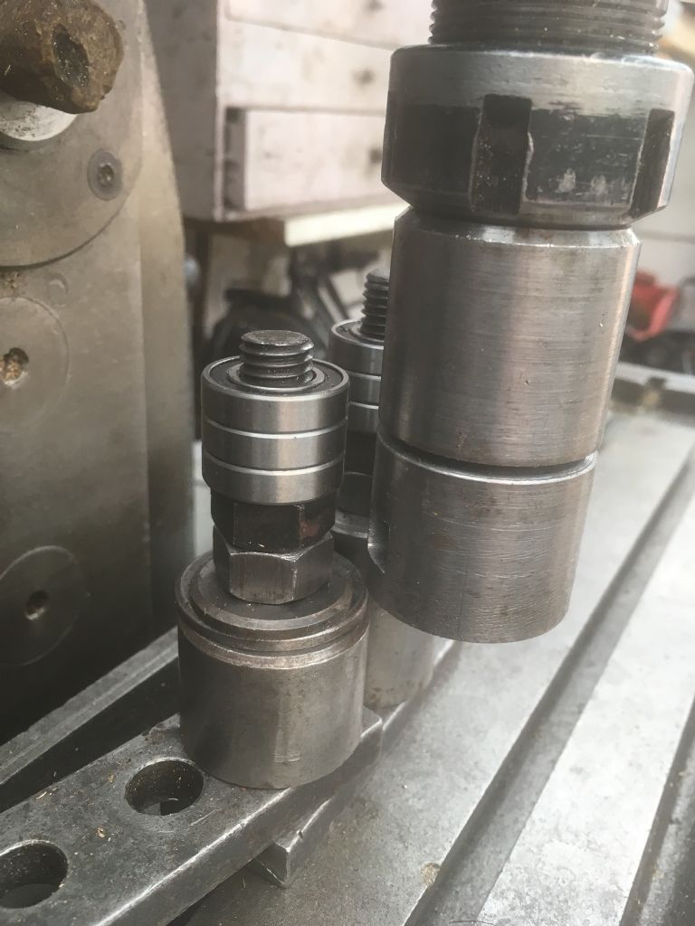

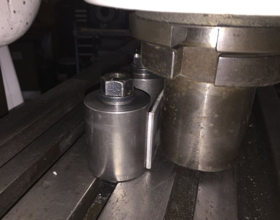

                          #446857
                          D.A.Godley
                            @d-a-godley
                            In May last year , I needed to roll some “T” section brass to support the roof of a loco cab.
                            Not wishing to purchase gear specifically for the job , I made a set up similar to that detailed by Jason , and it worked very well indeed .
                            As will be seen , a roller with a groove in it was mounted in the milling machine spindle , and a number of roller bearings mounted on the table , slowest speed and reverse at each end .
                            #446910
                            John Haine
                              @johnhaine32865
                              Thanks everyone for the suggestions, especially Jason and Mr. Godley for the photos of setups. I'll report back on progress when I've tried it, one way or t'other!
