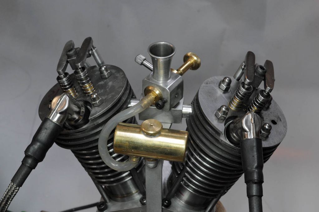

                  Update. Here's the carb and fuel tank I've made. At the moment it's too rich on idle and starved on full throttle – If it's running ok at tick over it dies when I open it up. I might have to look for a more sophisticated carb design.
                  It's not been straightforward progress. The grip on one side of the crank pin has been slackening, causing the whole assembly to twist and sieze. I replaced the hardened crank pin with un-hardened silver steel and drilled half and half to insert a screw but this didn't stop a small amount of rotation which was enough for the assembly to skew when running. This is quite a powerful engine. One side of the crank pin holds very well with the clamping screw so I have Loctited all the others. By loosening the "good" grip the assembly can still be separated to free the con rods if necessary.
                  Rod

                    Might be worth seeing if you can add an air bleed to the carb which quite a few small RC carbs have to lean things out on idle.
                    I know your crank problem, I've just got my Alyn Foundry Nattie to run and that has a two piece crank so you can run ballraces on the pin and that was slipping causing wobbly crank and flywheels.
                    Edited By JasonB on 20/04/2023 06:54:19

                          Thanks for the comments guys. The current carb does have an air bleed. I've just downloaded Jerry Howell's 2 jet drawings so I'll have a go at making that. Oh, and the fuel tank is way too small, it's a thirsty beast.
                          Cheers,

                              Well some progress today. After putting to one side for a couple of weeks, I revisited the Hoglet today and managed to get it to run (in a fashion) Using the JH 2 jet carb and Colemans camping stove fuel . It runs very hot and is impossible to restart until it cools down.
                              I tried to embed the youtube video but failed.
                              Hoglet V twin engine first run on youtube

                                      One thing I noticed when setting the ignition timing for 10* BTDC the hall sensor was at the quarter past position but I noticed on yours and others it was at the half past position the engine was difficult to start and run when I rotated the hall sensor to the half past position it was a big improvement. I now have it in that position and it reliably starts and runs.
                                      Hoglet V twin
                                      Edited By ian j on 30/05/2023 23:21:27

                                        That will likely be due to the autoadvance on the Rcexl ignition

                                          Agreeing with Jason, I think your hall sensor position is to do with the advance angle. I notice you say 10* BTDC – on the data sheet supplied with my Rxcel ignition , and confirmed by Just Engines, it should be 28 to 30* BTDC. I suspect this will position your sensor roughly vertical. Interestingly, they also confirmed with this ignition the advance is not adjustable and cant be disabled. In other words we have to live with it and set to and advance of 30* to get a spark at ( or just after?) TDC. They also confirmed the advance feature kicks in at revs higher than the Hoglet will achieve – so apart from conforming to the the angle they advise – we can ignore it ! They commented this feature is aimed at small high revving aero engines. I have trawled the internet for more details on this and drawn a blank. Given it is a reasonably cheap, easy to fit ignition, for future engines I would be interested to see rev vs advance angle data.
                                          To help set the ignition I made a TDC mark ( for the right hand cylinder TDC when viewed from the cam side  on the flywheel. This mark is made close to the engine frame on the right hand side. I then made a small brass sheet pointer which when fastened to the frame by one of the frame bolts, points at the TDC mark. I wanted to take the engine apart to get a better finish on some of the parts anyway and took the opportunity to mount the crankshaft in the lathe to make a mark 30* BTDC, and a 180* ( BDC ) mark.
                                          Timing the cams so the right hand intake closes by the 180* BDC mark ( thanks Rod ) and the timing the ignition so the right cylinder fires as close to the 28* BTDC mark.
                                          I find a reliable startup procedure is to set the carb needle to one turn open, air bypass two turns open, slightly flood the carb with fuel ( thanks Jason ) and go for it. I find this to be a reliable procedure.
