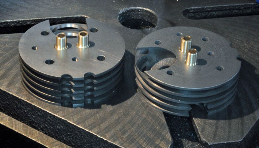

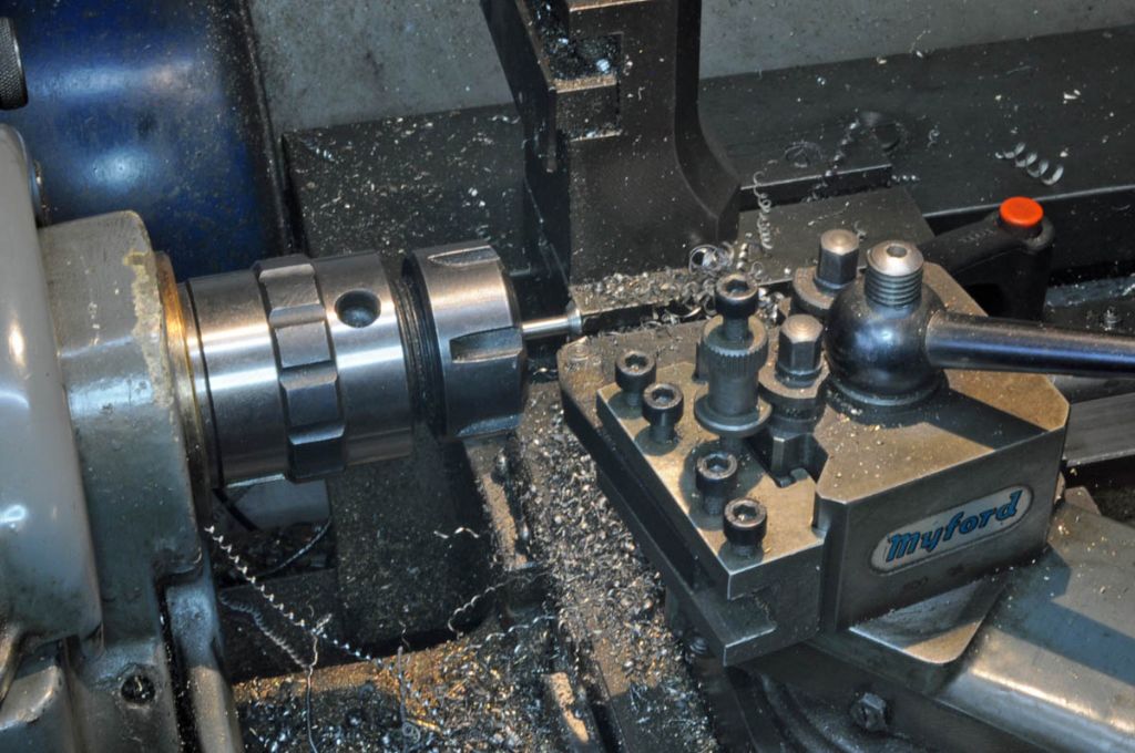

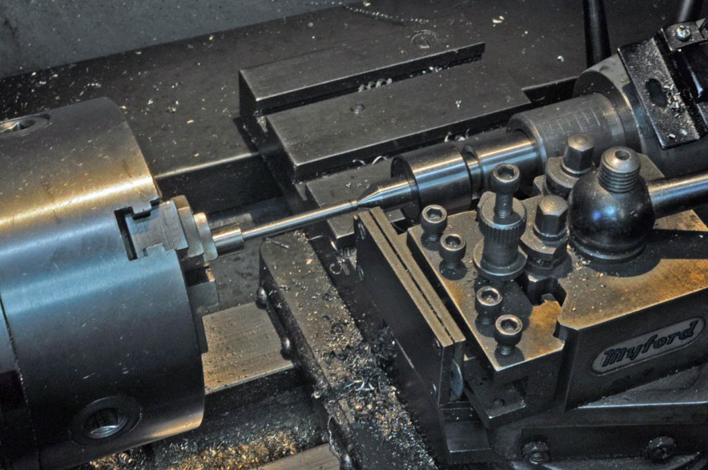

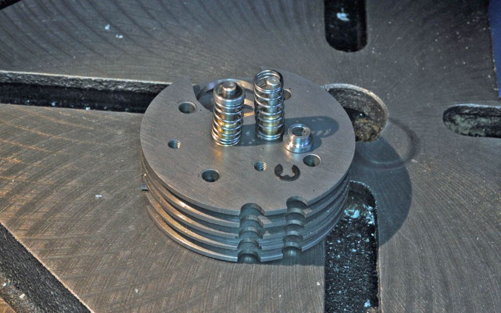

      The valve guides are brass. I turned the OD for a press fit in the head in the 3 jaw and then parted off, dialled in the 4 jaw and drilled and reamed through
      The returned to the 3 jaw (now that concentricity is not so important) to cut the spring seat and taper

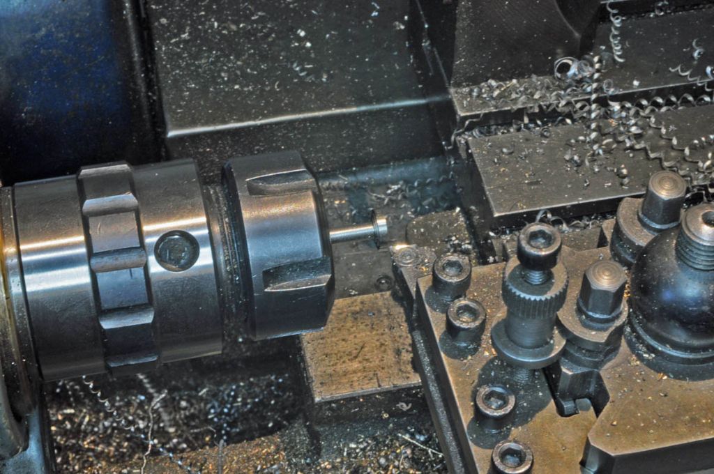

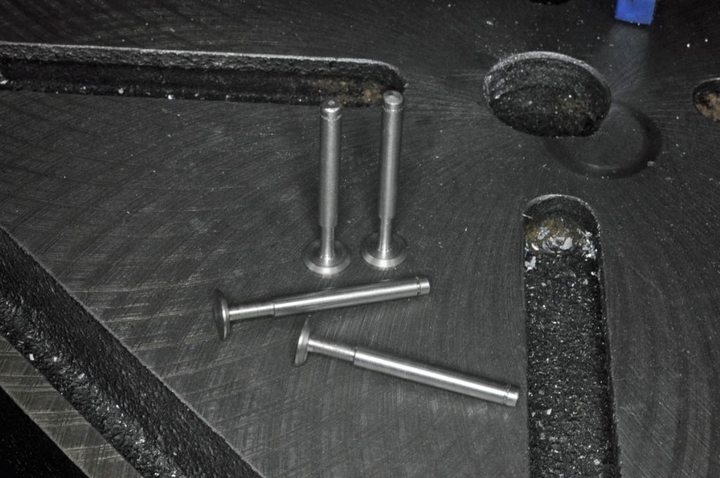

      My valves are stainless steel turned down to a 5/32" shaft and then grooved for a 3mm E clip
      The heads are relieved to 1/8" and the seats turned to 45 degrees. They will be ground in later
      4 valves, all very nearly the same

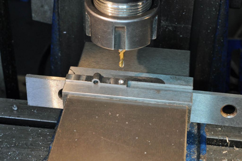

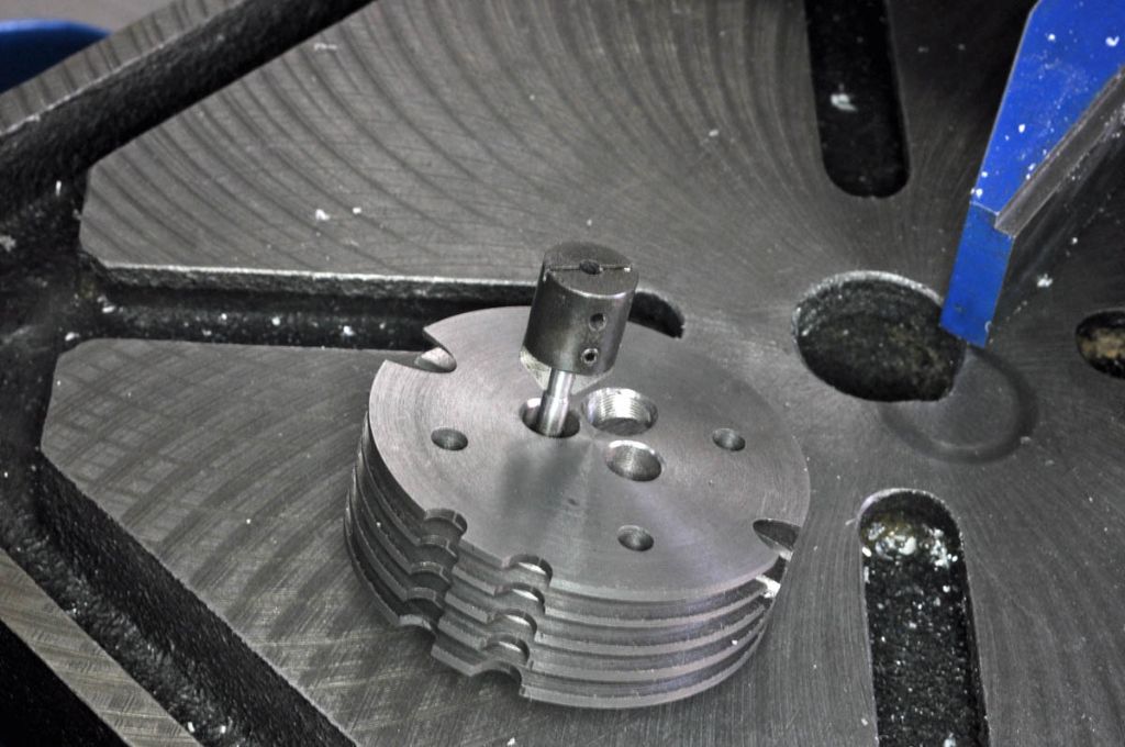

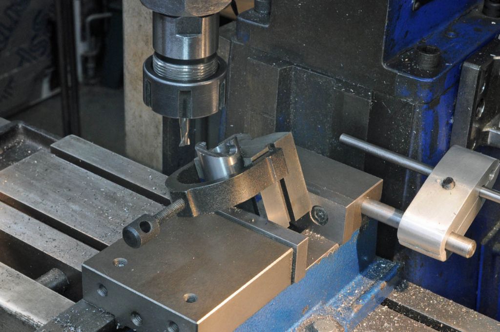

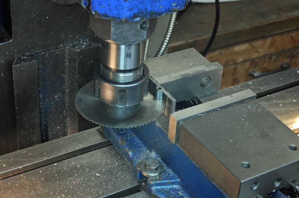

        I need 4 rocker arms. The idea was to make them as a lump then saw it up into 4 pieces. First drill for the pivots
        Then mill to half depth
        and round off the protuberance
        And slit

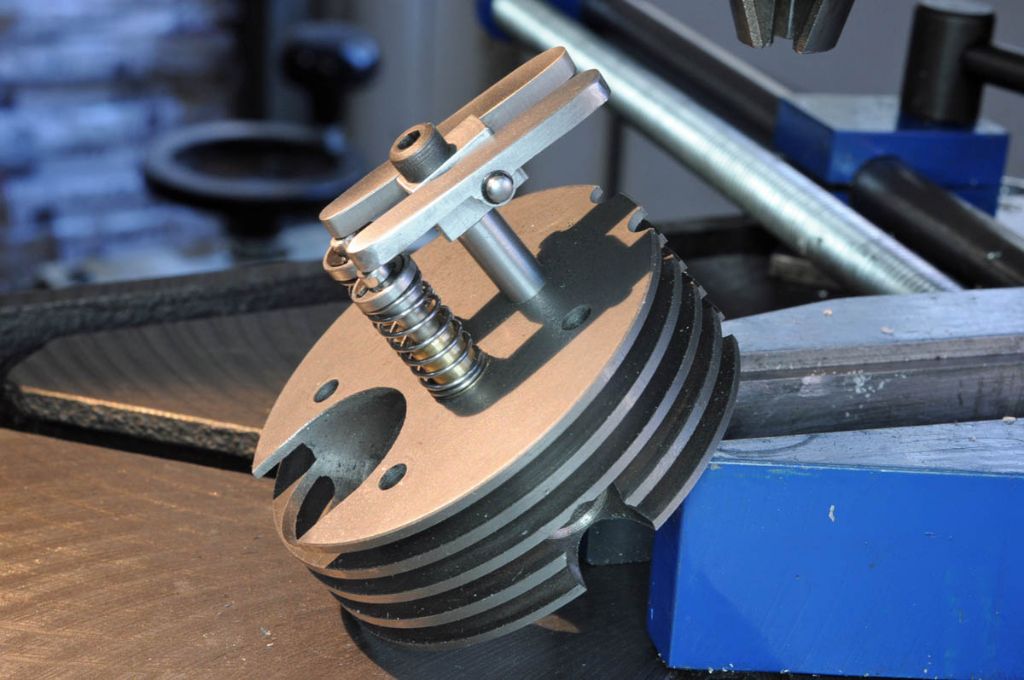

        3mm hemispherical socket for the push rod end
        Springs were wound in 22SWG piano wire at 10 tpi

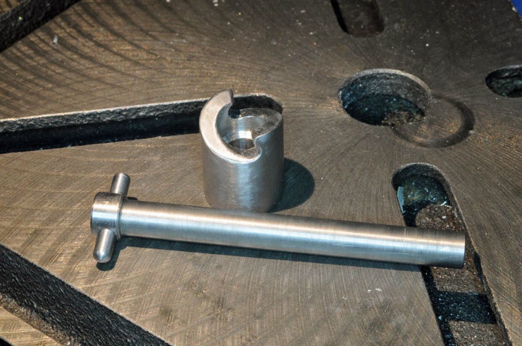

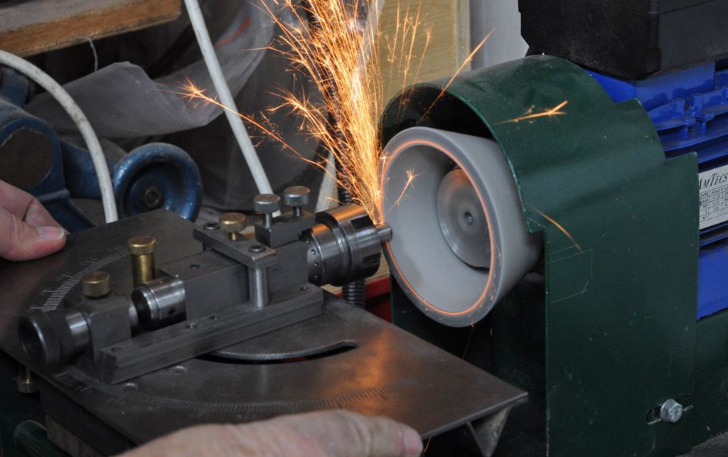

        I cut the valve seats with my trusty D bit valve seat cutter with a guide the same diameter as the valve stems
        Valves retained with a collar and a 1.5mm E clip
        A bit of hand work was required on the rockers to make them more presentable

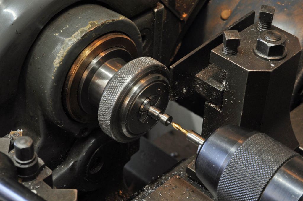

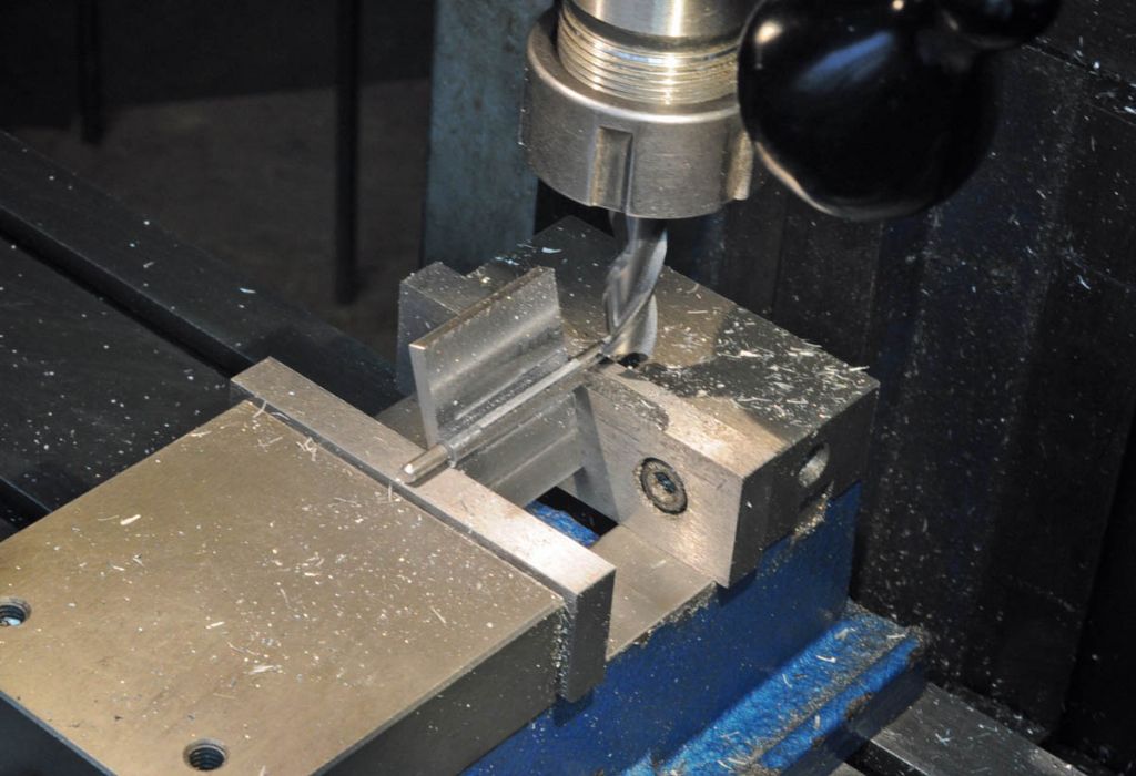

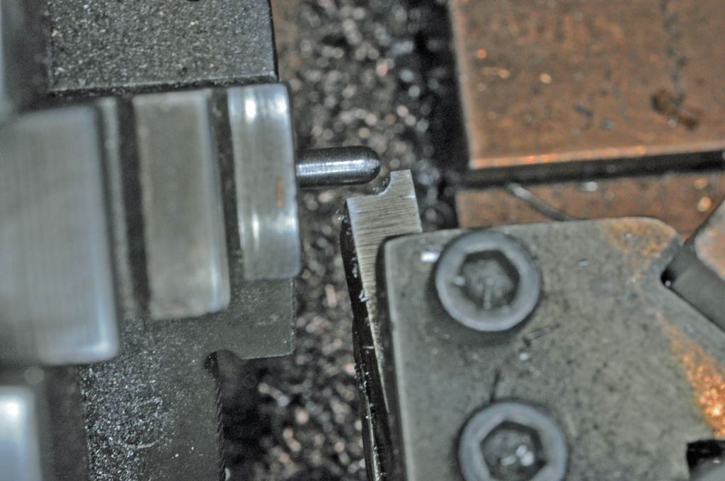

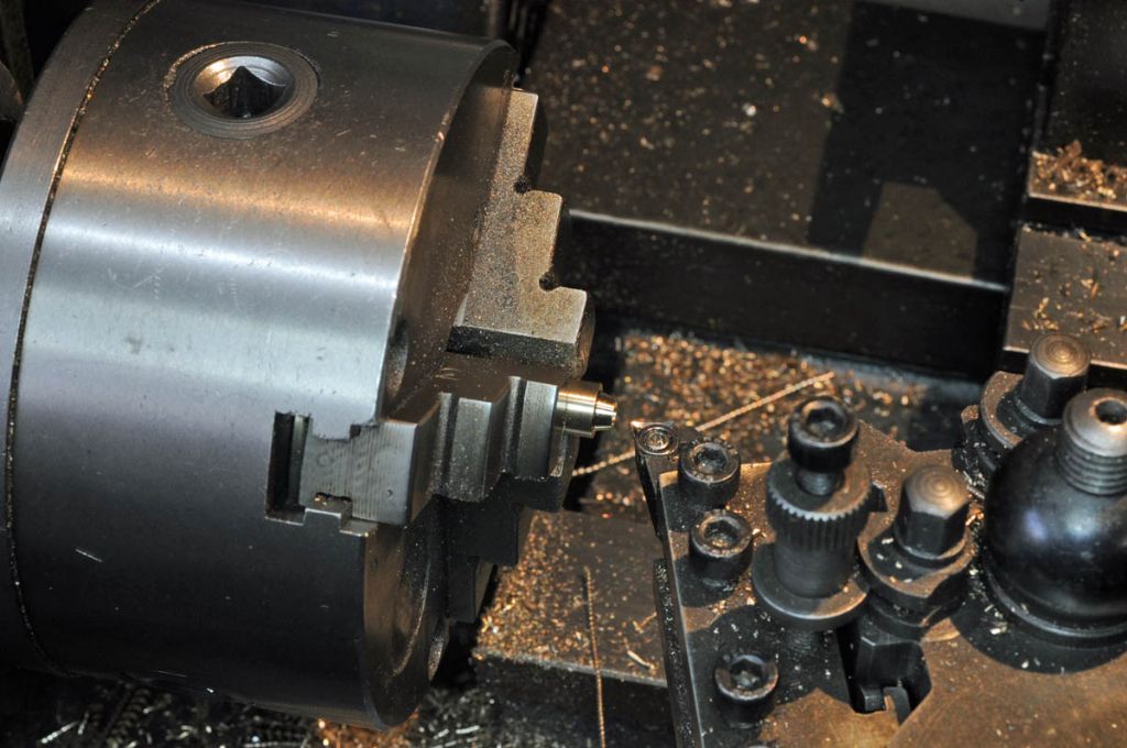

        The tappets also need a hemispherical seat – possibly the only acceptable use of an end mill in a drill chuck
        The push round ends need to be hemispherical. I made a form tool by drilling a 2.9mm hole in some gauge plate, milling the excess away then hardening and tempering
        One end threaded for adjustment and the other Loctited in place

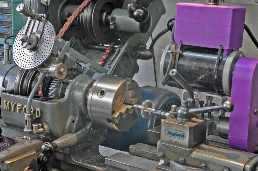

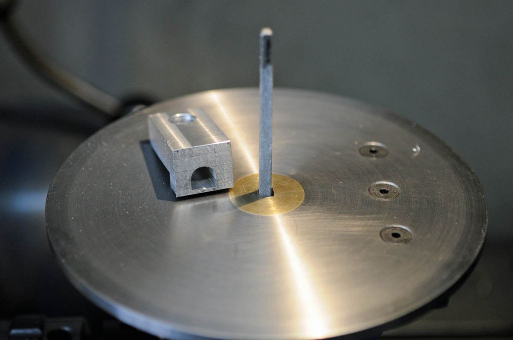

        A gratuitous picture (for Neil) of the hardened and ground dowel pin for the crank pin being trimmed

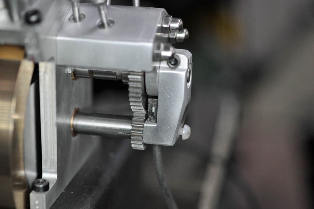

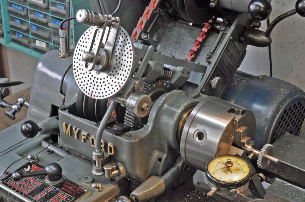

        After Loctiting the cam shaft drive gear to the cams, the holes for the ignition triggering magnets need drilling. An elephant foot indicator found the peak of the central cam and the GHT Headstock Dividing Attachment was turned to give the -120 degrees and +39 degrees spacing
        Drilled with my tool-post mill/drill

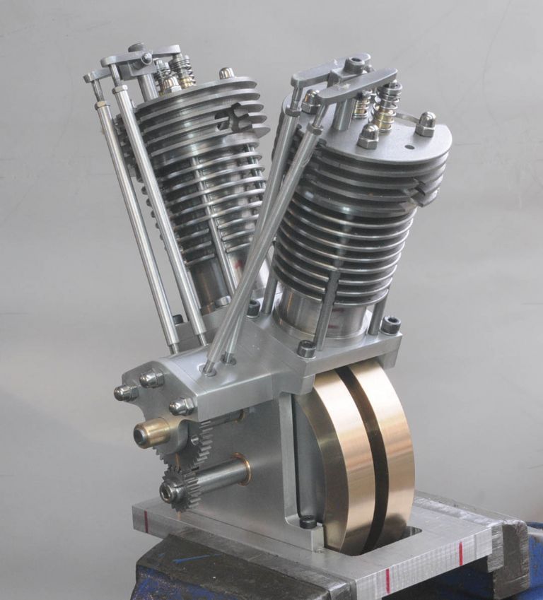

        And that's pretty much all the mechanical bits of the engine done
        Just need to wrestle with the carburation and ignition now
        Thanks for dropping by
        Rod

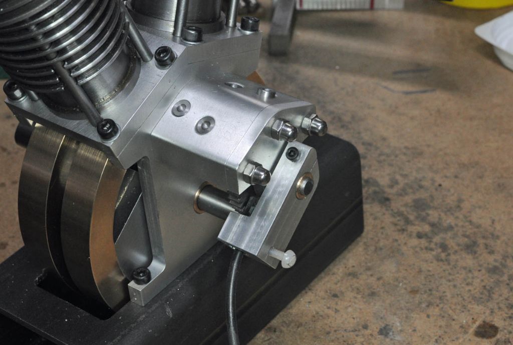

                                      This is the carb that I made according to the Matador drawings. It seems to be quite flexible since it has run my Matador, my 10cc side valve four stroke and the Wyvern. If it works I'll make a version that suits the Hoglet rather better than this lash up.

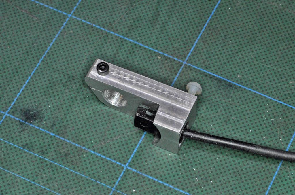

                                      This is a prototype Hall probe holder
                                      Needs a re-design to fix a couple of silly mistakes and improve the aesthetics but it is functional. Tomorrow I will have a go at getting the Hoglet to fire up. Don't hold your breath.

                                          That Hall probe holder didn't work. It needs to be able to rotate through a larger angle, which means that the crankshaft timing gear screw needs to be flush with the gear which means disassembling the engine to remove the half shaft – glad I didn't Loctite it!
                                          Redesign of the Hall detector meant using the die filer to make a D shaped hole smiley
                                          I think this design is a bit more in keeping with the overall look
                                          I'll try again tomorrow (minor domestic crises permitting)

                                              It took a bit of fiddling about, the timing is still not quite right, it's blowing back a bit through the carb but, hey, it goes smiley

                                                  Chuffs away very nicely. Well done!
                                                  Based on full sized Harley V-twin experience, spitting back though the carb is most likely lean mixture.
                                                  Spark timing too retarded can also cause it due to weirdness associated with the "waste spark" that fires on the exhaust stroke on the other cylinder, but 45 degrees late due to the cylinder spacing — so can end up sparking at or a bit after TDC as the intake stroke is starting. If there is enough mixture in there already it can cause a hiccup. (Technically known as a "carb fart".) Not sure if this attribute of a full sized V-twin with one carb transfers down to model scale but may be something to fiddle with and see.
