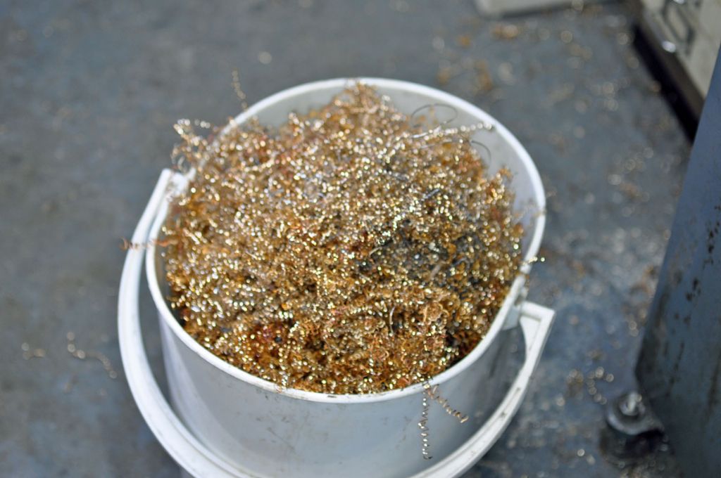

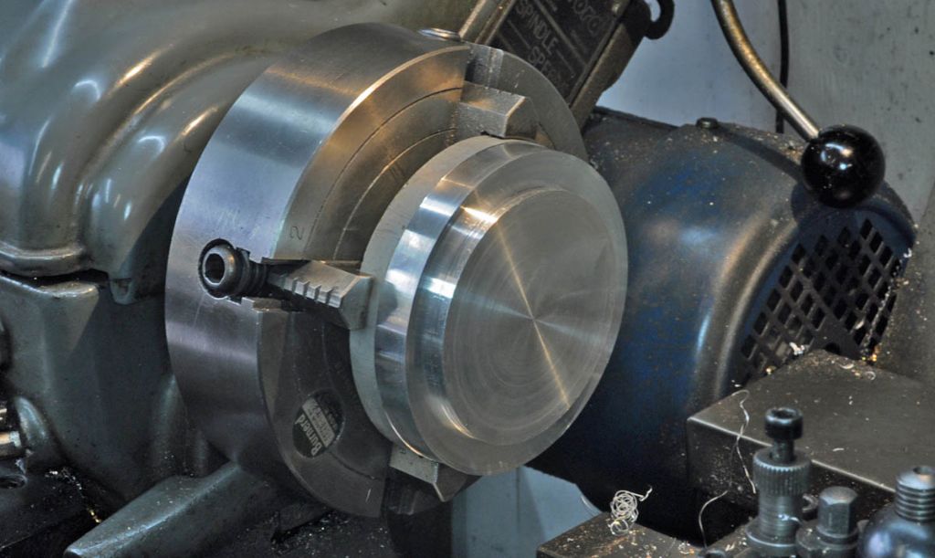

                        #616568

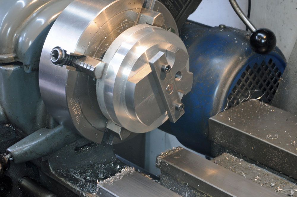

                        Roderick Jenkins
                          @roderickjenkins93242

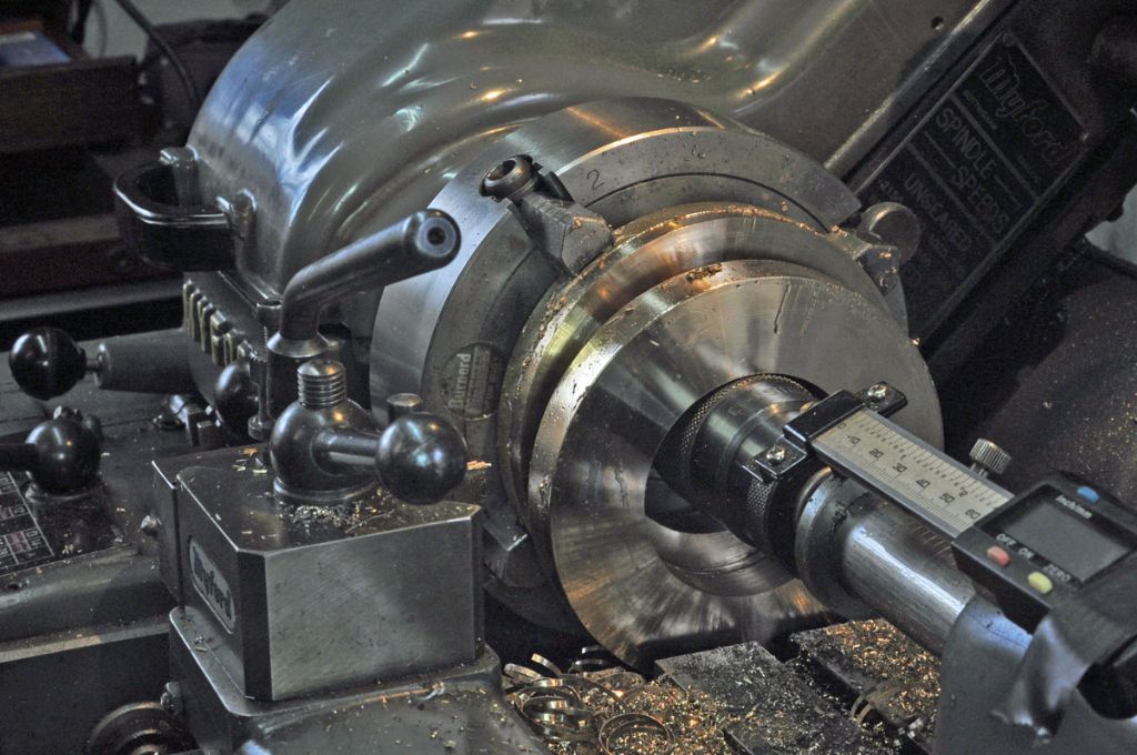

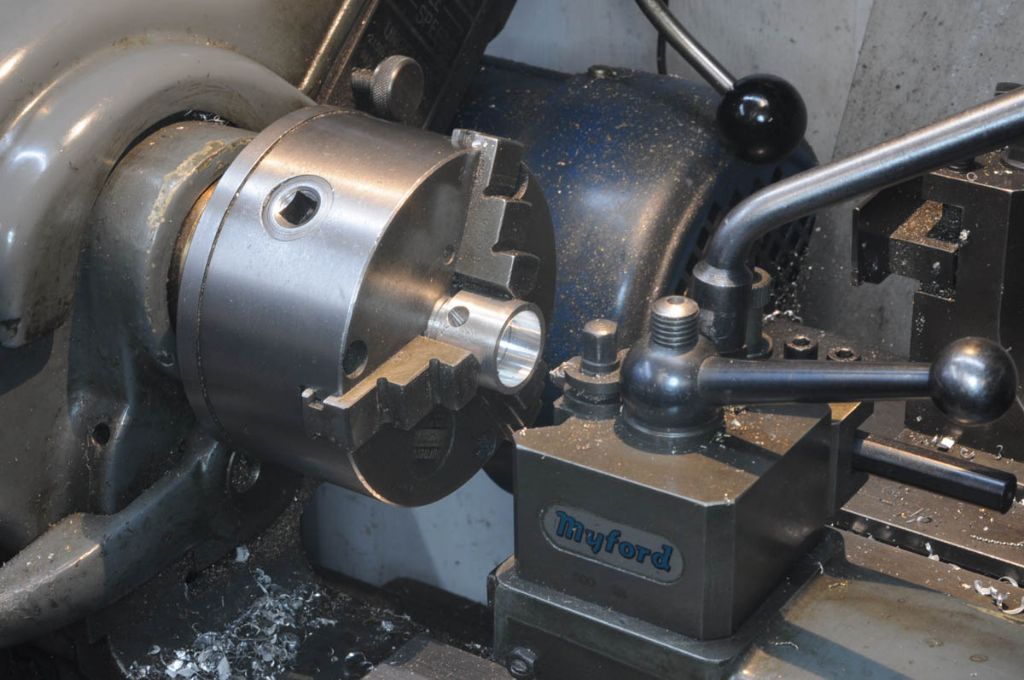

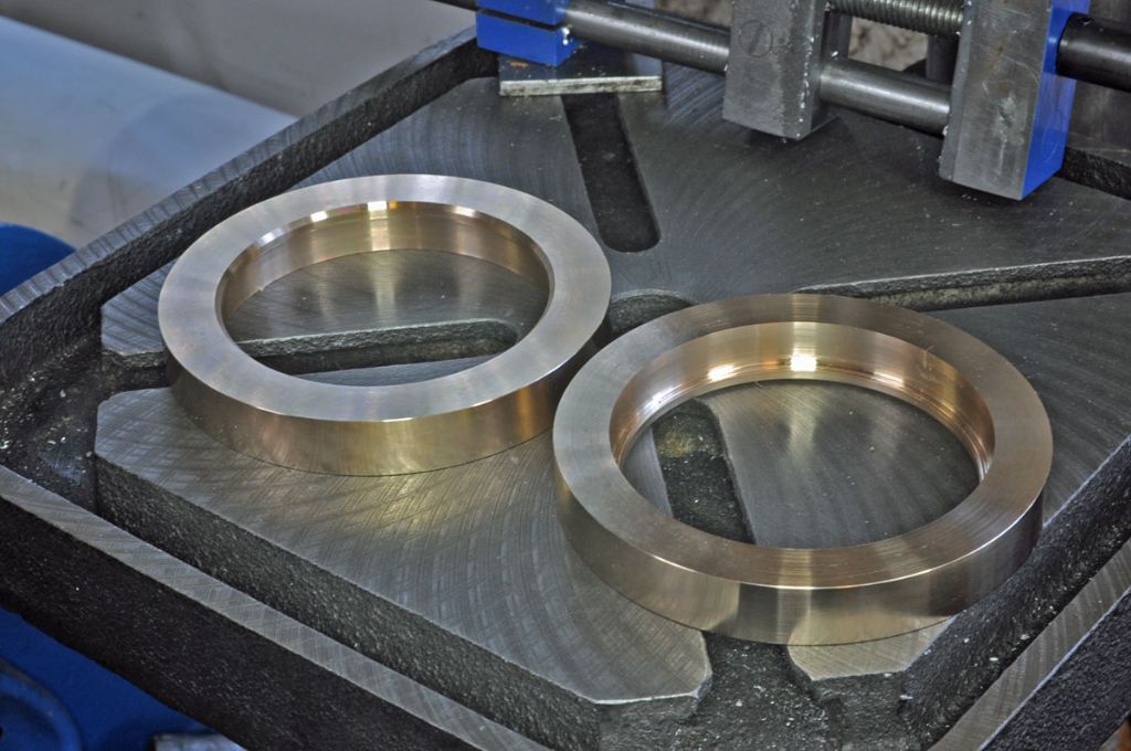

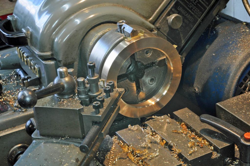

                          My view of the Hoglet is that it is largely a noise maker. For just getting the engine to run then the cam timings are not at all critical – the article refers to some quite radical changes to get a more Harley like burble. If the cam angles are reversed then it should still be fine, as Andrew may have demonstrated smiley

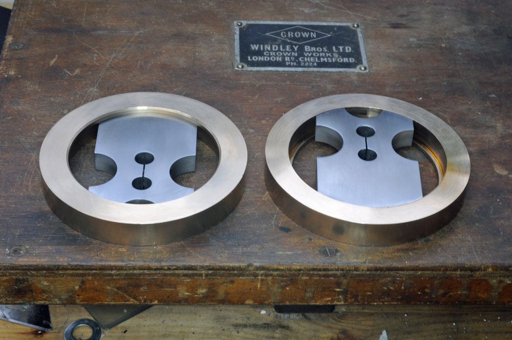

                          Flywheels. I opted for the expensive bling factor with a length of bronze pipe. Cleaned up inside and out in the 4 jaw. Cuts very nicely with a CCGT 0.4 tip
                          Tough stuff though, parting in 2 was a struggle. My carbide insert parting blades wouldn't touch it but the HSS blade, freshly sharpened it worked OK, albeit with a lot of screeching and complaining

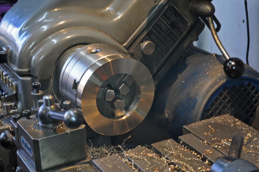

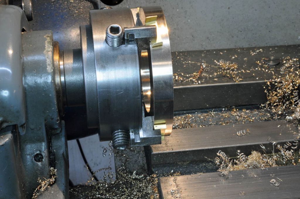

                          Held in the 3 jaw by the inner circumference for final thicknessing and O.D.
                          Then transferred to my smaller 4 jaw so that I could bring the inner measurement to size without the jaw interfering with the through cut
                          Then the chamfer
                          Shiny!
                          All that expensive swarf crying

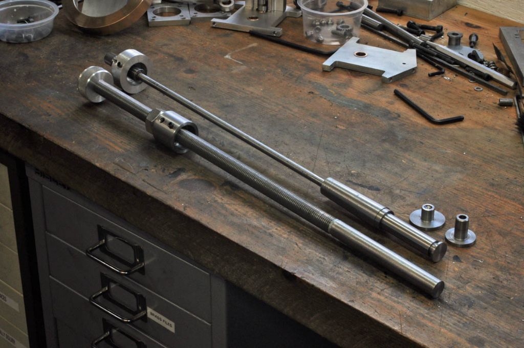

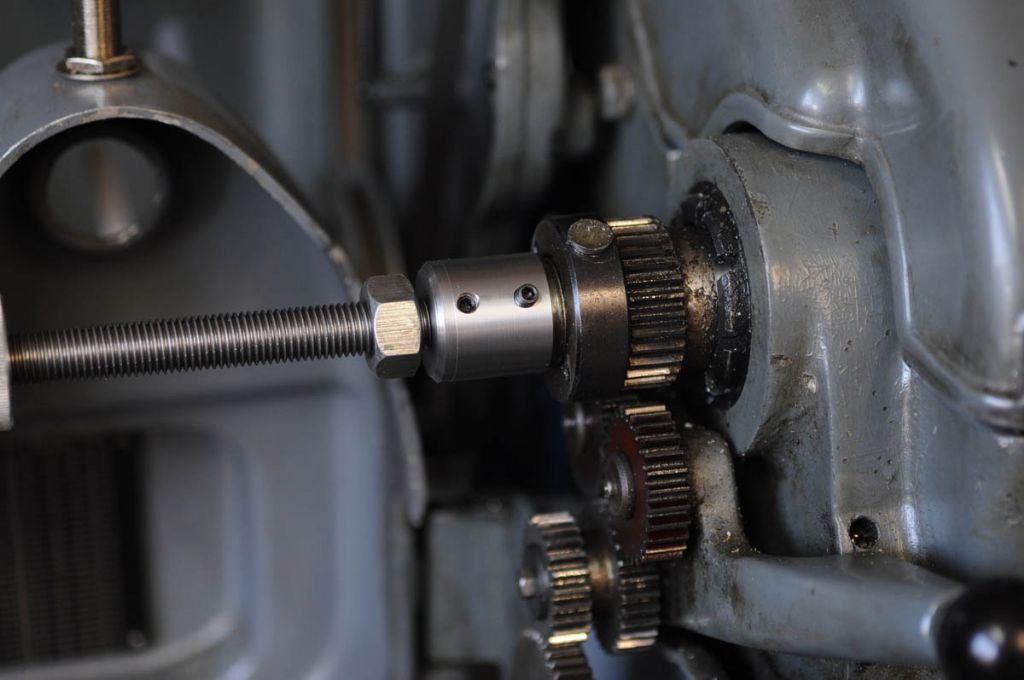

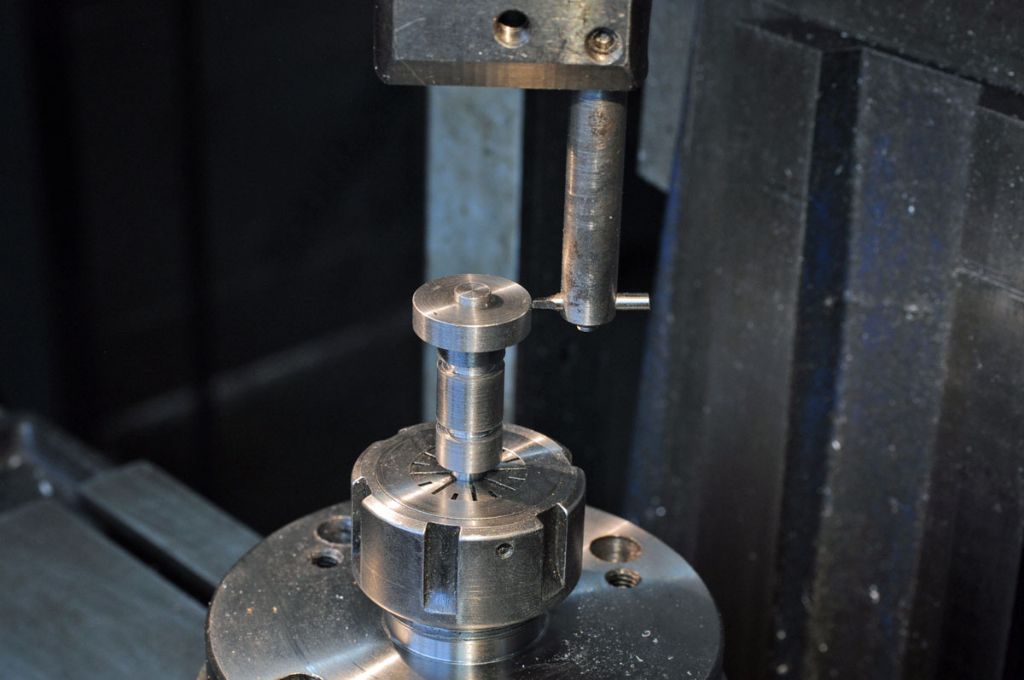

                          I was struggling to get accurate i.d. by measurement with a caliper gauge – my telescope gauges are not large enough. The crank webs need to be 3 thou over size for the shrink fit. I turned an ally spigot to fit each crank ring that I was more comfortable measuring to get an accurate figure, there is a couple of thou difference between the 2 rings

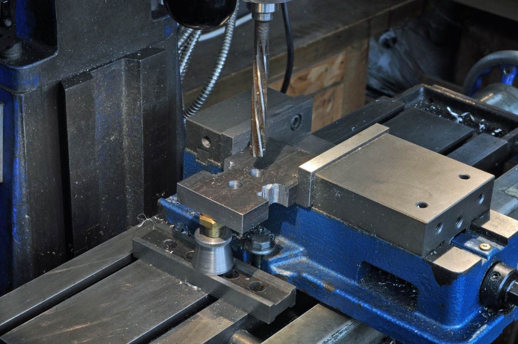

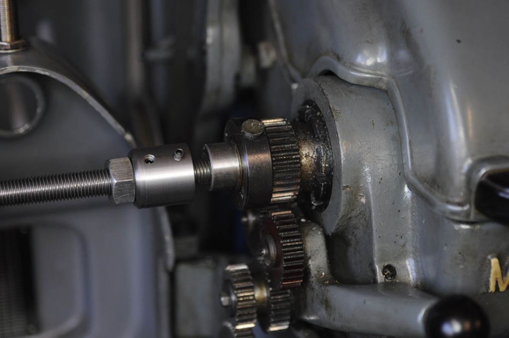

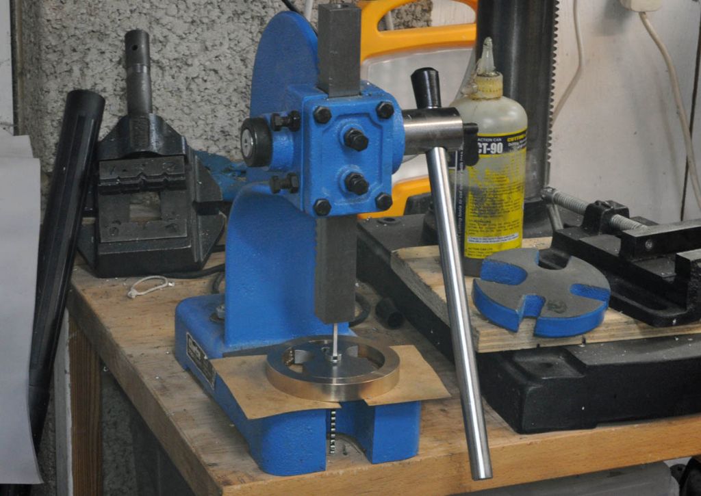

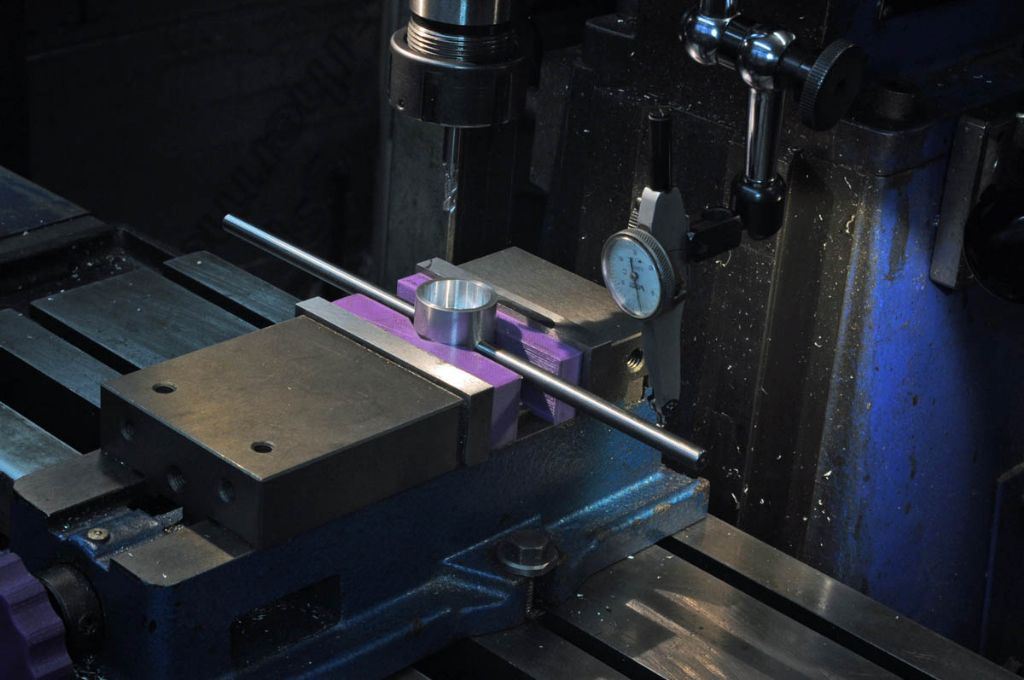

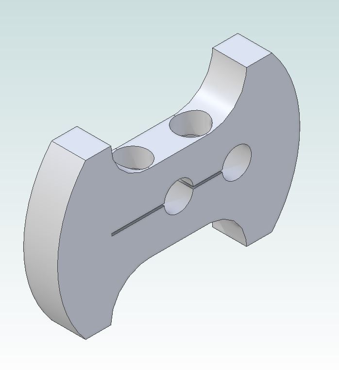

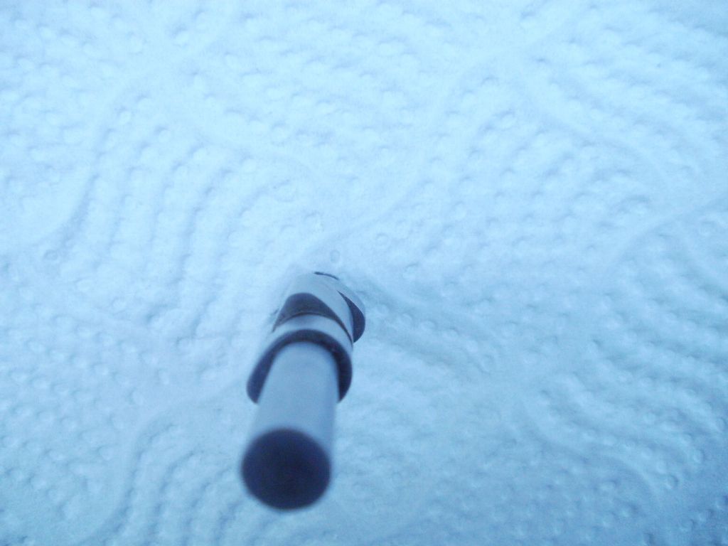

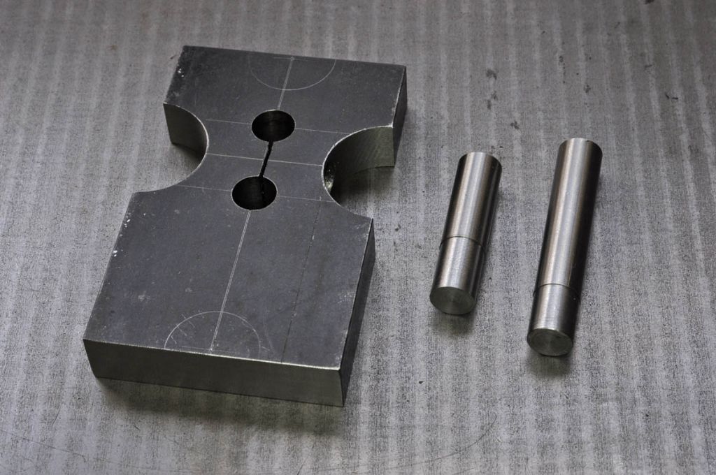

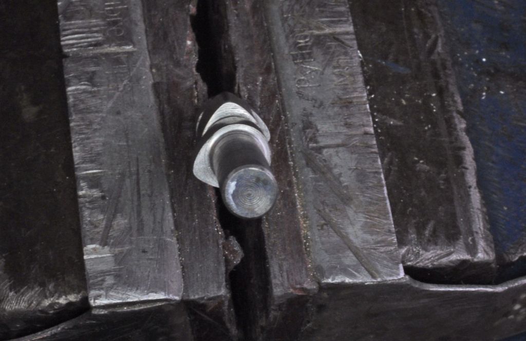

                          I've been giving some more considered thought to the issue of grabbing the crank shaft and pin in the crank web. My first thought was to minimise distortion by stress relieving the 2" x1/2" bar that I will use so I heated the blanks up to 550C in my little furnace and let them soak for an hour before allowing them to cool in the furnace.
                          The next idea was that working on the principle that it is easier to make a shaft to fit a hole than vice versa I would ream the hole to 23/64" rather than 3/8" and turn down the end of the pin for a good, tight fit. The disadvantage of this method is that the crankshaft/con rod assembly will have to be pre-assembled and the crankcase built around it
                          The weight relieving crescents were roughed out by chain drilling before finishing with the boring head
                          Quite a bit of trial and error ensued. To cut a long story short the the reamer (of unknown provenance and tolerance) is nominally 0.359" diameter. To get a pin to grip in the hole using an M5 screw to close up the holes the pins needed to be a tightish "tap home with a hammer" fit 0.362" diameter and be within 0.0002" the same diameter otherwise one would tighten and the other wouldn't. That entailed quite a bit of work with a dead smooth file
                          Both of these pins held securely enough such that if I grip them tightly with the fibre jaws in the vice the pins will turn in the vice rather than in the web
                          So I guess that sort of works and will have to be repeated for the other web. Whether that is better than using Loctite I'm not sure. However, the experience leads me to wonder whether an undersize 3/8" reamer might do the job. Not easy to source for a reasonable sum but a 9.5mm H7 reamer is nominally 1 thou under 0.375" and ARC sell them for a pension friendly(ish) sum. Order placed…
                          Watch this space for the next exciting installment,
                          Rod

                            #620679
                            Roderick Jenkins

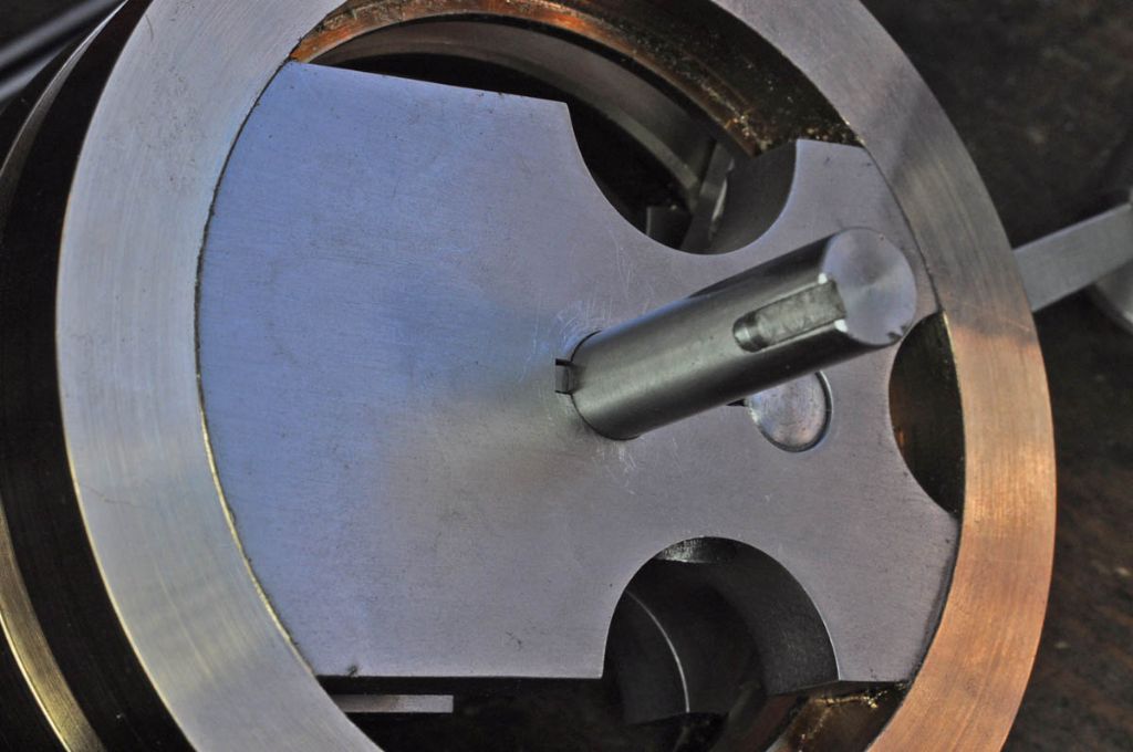

                              Well, I got the 9.5 mm reamer and a 3/8" ground and hardened dowel pin to act as the crank pin. After a lot of trial and error and worry the best I can do is to use the 9.5mm reamer followed by a nice new 3/8" H7 reamer. After tightening the screw the crank pin is very firm but the crankshaft pins less so. Does this matter? As this motor doesn't drive anything the only loads on the crankshaft are starting torque and the drive to the cam shaft (I think). If it does shift it will only be the timing that is upset. I'll probably Loctite everything anyway.
                              The webs were reduced to final thickness:
                              The turned to final diameter. Don't let anybody tell you that you can't use a CCGT tip on an interrupted cut.
                              I've chickened out of the shrink fit option, the webs are push fits and will be Loctited
                              Rod

                                Looking good Rod
                                I did extend the slot in my webs beyond the other side of the crankshaft hole to allow things to close up a bit more under the load from the screw. Just thinking about it now it would be possible to add a second screw if the cutouts were extended which should pull things up even tighter.
                                Another option if you do get the shaft slipping would be to add a narrow keyway so a key could be used in that and engage in the slot with a bit of clearance so it does nor prevent the slot closing up,

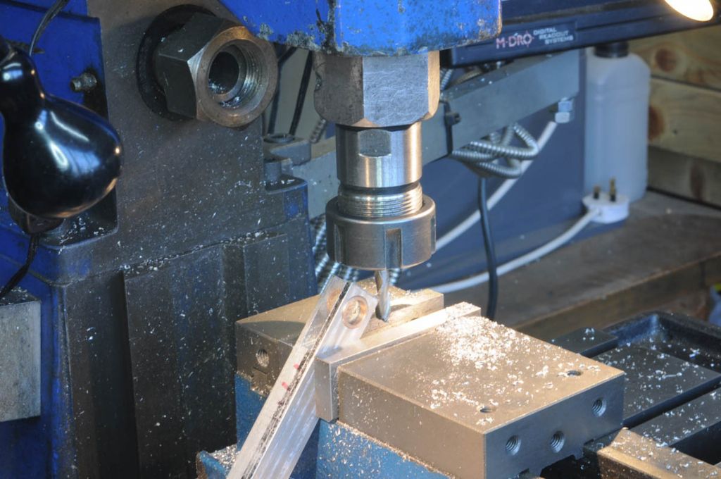

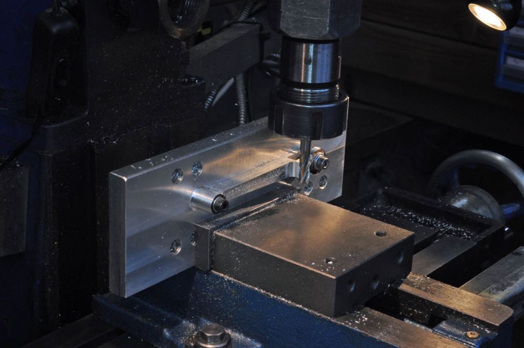

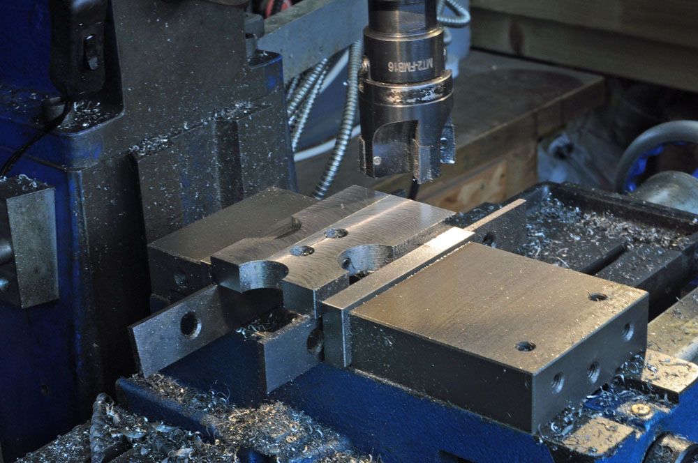

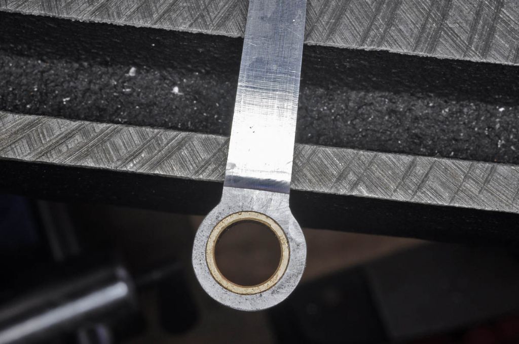

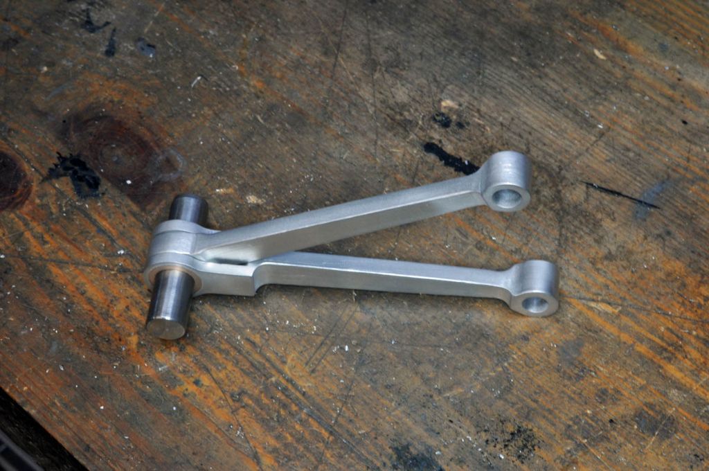

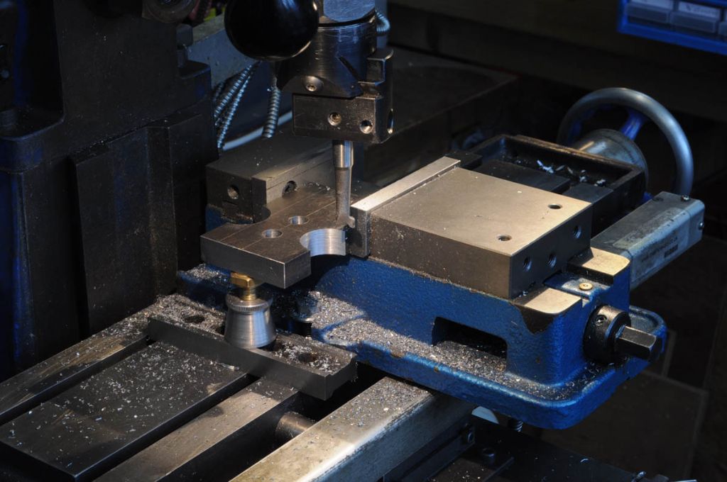

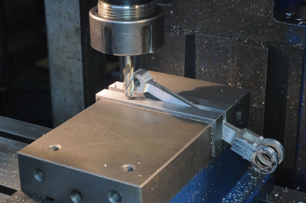

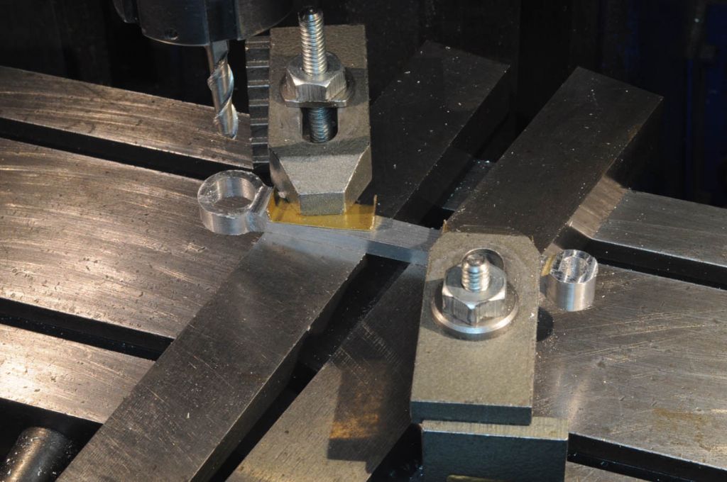

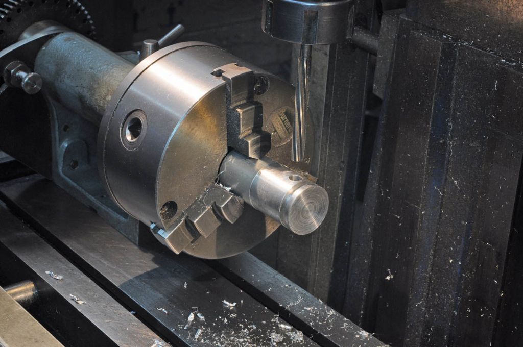

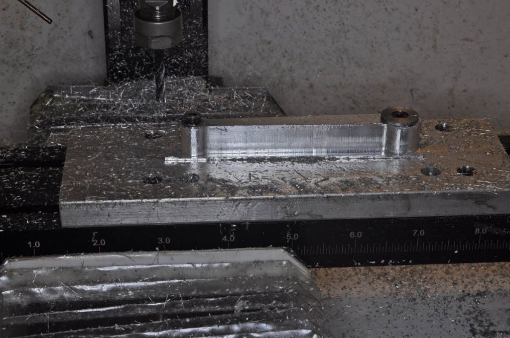

                                  It's been a while. Hoglet and I fell out so I thought it would be better if we spent some time apart. We're communicating again now (all my fault). I had spent some time debating whether to use CNC or manual methods for the con rods. I'd assumed they were much the same so the same CAD drawing would do for both. For some reason I was completely blind to the differences in the plans. Made one con rod and had to rectify some issues with the CNC mill.
                                  The blank was drilled and reamed on the manual mill for the big and little end pins, then profiled on the CNC
                                  Moved to the manual mill to thin the shaft
                                  and bring the end to the right thickness
                                  I was not particularly happy with the way that plans use glacier type bearings so decided on some bearing bronze for the big end. Note the asymmetry in the bulge caused by a backlash issue on the CNC Y axis.
                                  It turn out (obvious really!) that the forked con rod needs relief on one side to allow free movement of the other rod in the narrow V between the cylinders and some more meat at that end to allow for it..
                                  Profiled manually
                                  Little end thinned to 1/4"
                                  After a little bit of titivating with files and scotchbrite
                                  Rod

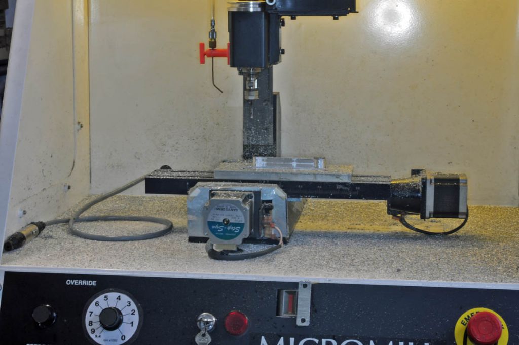

                                  #630111
                                    Nice Rods Rod
                                    I thought you might have done the thinning of the shaft on the CNC or does it only do 2D?
                                    #630325
                                    Roderick Jenkins
                                      Posted by JasonB on 11/11/2022 18:47:35:
                                      Looking good Rod
                                      Thanks Jason. I think that's the way forward. I'm using a hardened dowel pin for the crank pin so not an option there but fortunately the crank pin is gripped quite well. It is the other 2 that can be less firm and they will be un-hardened silver steel.
                                      The CNC mill is fully 3D with Fusion 360 but, illogically, it seems less trouble to use the manual mill for fairly simple shapes.
                                      Cheers,
                                      Rod

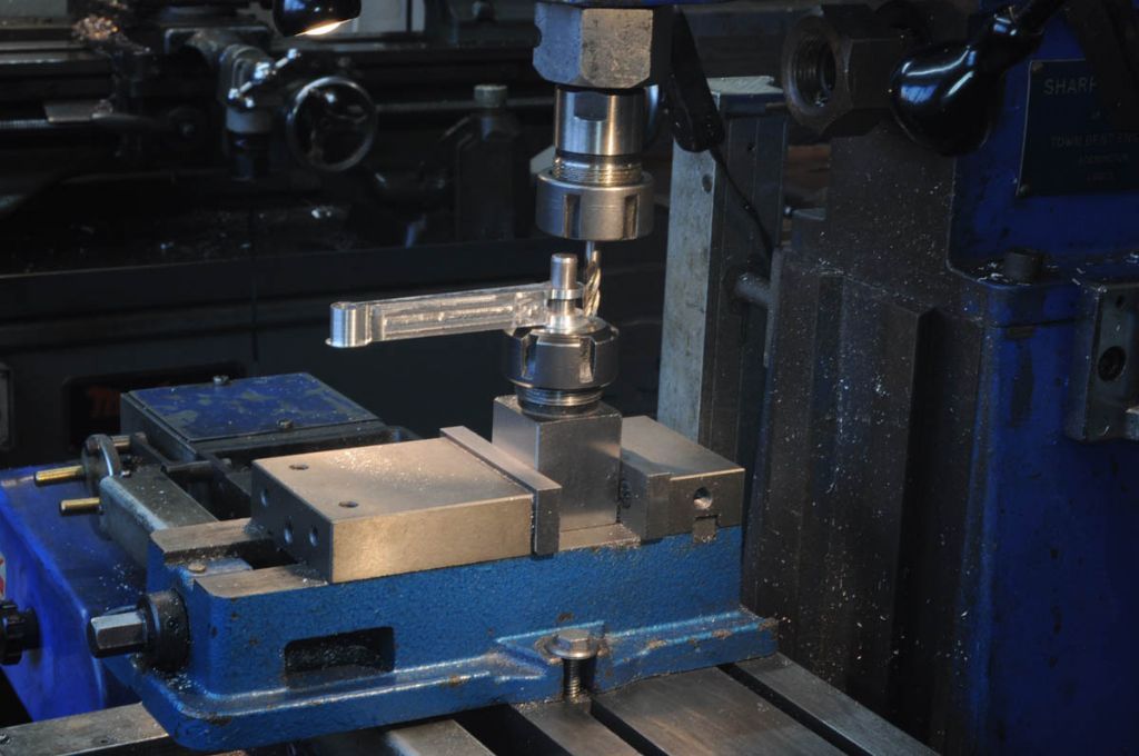

                                            #631293

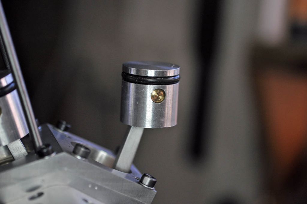

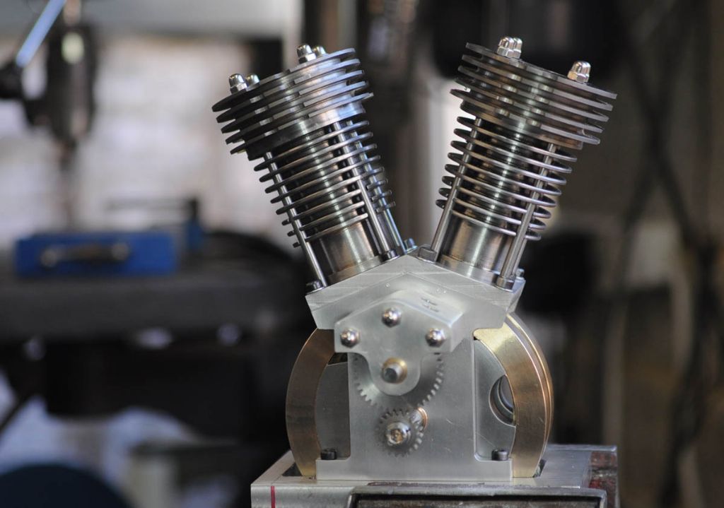

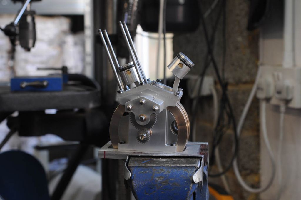

                                            Roderick Jenkins
                                              Pistons are straightforward. Turned on the lathe then transferred in the chuck to the mill for drilling and reaming the hole for the gudgeon pin
                                              Then back to the lathe for hollowing out
                                              then back again to the mill to cut the relief for the little end of the con rod
                                              As per Jason's suggestion, the crank shafts will be keyed
                                              3mm slot drill
                                              That seems to work
                                              The cylinder studs are 4" long and I need 8 of them so a bit of mass production called for. My original lathe backstop was designed for holding thin parts square in the chuck. The depth is adjusted by a 40tpi thread in the Morse Taper. It won't go anywhere near accommodating a 4" stud. An hour's work made a new backstop with some 1/2" BSF studding which will take longer lengths.
                                              The O rings are the same as I used to great success in my Farm Boy – rather larger cross section than specified but they are what I've got
                                              It's beginning to look like an engine. The pistons go up and down and the cam gears mesh smiley
