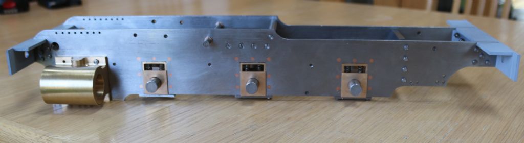

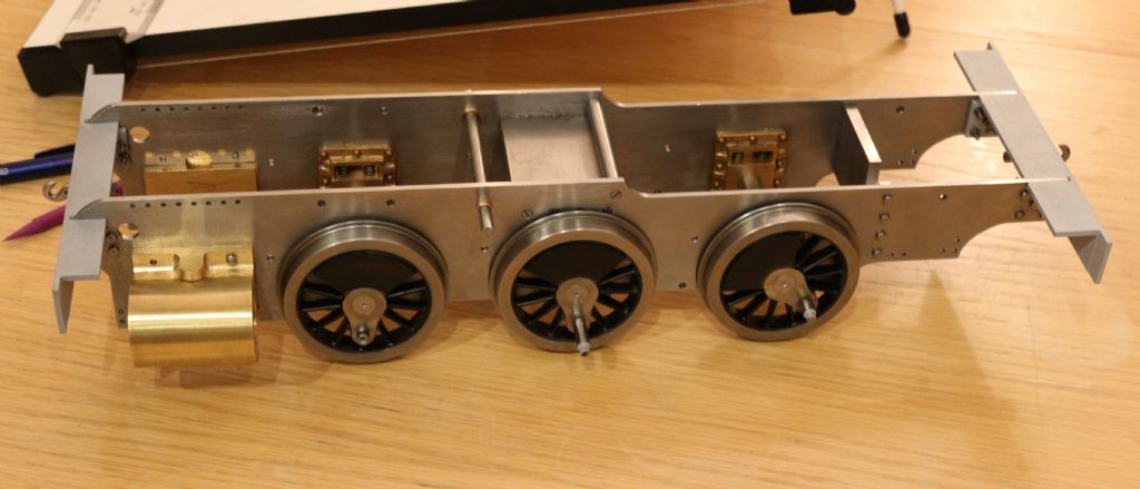

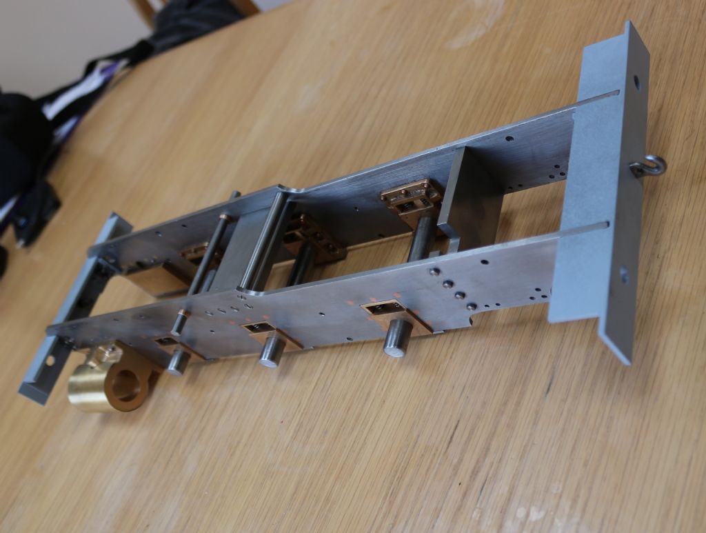

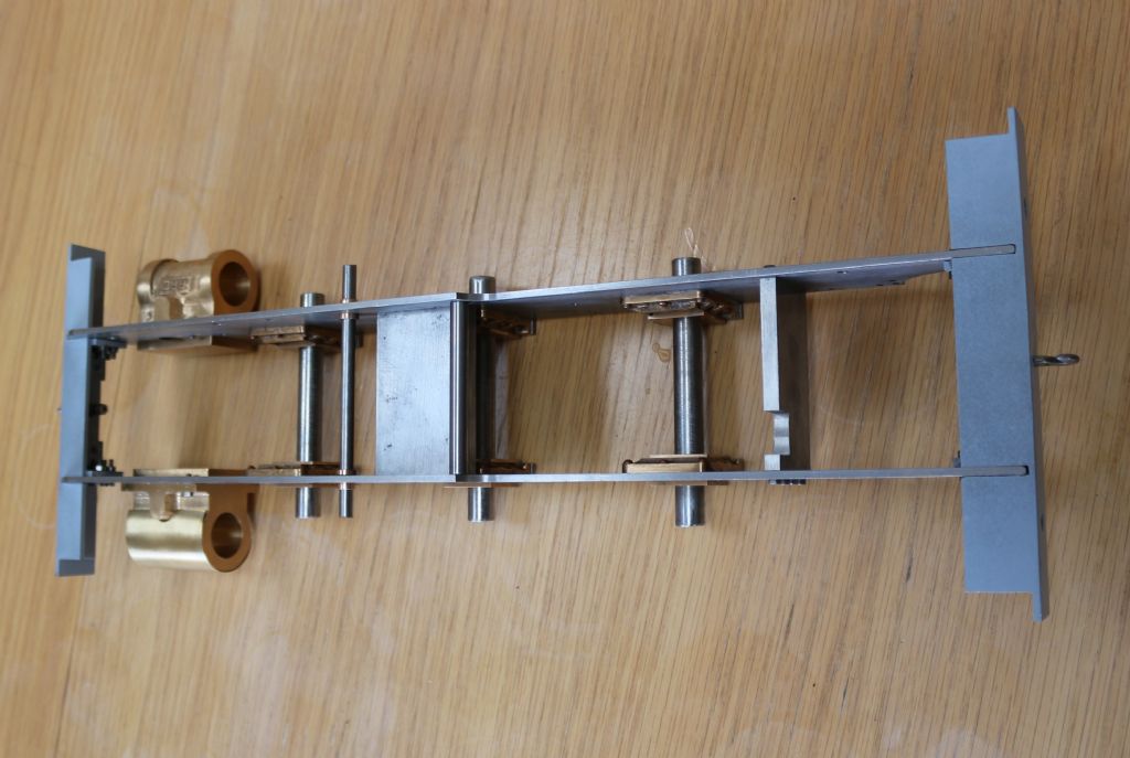

      My guess is that the Rob Roy rally due to take place in late June this year is off the cards?
      I was going to attend with my part built effort so here is where I am up to on 2nd April 2020.
      I have also machined the wheels and few other parts of the cylinder set. My aim is to get the chassis at least rolling by the end of June but lets see how that goes.
      Phil H
      Side view
      Top view
      Angled view

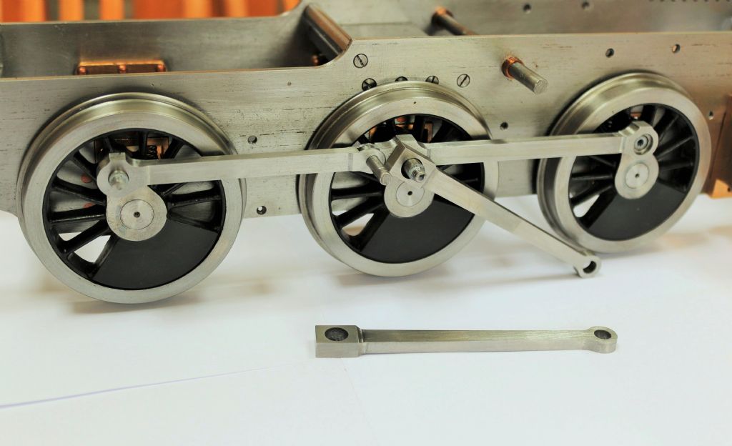

                  I believe the original date for the 2020 Rob Roy rally was today? I would have tried to be there but I am unfortunately still at the rolling chassis stage – so not much to show.
                  The good news is that there is enough meat on the cylinders to avoid the offset valve crosshead and I have managed to quarter the wheels using a fixture made from bits of scrap metal. So my engine currently looks a bit like this;

                    looks like a lovely job Phil, much better than mine built years ago, now in need of a major overhaul and repaint, but it's been great fun running it and wearing it out!
                    I had great difficulty setting the Stevensons valve gear on mine, partly due to inexperience and a little bad advice, however I found the late Don Ashtons book on stevensons gear and using his simple design of jig for setting the eccentrics, and eccentric rod lengths all was well. I wasted months of trial and error before i got the book, I didn't do any redesigning just assembled it using the jigs and his clear instructions on valve setting. I'm sure as you've already fitted the eccentrics and quartered the wheels that the jig could be adapted to set the eccentrics in situ without having to remove the wheels.
                    Incorporating these into the engine as you build it will save time and heartache.Having said that there seem to be lots of Rob Roys built to the instructions that run very well. It may be that I'm particularly dim . at one point I got the chassis running reasonably backwards but poorly forwards, unfortunately you can't turn the boiler round as the firebox fouls the steam chests so i had to sort it out!
                    A guard over the rear axleboxes would be a very good idea as the rear ones on mine are very worn due to ash getting in the bearings. I also changed the height of the blastpipe slightly I can't remember the details but I used the taper gauge method and it did steam slightly better.
                    Keep up the good work!

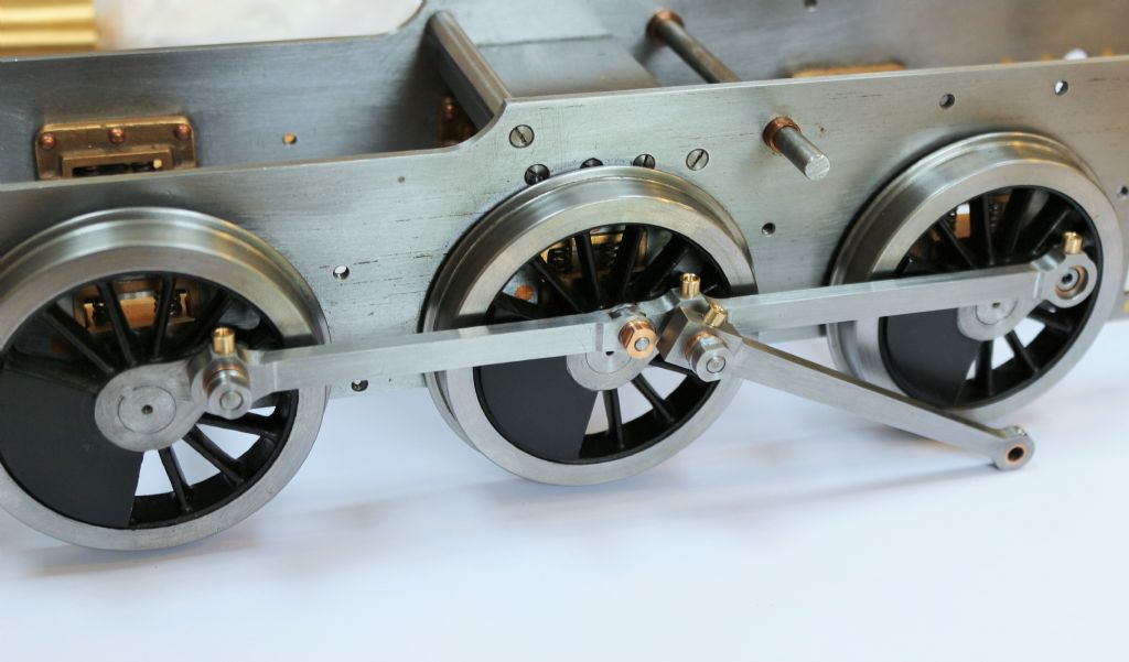

                            Next issue….As you can see, I am ready to make the bearings and intermediate coupling rod pin. The intermediate pin is turned from rod with a 45 degree (90 degree included angle) head to fit a countersink in the back of the rear section of the coupling rod. I will add a short section of 4BA thread at the front of the pin for a brass washer and 4BA nut. I am assuming that I need to machine the pin so that the washer and nut tighten up to a shoulder on the pin rather than 'pinching' the coupling rod. The same will happen on the trailing crankpin and driving pins. Is that the right approach and if it is – how much clearance – a couple of thou or should it be more?
                            Also, I was planning to fit plain hexagon nuts. Would round nuts with flats be closer to the real thing? I don't have any 2BA and 4BA nuts anyway, so turning a few round ones would not be an issue.
                            #497067
                            Baz
                              @baz89810
                              Phil H1 when you make your bushes make sure they protrude by about ten thou, this will stop the rods rubbing on the face of the wheel. Round nuts with a couple of flats will look much better than hex head nuts.

                                What about the other end – the nut end. How much clearance between the round nut and the coupling rod. The wheels can 'float' side to side. Do the coupling rods need to float also and if so about how much?
                                Phil H

                                      Phil, allow about ten thou slack between nut and rod, the wheels have to move sideways and up and down, front and rear coupling rod bushes should also be a bit slack, LBSC mentions this in a lot of his articles, not sure what Evans said on the matter but I think you should make them about.255 to fit a. 250 crankpin, the centre bush should be a nice running fit, this will enable wheelsets to move independently of each other. I am sure the experts will be along in a minute telling you I am wrong but it works for me.

                                        Thanks Baz,
                                        I've got about 0.005" extra length on the intermediate pin/ nut. but the tongue and slot is quite snug. I was going to allow about 0.005" on the coupling rods but I will now go for 0.010" as you suggest and about 0.010" extra at the back of the coupling rod to prevent rubbing the rods to the wheel hub. I might also double check the wheel hub run-out again to make sure.
                                        Mr Evans did mention a snug fit on the driver crankpin and mentions the need for movement on the leading and trailing pins but doesn't suggest an actual clearance.
                                        I did a few geometry sums and as you say, they must need at least 0.003" before metal to metal contact is made between the pins and bearings and that assumes that the quartering is perfect – so I think you might well be right at 0.005".
                                        I will wait a while before cutting metal just in case somebody comes with a 'yeah but'.

                                          Phil tongue and slot should be ok if it is snug, easier to make it snug in the beginning and ease it if it needs, best way to tell if it’s ok is to take the chassis down the club track, put a weight on it, housebrick might do and give it a push round the track, start off gently.
