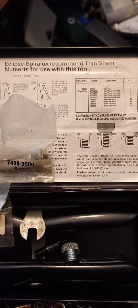

                        Robert Atkinson 2
                          @robertatkinson2
                          This tool was supplied to RS by Eclipse-Spiralux then Advel. I have one and they did sell M6 and M8 madrels and nosepieces for them. I have a full set. The largere sizes are easier to set than the M3 which is very easy to break.
                          See photo for some part numbers. The 7488-9500 number is Advel.
                          https://www.farnell.com/datasheets/884973.pdf
                          They seem to have been taken over by Zygology http://www.zygology.com

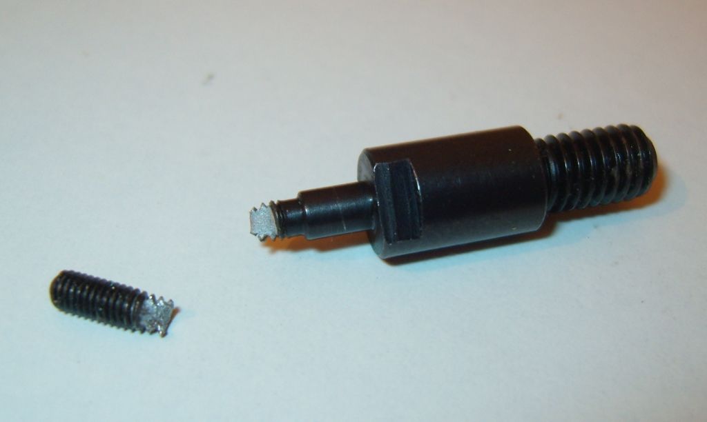

                                      Hi, I have two nut riveters, the first one I bought off ebay several years ago, which do 3, 4, 5 & 6mm nuts, but only aluminium ones. Several years ago I used it on a 3mm nut and had a senior moment, where I was expecting a snap, like you get with a pop rivet, and yes, that's exactly what happened.

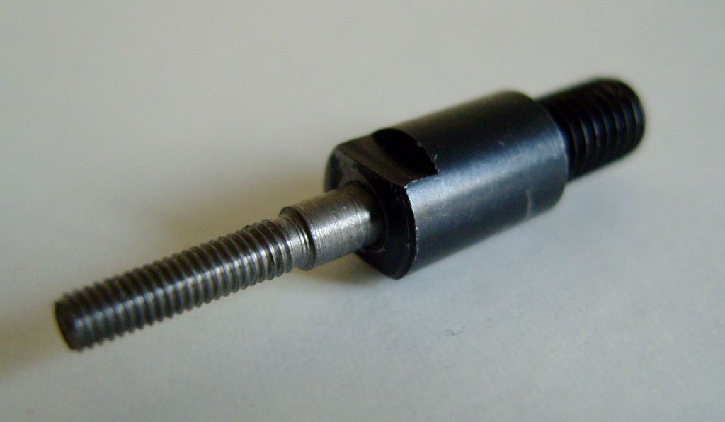

                                      Although I was rather annoyed with myself, I set the piece up in my collet chuck on my mini lathe, parted the broken piece of thread off and then drill and tapped it for a new piece of silver steel rod and thread-locked it in. Once set, the rod was cut to length and threaded.
                                      This worked was just as it did from new.

                                        Nice repair Nick. I hope I don’t have to do this but it’s good to know it can be done.
