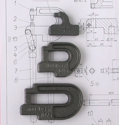

        #712893
          Polly Engineering do them complete and as a casting in 3 different sizes and Atelier do castings
          There was also a design in ME to make your own
          It would not be hard to substitute a bit of steel flat or plate in place of the castings.
          #712899
          DC31k
            @dc31k

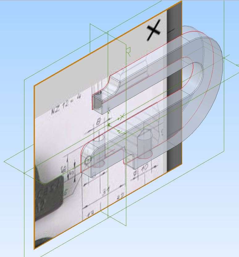

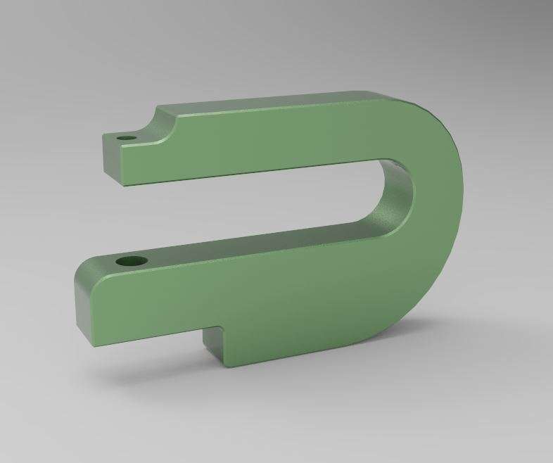

            The green bit could be drawn up on the computer and plasma cut from 10/12/15mm plate to save a lot of hand work.
            Maybe someone could find a photo and we could trace over it.
            It is a bit small, but has a good outline drawing (of the 45mm version) and written dimensions.
            http://www.ateliermb.ch/shops/gussteile/ch/contents/media/l_800320.jpg

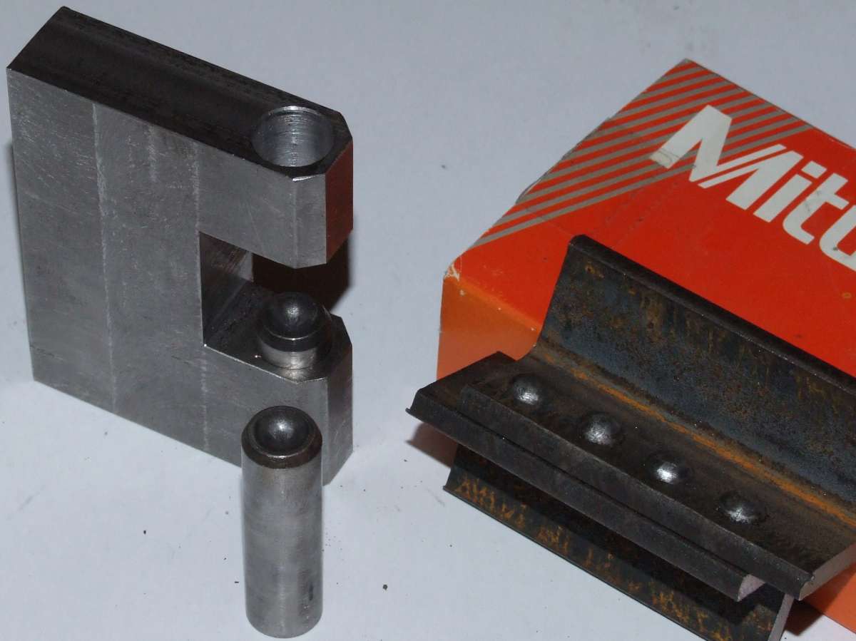

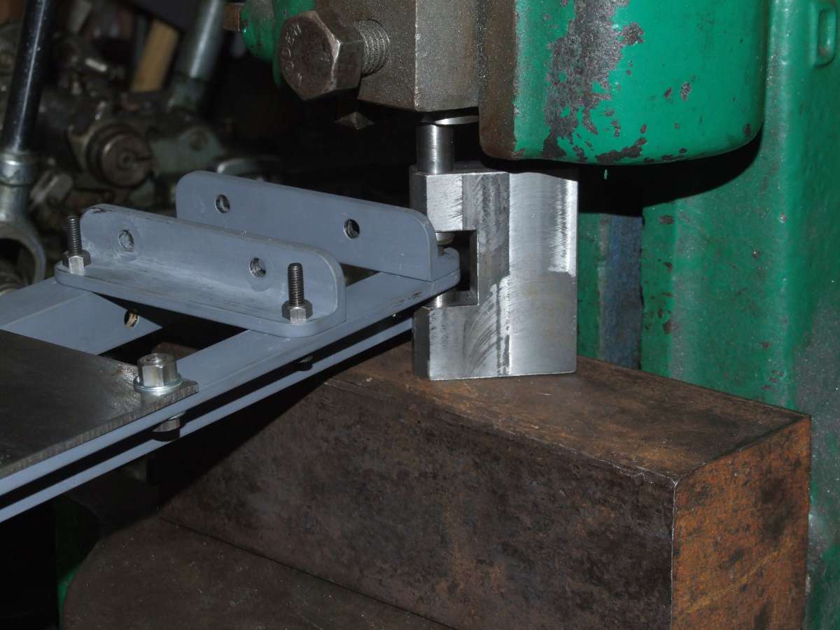

            Rivet tool
            #712905
            Anonymous
              Home made rivet snaps, and support, for 3/16″ steel rivets, plus test closures to determine length of rivet before closing:
              2023_10310069
              Setup for closing rivets using a #3 flypress, which is far more effective than an arbor press:
              2023_11180016
              Andrew

                #712945
                  On DC31k Said:
                  rivit 1
                  rivit 2

                    #712947
                      That’s the idea, Jason
                      … unfortunately the dimensions on your posted image are barely legible, but the proportions look fairly similar to mine.
                      #712951
                        They can be read on the Atelier link myself and DC31K posted
                        Or Here
                        #712969
                          Thanks, Jason
                          I hadn’t noticed that … I thought you had had traced over a photo of an aircraft one
                          … Must get more sleep before my brain shrivels any further !

                                  Now we have a computer model of it, maybe someone could do some stress analysis on the frame.
                                  In a way, the design is sub-optimal insofar as the large and medium versions only differ in width (throat depth).
                                  The force on the rivet will be the same but the bending of the frame will differ between sizes. With them both the same size, either the medium one is overbuilt or the larger one is underbuilt.
