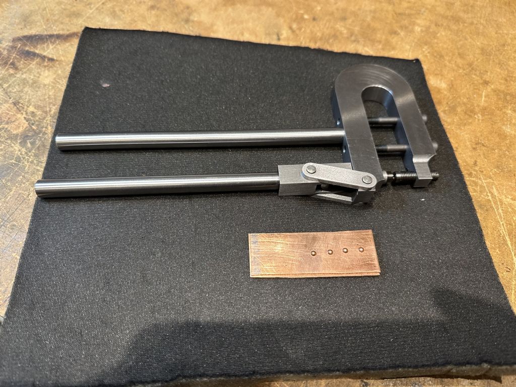

        Hello everyone.
        I am in the process of making a Rivet Squeezer to help me complete the riveting needed on the 1" Minnie I'm building.
        Based on 1/16" copper rivets, what is the best method to produce the dome within the rivet snap?
        Thanks

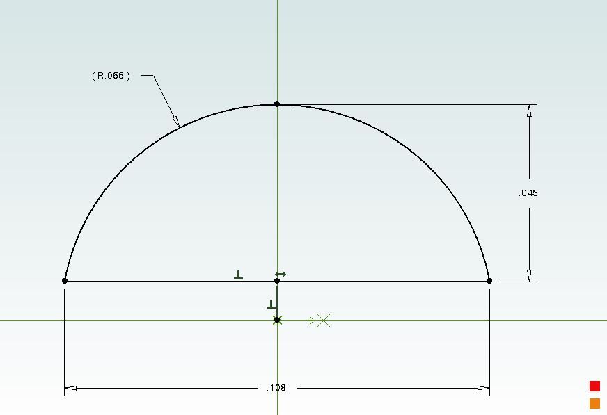

                    Jason, is there any science behind the 0.025 of is it just what worked?
                    #631144
                      There is and I have given you the wrong science, thought it sounded small when I typed itblush
                      The head radius should be 0.055 or 0.110" diameter to give a base of 1.75D so closest ball nose cutter is 3mm. depth should be 0.75D say 0.045". Sizes from Sapphire
                      Sizes do vary a bit particularly in the smaller sizes but that's a good starting point, and do a couple of tests as well as offering up a rivit head as you form the head with the ball nose cutter to judge what depth suits your rivits.

                        Brian Abbott
                          @brianabbott67793
                          Thank you
                          All done and seems to work ok.
                          Make a start now on riveting the Minnie.
                          #631216
                          Robert Butler
                            @robertbutler92161
                            Nicely made tool.

                              #631237
                                Looks a nice tool, it will be interesting to see how many of the Minnie rivits you can actually get to with it
