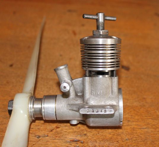

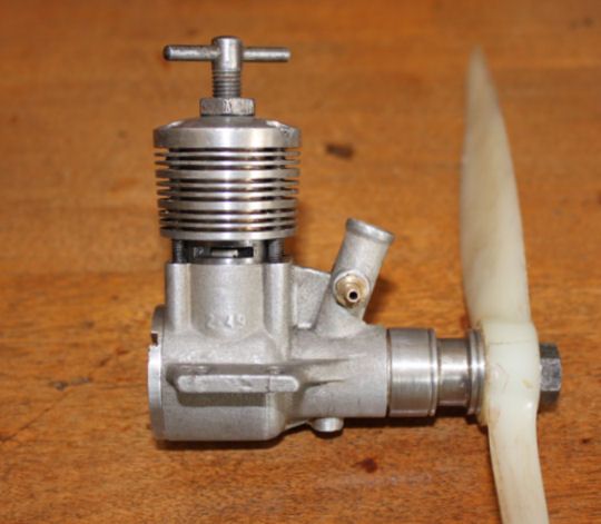

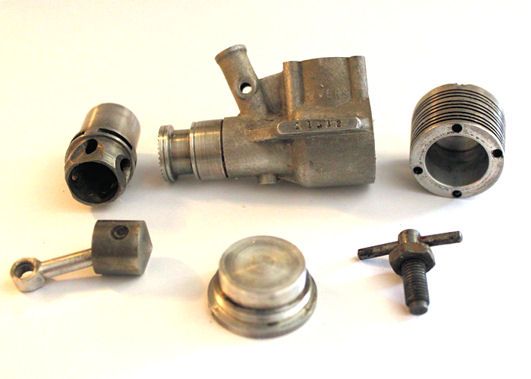

                Here are some of the River’s components after cleaning:
                Here are a couple of pictures of the Rivers, cleaned and re-assembled.  I’ve uploaded a few more for those who may be interested in these Vintage engines.

                  Nice work Terry, looks very clean and mean.
