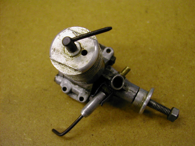

        Hi there,
        I have resurrected a couple of old engines from my distant past.  Both are diesel engines.  However after approx 35 yrs storage they are both seized.  I suspect the pistons are gummed up in the liners.
        My query is to those much more knowledgeable than me, is to ask if it is possible to release these by exposing the piston and liner than applying gentle heat to soften the gum holding them?  If not is there a suitable safe solvent I could use to soak them?
        Also some parts are missing from my DC (I think it’s a Spitfire) and I need some dimensions to make new ones and I was wondering if anyone has one of these so that I can get some information, dimensions etc?
        Any help would be gratefully accepted.

                    When the Rivers first brought out the Silver Streak in the sixties it was seen as something quite special and though it never quite managed it in the long term it posed a considerable threat to the dominance of the Oliver Tiger. That honour was left to the ETA 15D a couple of years later. Like against like the Rivers engines – 2.5 and the 3.5 – were outstanding examples of the model engine builders craft. Easy starters and superb handling characteristics. I can’t remember whether they produced a 1.5 – have a vague idea that it was talked about but not sure if mass production ever came to fruition – perhaps someone else knows.
                    On the DC the extra ‘two’ holes is unusual. DC used to fit a (one) small vertical pin screwed into the head as a stop to prevent over compression. This was about a 1/16 diameter and was positioned radially just short of the ‘tommy bar’ length. Normally only one hole was there as I recall but without seeing it if these are diagonally opposed I would guess this is incase the comp needs just that bit more than one position would allow. Many would remove this pin as it was rather a ‘nuisance’ compared to other engines. Unlike most other manufacturers DC compression screws on the smaller engines were frequently ‘one sided’ ie the tommy bar protruding from one side of the screw only.
                    The DC spraybar assemblies were virtually identical throughout the entire range – brass spray bar, ally threaded boss on the needle valve and a spring steel clamp to prevent rotation from vibration – not very effective on the smooth aluminium boss.
                    I don’t have an original but have made a copy for the Rapier so will take a couple of pics and some measurements for you tomorrow.

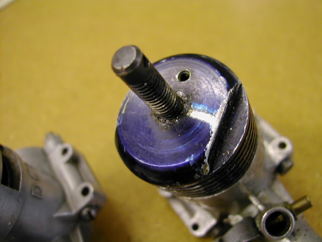

                          Re the two smaller threaded holes in the cyl head. They are diametrically opposed either side of the main compression screw.  I will post a pic later today when I return home from work.  They are the same diameter as 8ba but the thread appears to be coarser.  Would these be BSF or BSW threads?  I don’t want to keep trying various bolts etc in case I damage the threads.  I suppose that I could re thread them with metric but I don’t want to spoil the origiinality.
                          Cheers again
                          Terry
                          Edited By Terryd on 16/04/2010 09:19:38

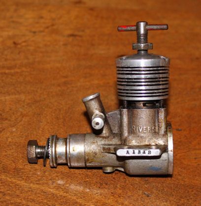

                              #50766
                              Terryd
                                @terryd72465

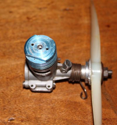

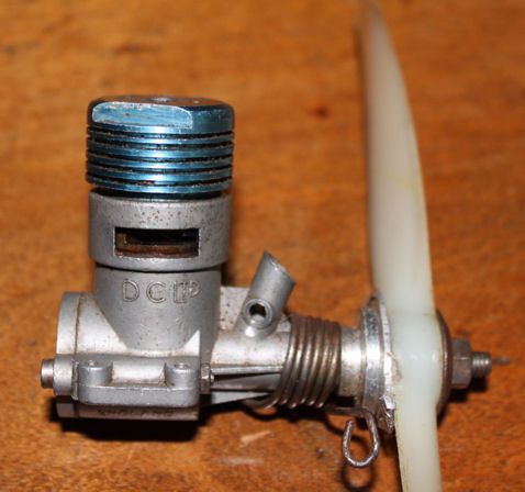

                                I’ve now created an album,  here are a couple of pictures from it, I hope!!

                                  Terry – those holes are for vertical pin stops for the contra piston screw to limit the range of adjustment. The Merlin had them (one?) too, but whether all DC engines did I don’t know.

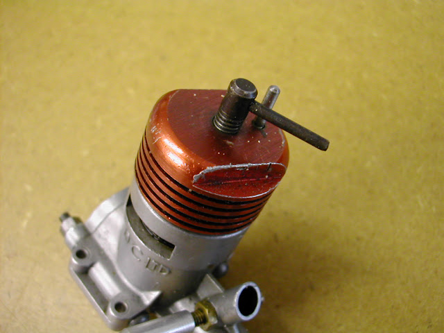

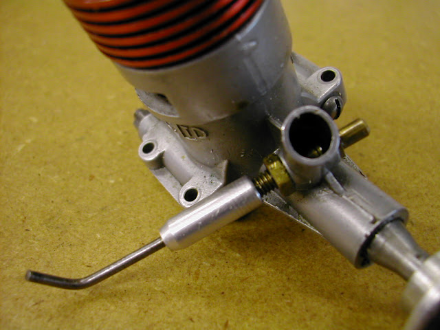

                                  #50769
                                  Ramon Wilson
                                    @ramonwilson3
                                    Hi Terry
                                    Lovely to see that Rivers – most envious (drooling now )

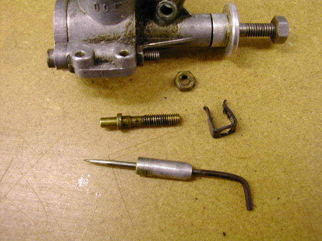

                                    Had a friend over today so got him to bring a couple of DC motors (Sabre 1.5 and a Spitfire).
                                    I think it fair to say that one of the two holes in yours has probably been put in after purchase. His two and a Merlin I forgot was still here all have one only. These are definitely threaded 8BA for the stop pin

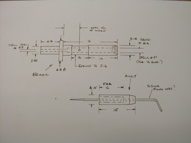

                                    The Needle valve assemblies are all identical – here are some pics of them and a drawing.
                                    My memory had ‘shortened’ the tommy bar as you can see it exceeds the head diameter
                                    Hope this will help to get yours up and running.
                                    Going back to the Rivers – you have a very low castor build up on the crankcase and I’m sure the Fairey Power Spray will bring that back like new. It’s not expensive and works really well. I have an OS silencer in similar state so I’ll do that shortly and you can see the results.
                                    Regards for now – Ramon

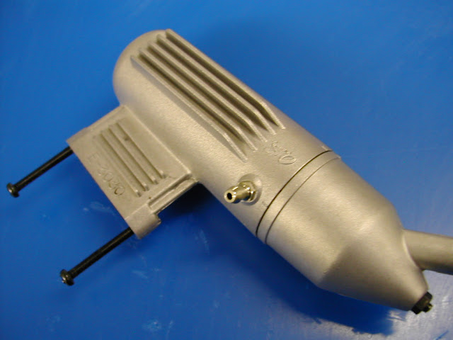

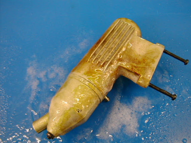

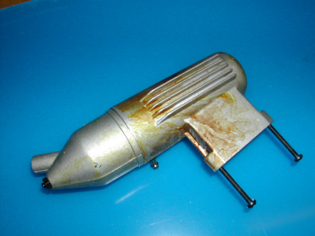

                                      Well I have just surprised myself.

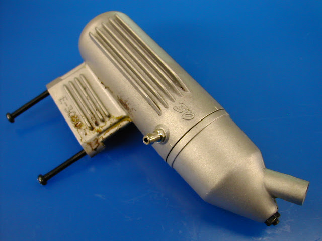

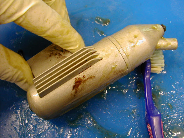

                                      Having had it highly recommended for this application for a while now it is only quite recently (fortnight or so) that I have actually bought some of this ‘Power Spray’.
                                      The pics below are of an OS silencer last used in 2006 – (How can I be sure of that ? Well the airframe it was fitted in met it’s demise after a pushrod failure and that was a week after the ’06 ‘Nationals’ – the last time I flew control line actively). Since then it’s been lofted along with all the other ‘stunt stuff’.
                                      I sprayed on this not unpleasant smelling product about 6.15. Within two mins the lighter stuff brushed off with a toothbrush. Just less than 30 mins and most of it brushed off leaving only the really hard baked stains. A rinse under the tap and most of the surface is near new without any apparent adverse effects to the ally. I have given it another coat and will check it every hour or so to see if it will eventually soften these hard patches.
                                      Before coating
                                      Well saturated covering
                                      After 2mins the end cleaned with a light brushing
                                      After 30 mins
                                      Washed off after 30 mins.
                                      This is much better than the ‘old boiling technique’ though it remains to be seen if a longer saturation time will eat into that baked on carbon.
                                      Does make your hands smell like a T——-ish boudoir though – even using gloves!
                                      Hope this of interest Terry
                                      Regards – Ramon
                                      Edited By Ramon Wilson on 16/04/2010 19:11:17

                                        #50787
                                        Ramon Wilson
                                          @ramonwilson3
                                          Hi Terry
                                          Thought you might like to see it after a four hour coating! I forgot to check it regularly!! This really is a very good product indeed. I will try to see if I can get hold of a really badly carboned up engine and see how well it does on that.
                                          Might pay to buy two bottles – bound to come off the market now it’s found to work!
                                          Regards –  Ramon

                                              Thanks for the pictures and drawing.  i just have a couple of queries.
                                              Is the taper on the needle crucial? and
                                              What size should the fuel hole in the spraybar be, it looks quite tiny on your drawing, is it to scale, sort of?
                                              Oh, I just thought of a third one! How should the fuel hole be positioned when the engine is assembled?

                                                Hi Terry,
                                                The taper on the needle isn’t usually that critical particularly on a sport engine like the Spitfire. I usually make needles from either 18 or16 swg piano wire grinding the taper by hand on the side of the wheel on the off hand grinder. Needs to be a fairly slow taper but not excessively so – only thing to keep in mind is to get it reasonably concentric. Silver steel would be a suitable alternative left in the soft state but of course could be easily bent.
                                                Big problem with using ally for the housing is that this needs to be a good fit on the needle (if it’s brass then a quick dash of solder sorts that out). Using a piece of the piano wire itself ground across at an acute angle as a reamer produces a good hole, and if you stone the diameter of the wire first you can produce a tight fit. To establish the position in the housing first put the housing on the spraybar and screw home then back off a turn. Measure from the engine to the end of the housing. Remove the housing and put the needle into the spray bar until it stops then mark the needle at the previous dimension. Pushing the needle into the housing (off the engine that is) to this mark will ensure the needle closes before the housing bottoms out. A smear of Loctite helps too.
                                                The hole in the spray bar is a # 65 drill. It goes right across and the accepted way is to have the holes set at right angles to the intake ie across the bore though it will work in virtually any position.
