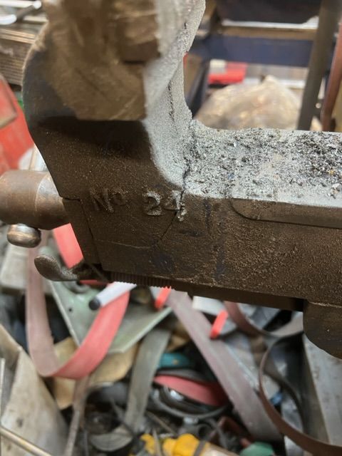

      Was squeezing a collar onto a lump of steel…guess it was too much of an interference fit..
      i will sadly mis this faithful servant perhaps i misused him one time to many

            Using a Vice as a press certainly counts as misuse in my eyes.
            Have I done it myself? Of course I have.

                      Must have been a wee bit dodgy anyway, it's usually the leadscrew nut that fails in these high pressure scenarios

                            Hi, the Record No. 21 to 25 are cast iron vices fitters' vices, I've seen a few of these getting busted in the same area in my working days, normally by people putting a piece of tube on the handle for extra leverage, and at least two were fairly new. The 112 that File Handle has, is one in the range of at least four sizes, and is an engineers' heavy duty one, and is guaranteed against breakage.

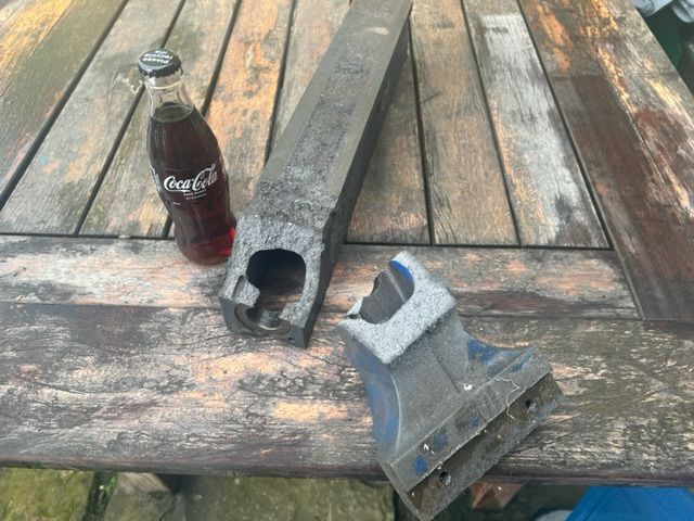

                                      This is the broken part I’m sure bolted and welded it would make a good vice for someone

                                        Hi, I did weld one up many years ago, but it's not an easy job, and is quite a dirty job grind the vees out, and of course there is a certain amount of distortion as well, so they don't always line back up totally correct. I wouldn't consider it worth the effort now.

                                            It may be possible to braze the two parts back together, for moderate use.
                                            I grew up with a vice that had suffered in exactly the same way, that my father had had brazed, and we used it (more carefully )for years, certainly until I left home.
                                            Welding would need the parts to be preheated and cooled slowly. Not impossible, but more difficult
