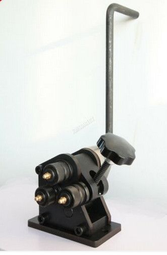

      A number of eBay vendors are selling ring rollers like this:
      They are branded differently, but clearly the same tool with minor variations.
      Some, but not all, vendors say the tool will produce rings from 1" diameter upwards but in the tech specs they all give a minimum bend radius of 7 cm.
      Can anyone advise as to the what the minimum radius actually is? To give an idea of scale, vendors seem to agree that the tool is 18 cm in height (excluding handle). Seems unlikely to me that the tightest ring it can it can do is 140mm diameter, but I have never used bending rolls so can't really judge.
      Robin.

          The minimum diameter will depend on the material you wish to bend. Working in a jobbing shop we rolled everything from Armour Plate a total pig to anything less than 5 times the roll diameter to soft brass that was 1.25 the roll diameter was quite easy to achieve.

            How can something with a minimum bend radius of 7cm produce a ring of 1” diameter ?

              That would depend on thickness of material, how far you can close up the rollers and roller diameter. One would hope they quote for same case but giving the smaller size will sell more tools.
              eg if rollers are 1" dia and will only close up to leave a 1/4" gap you could in theory roll 1/4" material to a 1" dia but 16" material could not be rolled as tight, some calculation would be needed to determine actual bend which I can't be bothered to do.

                Edit: __ My guess is that 7cm should read 7mm … and is a reference to the ‘bottom’ radius of the groove in the wheel.

                  Interestingly both RDG and Chronos sell these and throw a third anomoly into the works with a 3" ring diameter and 1" bend radius. may be worth contacting them.
                  I can also see that you would get different bends on round stock to flat as the ring groove cut into the rollers would affect what is possible so maybe they twist sizes quoted what sounds the best

                      One, at least quotes the diameter of the wheels as 7cm. One shows a pic of a 180 degree bend (of 7cm diameter inside diameter if flat bar) – but that would not be the minimum radius of a complete ring. So I expect their claims are about right in that a ring in max diameter (of material) is not possible at the roller diameter of 7cm. Thin stuff (not much thicker than we might term ‘wire&rsquo might be a different matter.

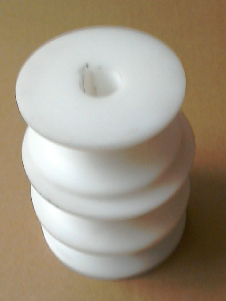

                          Probably a badly translated specification regarding inside diameter, outside diameter and centre line diameter. In reality what can be achieved depends on material spring back and physical size together with the size of the rollers and their relative positions. These given values will change if the rollers are replaced with something of different size. Does it come with interchangeable tolling to suit different material sections? If so the given sizes may be minimums for two different sets of tooling. Here are some rolls I made for aluminium tube.

                            I imagine you could roll the 70mm ring, but you wont get it out of the groove so less than half ring only.
                            The wheel must be just less than1" dia to slip a 1" ring off
                            #492007

                              Thanks for pointing out the Chronos offering Jason – I hadn't lit on that. Although not consistent with the eBay vendors I think it's possible that their specs can be cudgelled into internal consistency. They say that a 1" radius is "achievable" , so maybe 2" diameter is the best case scenario and 3" diameter a more typical limit. That seems more reasonable than the discrepancy between a 1" diameter and a 70mm radius
                              The descriptions of the various eBay offerings are very similar to each other – it looks like they are all copied from the same source, so it may be that there are translation errors in the source document. In fact, if one transposes radius and diameter, the eBay specs read 1" radius and 70mm diameter. Not so far off the Chronos specs.
                              A quick Google reveals that that the Chinese have one ideogram which represents range, scope, extent, limits, radius, and another that represents path, diameter, way. So anything might happen! Any Chinese speakers out there…?
                              On the basis of this perhaps specious reasoning I have ordered the SwitZer which MichaelG pointed out. I want to roll 1/8th CZ108 brass (not armour plate oddly enough) so I'm hoping I can get somewhere near 2.5" diameter.

                                Arrived today.
                                The Chronos spec is correct: 1" is the theoretical minimum radius (hence "achievable" I suppose) but 1,25- 1,5" more reasonable given spring. I think radius and diameter have been transposed in the eBay specs. So fine for my purpose – 7cm radius wouldn't have been tight enough.
