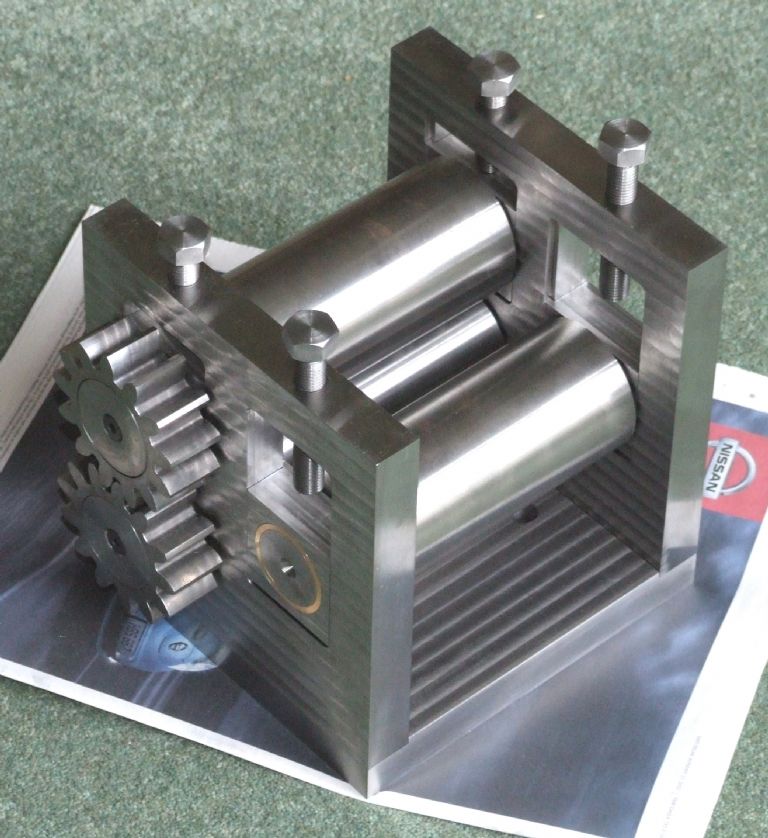

                    #97033
                    Anonymous
                      Posted by Stub Mandrel on 23/08/2012 21:54:24:
                      Plenty of people have made traction engine wheels using bending rolls, even bending the angle for them as well as plate for the outer.
                      Like this?
                      Andrew

                        #97038
                        S.D.L.
                          @s-d-l
                          Posted by Andrew Johnston on 24/08/2012 10:12:49:
                          Like this?
                          Andrew
                          They look intersting what thickness will they roll?

                            #97040
                              The usual way to keep rod in line when using rolls is to have " wire grooves" in them, look at a lot of old sets of rolls and you will see various sized grooves in the ends.
                              Andrew I will pick your brains about those rolls on Saturday, need to make some for my next traction engine.
                              J
                              #97046
                              Anonymous
                                I don't know what thickness the rolls will bend. They were designed to be used with 3" by 3/16" and 5-1/4" by 3/16". Time will tell if my calculations are correct. The design is essentially upside down, ie, the material bends downwards, rather than upwards. That makes the adjustment of the third roller much simpler. The rolls are designed to be bolted to the table of my horizontal mill, the wheel rims eventually forming around the rolls and table.
                                Jason: I'll stick the rolls in the back of the car and bring them down on Saturday.
                                Regards,
                                Andrew
                                Edit note: The original design had deep 1/4" grooves incorporated so that I could also form the T-piece rings. However, I ended up buying these as laser cut quarter circles to weld together, so the grooves were not needed.
                                Edited By Andrew Johnston on 24/08/2012 14:35:37
                                #97047
                                Gray62
                                  @gray62
                                  Hi Andrew,
                                  I was thinking of knocking something similar together to do the rims for my 3" Fowler B5. Do you have any drawings?
                                  What diameter are the rolls?
                                  cheers
                                  CB

                                      #97072
                                      Anonymous
                                        CB: Yes, I do have drawings. The whole thing was designed in Alibre, so I have 3D models of all parts, plus a 3D assembly. I also have 2D drawings of all parts, although they are only dimensioned sufficiently to allow me to make the parts. The design was based around material, and gear cutter, that I already had. The gears are 13 tooth, 5DP, 20ºPA. The geared rolls are 2.475" in diameter and the free roller is 2.5".
                                        If you want drawings PM me an email address.
                                        Regards,
                                        Andrew

                                                #97300
                                                Anonymous
                                                  I'd prefer to check out operation of the bending rolls before I publish drawings for all and sundry. Mind you, when that will happen is anybody's guess.
                                                  Personally I wouldn't have thought that the rolls would be suitable for MEW. After all, bending rolls are bending rolls, what else can one say!
                                                  Regards,
                                                  Andrew
