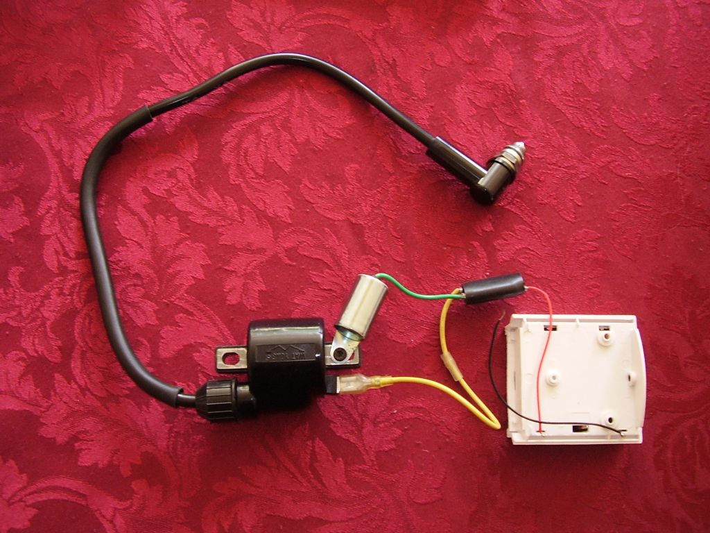

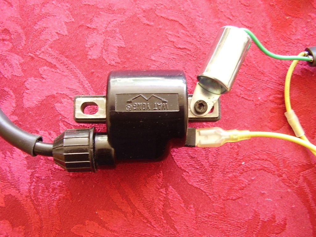

                                              #96090
                                              Norman Vant
                                                @normanvant32224
                                                Hello again,
                                                Back at last! Work and an unruly garden have impeded progress on the Rina greatly. However, some advances have been made and the beasty is ready (at leat mechanically) for a test run – not painted or properly mounted – but ready to try. I still think I need some advice from the sparks gurus, though.
                                                I have sourced some ignition components and the points are fitted to the engine. Unfortunately, there is no room there for the condenser. I am assuming that it amounts to the same thing if I connect said condenser across the coil LT terminals on the coil (they are only at the other end of the wires, after all!?!).
                                                If I can manage to add the pictures to this post you will see my attempt to test the system "in hand" so to speak. The coil is off a small Honda bike and the lugs either side are what I assume to be the mountings and earth terminal combined, since there is only one LT wire. These lugs are sort of laminated metal. Is my assumption about them being the earth correct? The white battery box contains 4 x AA Duracels.
                                                The reason for my doubts is that I only seem to get a rather weak spark at the plug and a much brighter one at the +ve terminal when I break the circuit by hand. That doesn't sound good.
                                                I'd like to get this sorted out off the motor so that I will know that it's one less reason for the thing not to run. I anyone can confirm that this set-up is correct -or tell me why it's no, I'd be very grateful.
                                                P.S. Jim, did you enjoy your trip to the UK and our apalling weather?
                                                Regards,
                                                Norman

                                                  #96092
                                                    The central bar is a common negative of both the primary and secondary coils, as the chassis of teh bike/car would be negative grouind you can say its the earth.
                                                    You may also find my recent Buzz coil thread of use.
                                                    J
                                                    #96093
                                                    Jeff Dayman
                                                      @jeffdayman43397
                                                      Hi Norman,
                                                      Good to hear from you again. A few comments re your setup in the pics.
                                                      1. The 4 AA batteries may not have enough current to operate it. I would start with a power supply able to supply at least 1 amp. Last year we discussed using wall wart power supplies with at least 1 amp rating at 12 VDC.
                                                      2. The plug wire and cap look like the suppressor type which have high internal resistance.The wire may also be a resistor type. Both these items will increase the need for higher drive current. If you can, substitute copper core plug wire, plain metal plug cap terminal and a non resistor plug (ie like a Champion CJ-8 for example) and try the circuit again. Before attempting to remove the plug wire from the coil, pull back the rubber boot and look for mould flash or sealant around the wire. If there is none, chances are the wire is screwed in onto a terminal which is just like a wood screw, down in the coil socket. The screw is intended to make contact with the plug wire core. At least that was the way these coild used to be connected to the wires. Some however used sealant or were moulded in place and these wires can not be removed without damaging the coil, so use caution. As I said if there is no mould flash or sealant, the wire can probably be screwed out easily.
                                                      Before altering anything though I would try driving the circuit as-is with more current.
                                                      Good luck JD
