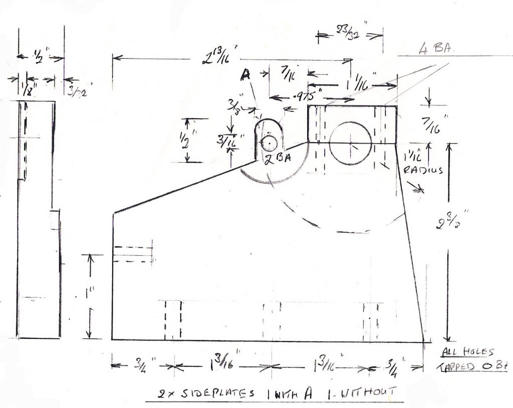

      In the latest issue you have asked for comments on the drawings that acompany these two items, a few points I have spotted:
      Rena Fig1. There seems to be some inconsistancy with the decimal “fractions” some are given to only two decimal places eg 2.28, one assumes this is 2 9/32 which should really be 2.281. Some are rounded down and some rounded up eg 3.345 assume 3 11/32 so 3.3438 but as you seem to be rounding to the nearest 0.0005 then 3.344 would seem right. Again 2.155 assume 2 5/32 would expect 2.156. I have no issue with printing to the nearest 0.0005″ as this is what most peoples digital callipers/mics etc will read to but can it be consistant.
      On both models there are radiused corners and edges, no radius is given. I know this is not a critical part of the model but would be nice to have.
      Again on Rena the two side plates Fig 2 &3 are drawn to different sizes, this is possibly to keep column widths the same but I would personnaly like to see the parts to teh same “scale” even if there is a bit more air around them.
      Apart from that they are fine to follow but a beginner may be trying to mark out to the odd 0.001″ or so accuracy rather than 1/32nd increments.

          Numbers are not rounded up or down but are as drawn.
          Four decimal places looks stupid on say a 16.0000 dimension.
          I redrew it from the pencil original and most of the dimensions were originall fractional but not all of them.
          The drawings were all drawn to scale and must have got altered in size during the production process.
          regards David
             David I agree that the 000 can be left off the end but if the original sketches were in fractions why draw it 2.28 when the decimal equivalent to 2 9/32 is 2.281 or was this originally a decimal.
            I can see why some of the dims were originally given as decimal, the gear ctrs and the setting out of the PCD being two examples.

              9/32 is not on the original drawing.
              2.28 is the way it worked out after redrawing.
              Click on drawing to enlarge.
              It more likely came from the .975 gear centres and was a compromise so that the radius between the gear pillar and the edge of the bearing cap was a standard size, 2.28 – 2.155 = 1/8 rad or 1/4 diameter cutter. If the average reader tried to use the original drawing, half the dimensions are missing.
              This is a typical example of drawings received.

                Now that the ubiquitous digicalips have fraction sizes as a “Feature” on some of them David, it stands to reason that it may be advantageous to leave all the “Old” (or new for that matter) dimensions in fractional sizes?? The Metric and twentyseven decimal places brigade can fiddle to their hearts content.

                  I had to redraw it so it is decimal not fractional.
                  I also have to make sure it fits together.
                  regards david
                  #49692
                    Thanks for the clarification David, I can see that the 7/16″ and half the bearing cap width dont add upto the gear centres and you have done the best you can with what you were given

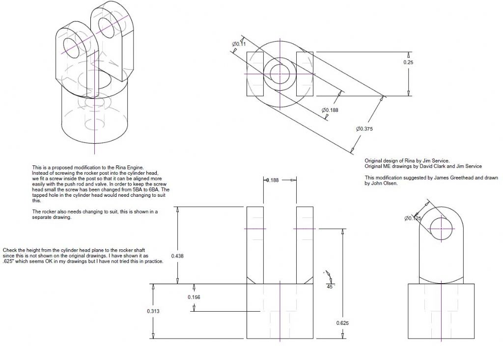

                                          Those building this engine might find the pictures I have just posted in my album of interest. I have “built” a 3D model of all the parts presented in the articles, and assembled them into a virtual model. That allows me to easily produce general arrangement drawings in either standard projections or Isometric. I have converted a few examples into jpg and uploaded them.

                                            What a great job you have made of the drawings John, and so quick! I note that in another posting, you have advocated the use of 3D over 2D because one can easily generate 2D drawings from the 3D. Maybe I need to go back to Tech next year to do the 3D extension to the 2D course I did this year. One never stops learning.
                                            Elsewhere, I mentioned that in converting Rina to metric, I have made some changes. Two of these relate to the valve train and to my  aversion to tightening threads to achieve a specific orientation. They are:
                                            Fixing the Cam Mounting Shaft (Fig 17) with a capscrew from the inside of the frame. There is room to do this and it means that Fig 17 can be correctly oriented and the screw also correctly tightened.
                                            At the other end the Rocker Bearing Mount incorporates one of the head bolts. The same considerations in regard to bolt tension and mount orientation apply. I propose a separate bit like a right angle bracket attached under the push bar mounting on the head, and providing a separate mounting for the Rocker Bearing Mount. The head bolt is then separate and can be tensioned correctly.
                                            Your comments on these changes would be appreciated. They could save me reworking these elements when I get into the project (which should be early next year)
                                            Jim

                                              Hi James, You can get the Alibre CAD programm as a months free trial download, so you can have quite a good play with it before committing yourself. There is a certain learning curve involved in getting familar with the package, but I am finding it pretty good now, after a couple of months.Once you have made a 3D model, it will automaticaly generate standard projections and isometric views, all you have to do is tidy up the dimensions which are not usually in the best places.
                                              I think your changes make good sense. Now, as I understand things,  the valve rocker post on the head end does not actually go right through into the cylinder fins, it is only screwed into the head itself. There are four other screws that hold the head to the cylinder.  That means of course that we could play with the location of this one if it made things easier. I will have a look at what can be done.

                                                OK, I have had a quick look and there are now two more drawings showing a possible  mod for the cylinder head rocker post. The rocker also needs a mod to suit this. What we do is make the post a bit bigger, with a bigger slot in the top, so we can screw it down with a screw through the middle. I have assumed a screw with a 3/16 inch head. I think I have shown the hole 6BA tapping size, it should of course be clearance, and would be tapped into the head, not right through into the cylinder. To allow for the wider slot in the top of the valve rocker, I have put two bosses on each side of the rocker, this would also give a better bearing surface here.
                                                When I get home later I will refine these a bit, and see how it looks in the assembly.
                                                Time to do these drawings was half an hour. Note they need a little tidying up still, I see one of the dimensions is on the actual part, which is not good practice.

                                                  OK, I have been out, come back, and edited things a bit more. I have changed the hole in my post to suit a 6 BA screw, this would also require changing the tapped hole in the cylinder head to suit 6 BA. Actually my own choice would probably be a small cap screw, I have these in 2.6mm or 3mm. The latter might need the head reducing in diameter a whisker to fit. Although the cap head might be an anachronism for this type of engine, it would hardly show, being under the rocker.
                                                  I have replaced the drawings in my album with the updated ones, and have included acknowlegement of the original designer (Jim Service)  in them, along with some notes.
                                                  The intention of this modification is to make it easier to align the rocker with the pushrod and valve. Instead of screwing the post itself into a tapped hole in the head, we fit a small screw down the middle of the post. To allow enough room for the screw head, the slot has to be a little wider, and this requires adding bosses to the rocker.  I think this still ends up looking in keeping with the style of the engine.
                                                  Please note that this modification has not been tested, and in particular the height from the cylinder head plane to the rocker shaft was not given in the original drawings. So please check this on the job before making this part.
                                                  A similar modification may be done to the pivot for the governor latchout lever by bringing a small screw through from the inside of the frame.
                                                  regards

                                                    Your solution is much better than mine John, simpler and more elegant. Thanks.
                                                    I note that you have omitted the fuel tank arrangements and the muffler which were also omitted from the original drawings. I wonder if Jim Service could be persuaded to offer some suggestions for these items.
