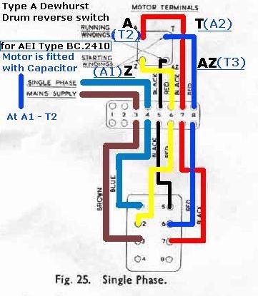

                  Hi Norman,
                  In motor terminal box.
                  Remove yellow wire from U1
                  Remove wire from capacitor that is connected to U2
                  Connect U1 from switch to U1 on motor.
                  Connect U2 from switch to U2 on motor.
                  Connect Z1 from switch to the yellow wire which was removed from U1
                  Connect Z2 from switch to wire from capacitor that was removed from U2
                  Connect mains neutral to N1 on switch.
                  Connect mains live to L1 on switch.
                  If the reversing switch works the wrong way round swap over the connections Z1 and Z2
                  so Z1 goes to capacitor and Z2 goes to yellow wire.
                  UNLESS YOU ARE SURE that the two unused terminals are not connected to anything else then use choc block to connect the two removed wires to Z1/.Z2 from the switch.

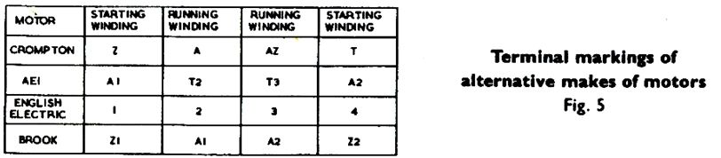

                                              Hi Alan
                                              Just posted these which may help the switch looks not dissimilar to a dewhurts switch attached which i've motor cable colour coded to help
                                              Which should co-inside with this for motor
                                              Hope this helps
                                              Barry
