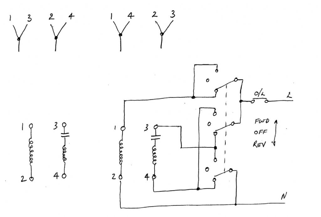

      i am at the start of putting a reversing switch on my mill using a DPDT switch. (so i can reverse taps e.c.t)
      the diagram goes like this
      am i right in thinking that this should reverse an AC motor or will it still run in the same direction- because i know most motors have capacitors on them but don’t know if this affects the direction

          Hi James ,
          what type of motor do you have ?
          your circuit will only work if used to reverse the connections to the armature or field winding of a universal motor , as in a mains power black and decker type of drill
          or reverse the connections to the main or start winding of a single phase
          capacitor start , ac motor

              a diagram would be appreciated john-its a 4pole induction motor if this helps

                Your switch wiring will work perfectly for a DC motor but will not work for an AC motor.
                You need to ID the type of AC motor you have to be able to figure out how to phase shift the field  to reverse the motor.
                If it is a shaded pole AC motor it will be difficult or impossible to do this, as these motors have a heavy copper shunt winding that influences the direction, which is built onto the stator lamination pack.
                If it is a common general purpose AC motor for washing machines etc. which reverses the field by altering connections in the wiring box, a simple drum switch will be able to reverse it. The key is to find an AC motor with a wiring box and 4 to 6 connections in it.

                          its not a silly question
                          i need i reverse it because in the future i am going to us it as a tapping machine and for other things that require reversing
                          by the way its single phase.

                                    john swift 1
                                      @johnswift1
                                      Hi James ,
                                      does this diagram help with the wiring ?
                                      as I understand tapping machines have two counter rotating drives
                                      when you pull down on the handle
                                      one clutch is engauged to drive the tap in
                                      when you release the downward presure the drive stops
                                      letting the handle up engauges  the reverse drive to remove the tap

                                        thanks for the diagram john, it makes sense now  , i might still use this method if i cant afford a tapping head. but at the moment the the tapping clutch sounds sensible.
