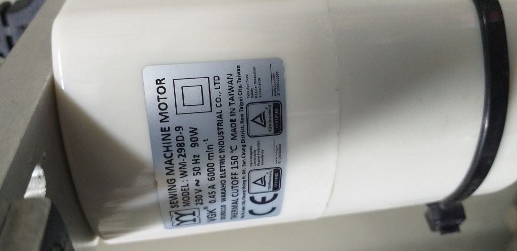

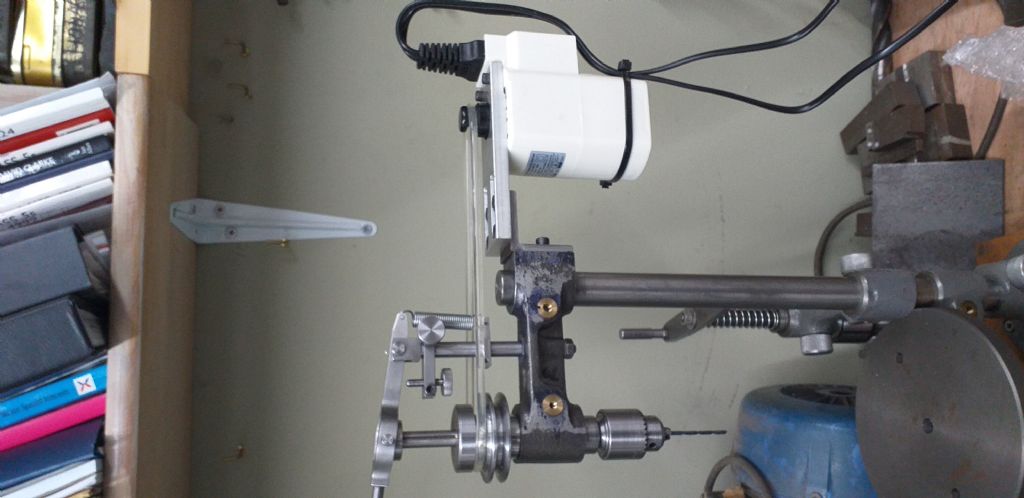

              Buffer
                @buffer
                Michael It does say in the book about using sewing machine motors.
                Ega here you go

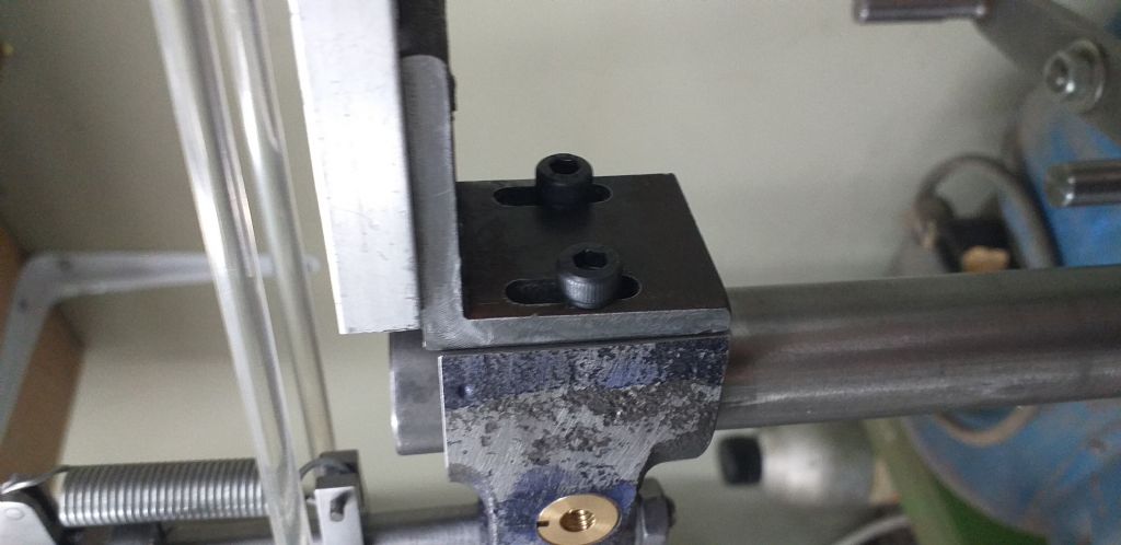

                  Buffer
                    @buffer
                    If you put it underneath you need this one
                    **LINK**

                      Buffer:
                      Thanks for the very clear photos; I think GHT would have approved!
                      With this approach, direction of rotation seems to depend upon which way up the motor is fixed. Another development would be that suggested by Hopper above.
