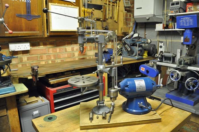

                      These guys supply 120W motors that run in a clockwise direction **LINK**. I use one to drive a milling spindle
                      My solution to driving the pillar tool drill was a cheap grinder with the stones removed
                      Now I have my tool post milling spindle I may well transfer the sewing machine motor to the Pillar tool for a more compact set up
                      Stay well,
                      Rod

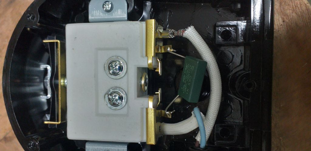

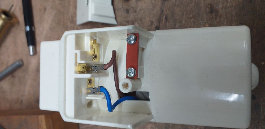

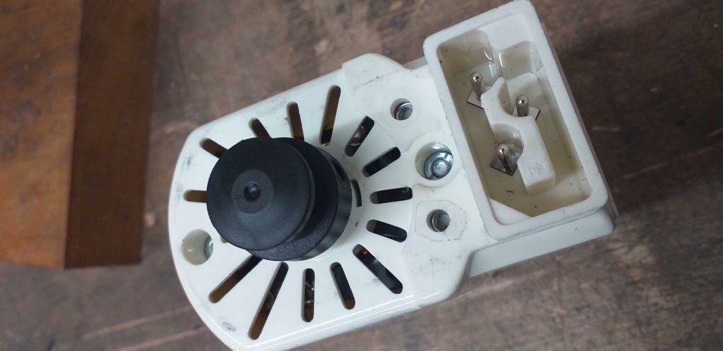

                            Hi
                            I have just finished a George Thomas Pillar Tool and like a complete idiot I never gave a moments notice to the direction of the motor until I found my drill going backwards that is! After much swearing I have looked online to try and find out how to reverse it. I have seen that it can be done and it seems to be the case that just moving one connection will do it. My question is does anyone know if its done in the foot switch or in the motor? I did try swapping the blue and brown under the motor cover and no surprise it didn't do it.
                            So if there's anyone or a few of you who find this stuff easy I would really appreciate the advice.
                            Thanks
                            These are the two wires that go to the motor however it is connected to the foot switch by a 3 pin plug.
                            20201204_095811.jpgInside the foot switch showing the brown and blue that go up to the motor.
                            Edited By Buffer on 04/12/2020 10:25:00

                              Hi Buffer – to reverse that motor you'll need to do it inside the motor – and you probably won't be able to get at the connections inside without destroying the motor, as everything seem to be moulded in – been there and gave up when I realised what I'd need to do! If you can access the brushes there is a good chance that you'll find that they are offset to favour the running direction so they won't be at all happy if you do manage to reverse the motor. Sewing machine motors of that type are generally built for single direction rotation and are sold as being set for clockwise or anti-clockwise rotation. Y
                              Your options would seem to be buy another motor that goes the way you want or re-jig the motor mountings so that you get the rotation that you need on the spindle. If you mount the motor slightly skewed then you can just use a crossed drive belt to get the rotation direction that you want. That would also give you the option of bi-directional rotation if you ever need it.
                              Don't believe everything that see on the internet, I think older motors CAN be dismantled and reversed but the newer ones are made using modern techniques and materials to keep the price down. Reverse on a sewing machine is a mechanical operation to keep the timing right through the needle shuttle interaction, rather than just driving the whole machine backwards.
                              Edited By Keith Long on 04/12/2020 11:03:44
                              Edited By Keith Long on 04/12/2020 11:04:57

                                If you can open the motor it should be possible to reverse it. The mains is fed to one end of each field winding. the other end of each field winding is connected to one of the brush holders. To reverse it you need to swap over the connections between the field windings and brushes. This will probably involve extending the wires from the field windings to reach the opposite brush holder. It is possible that there are also small RF chokes and capacitors fitted inside the motor to reduce interference. If this is the case you will probably have to post pictures of the inside of the motor so we can tell you if this has any bearing on the way you swap over the connections.
                                Les.

                                    Thanks guys. I have just phoned up the supplier Beds sewing and knitting and they have a reverse direction motor same type for an extra tenner, I'm picking it up on the school run.
                                    Regards
