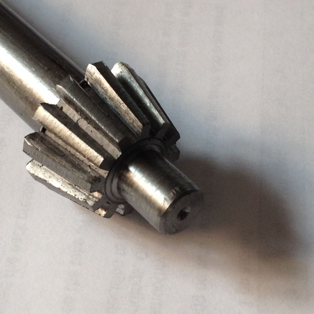

      I would like to try to cut a gear like this:

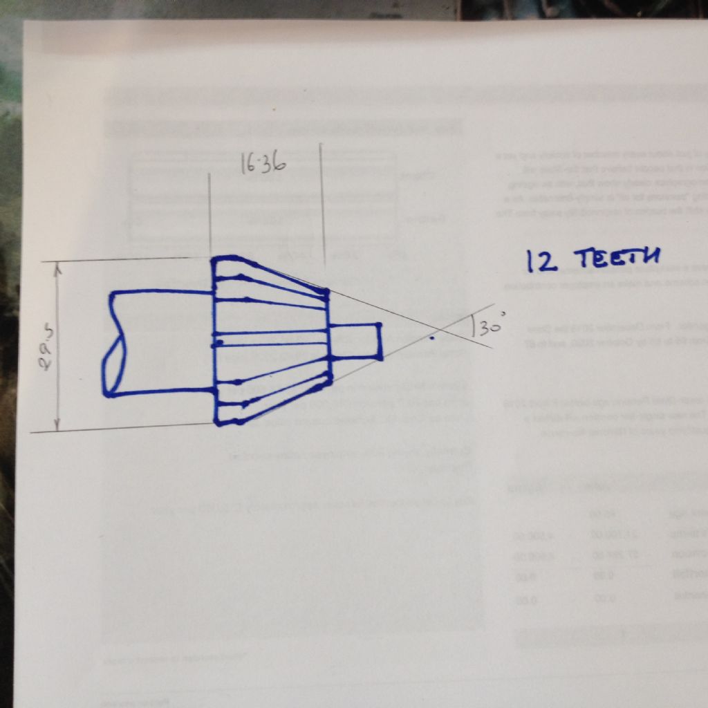

      It is a chuck key for a 'MultiSize' Collet chuck. Working through the various books on gears I can't find a way to identify the properties of this gear from scratch. The dimensions are:
      Without knowing the pressure angle, tooth form or modulus I am in the dark as to how to find a cutter! I know I could grind a single point cutter 'by eye' but i would like to try to work out the properties as a learning exercise. Any suggestions gratefully received.

                      I think that the secret is the number of teeth (11/13?). I found an obscure chuck key this way in some modern catalogue in a builders merchants in the Yorkshire Dale !! I suspect the web might have a wider choice.

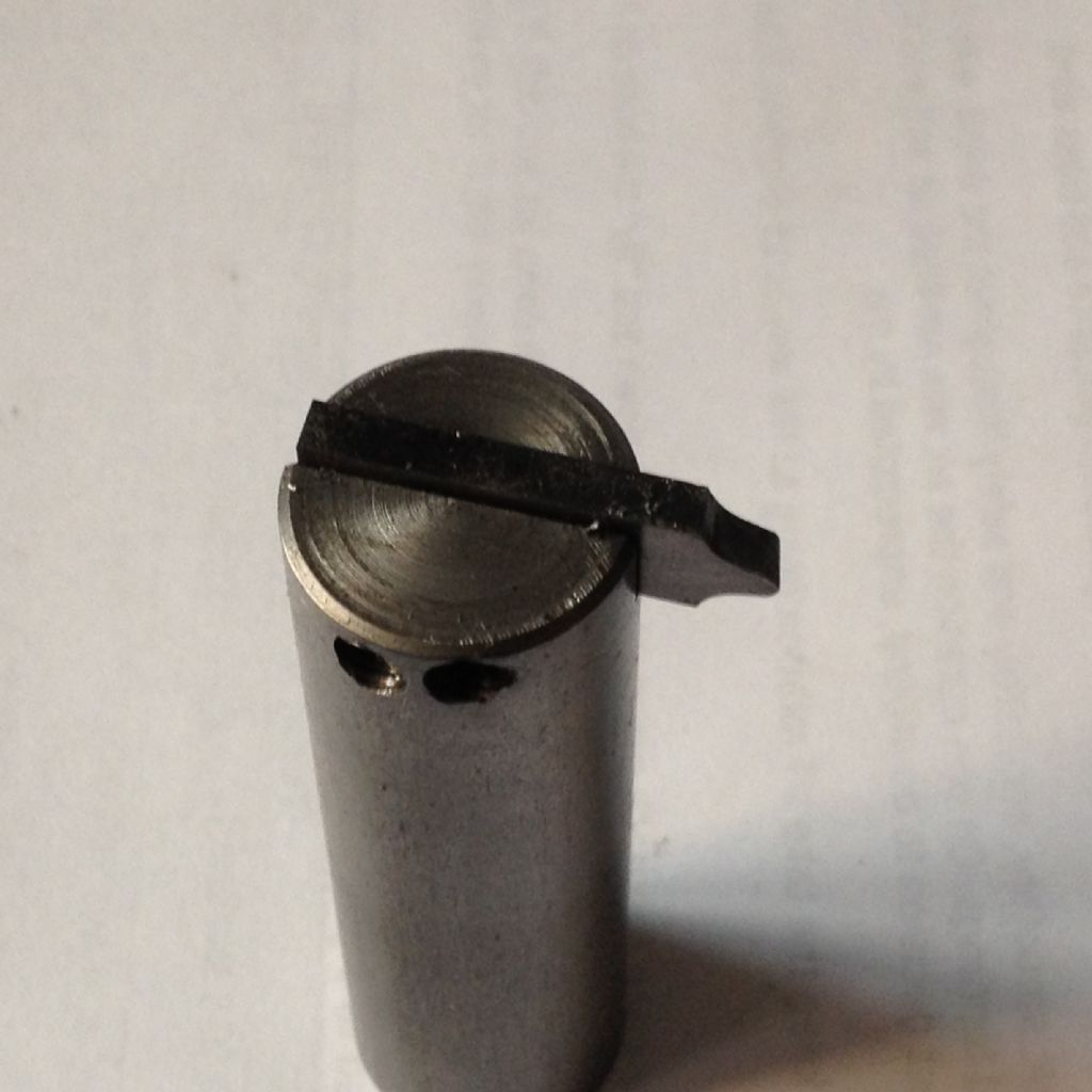

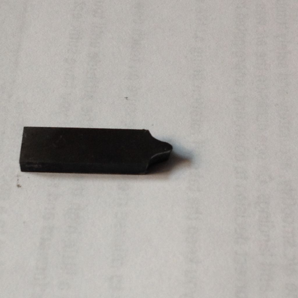

                                  Success! Thanks for the ideas. All credit to John Stevenson for his idea of modifying Ivan Law's method of making gear cutters using tapered milling cutters. I picked up a carbide tapered cutter from JB tools which worked very well.
                                  Here is the cutter, dimensions obtained by repeated trying of different milling cutter sizes and distance apart. This was tried by eye up against the teeth of the pattern gear. I settled on using an 8mm with 6mm between centres to leave a 2mm stub. I drilled an 8mm hole in a piece of scrap and marked the tapered cutter where it touched the edges of this hole. I then repeated the cutting process on gauge plate with the tapered cutter set to the height to form cutting edges. The gauge plate was hardened and tempered. The cutter was held in a slot cut in round bar so that the cutter face was on the centre of the bar.

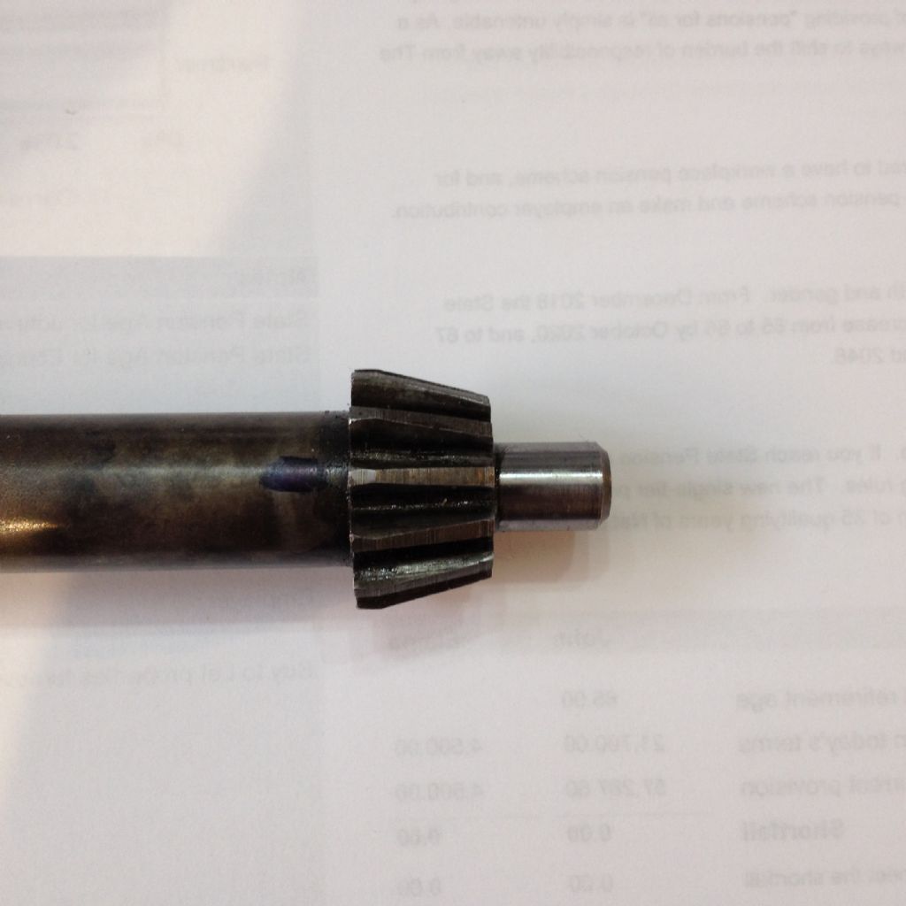

                                  The blank was cut with the taper set on the topslide. I cut this from one piece of bar, bored and loctited this this to the shaft. The dividing head was offset to the angle of the base of the teeth. I hogged out the bulk of the teeth with a 3mm slitting saw, then set the cutter to centre height and made several passes to get to depth. Thanks to 'gear cutting for the Shay' by Patrick Ackermann on uTube for a demo of cutting bevel gears.
                                  The result: 2016-10-10 14.31.41.jpg
                                  And it works!
