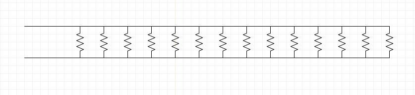

          Hi CT,
          If you only use half the strip length, you will only need half the voltage !
          Using a closer spacing might overheat the glass locally.
          You could use half on each window and put the elements in series and use 12 volts.

                Probably a strip of parallel resistors (heating elements). LED lamp strips use the same idea. They work at 12V however much is cut off, only the current drops,
                Not like old-fashioned xmas tree lamps where each bulb failure puts more volts on the others until they all go pop.

                        Hi CT,
                        Looking at the instructions with the kit contents in your LINK I think you will require two more of the vertical strips if you are going to fit out to two windows. My guess is they make contact with only two of the three strips at each end.
                        I note one spade connector is up and on the other side is pointing down so you end up with three lengths of triple wire tape forming the circuit.
                        I guess you should see if Holden will supply you with two extra vertical strips to let you use your spare element strip on a second window and then wire the two assemblies in series to avoid the chances of overheating.
                        HTH
                        Bob D
                        #500634
                        peak4
                          @peak4
                          From what I can see, if it's half the length of recommended, you will end up with twice the current for obvious reasons, as mentioned above, one way would be to follow the instructions , but wire the two windows in series.
                          Assuming your concern relates to width rather than height, that is a shorter heating strip drawing too much current;
                          I think I'd approach it differently, at least investigating an alternative method; the kits seem to have 0v on one vertical rail and +12v on the other, so one connector each side of the window.
                          I'd look at running both wires to the same side and split one connector bar in half. Stick that to one side, and the full length one to the other.
                          Use half the heating elements at the top and the other half to the bottom of the split connector bar, and all commoned together at the other end on the full length bar.
                          That way, you effectively have two smaller windows wired in series on each side.

                                This is what I was thinking of per side
                                |~~~~~~~~~~~~~~~~~~~~~~~| two half length strips on the right
                                |~~~~~~~~~~~~~~~~~~~~~~~| one full length on the left.
                                |~~~~~~~~~~~~~~~~~~~~~~~| Same plan for the opposite side
                                |~~~~~~~~~~~~~~~~~~~~~~~| which would save having the
                                |                                            +12v   two windows in series.
                                |                                              0v
                                It would effectively double the heater length per window.
                                Bill

                                    Which would double the heat output on each window !

                                      It's not quite like the drawing nor modern heated windows, the power zig zags so one window is a single resistor not several in parallel. The ends must have breaks in them.

                                        Bill, these windows are only half the size of the window that these heaters are intended for, so if you use all the elements in one kit for each window you will have all the applied heat in less than half the area.
                                        Using your scheme you would need to apply half the rated voltage on each window which putting them in series will achieve.
                                        Electrically one end of one window element would be connected to the frame/body/chasis and the other end linked to one end of the other window element, the other end of that element would be supplied with 12 volts via a fuse and a switch.
