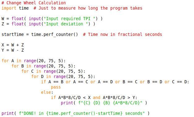

                                      Here for comparison with BASIC is Mike Ayrton's change wheel program in Python3
                                      On my machine, for 26tpi, it runs in 0.07309572899976047 seconds.
                                      Mike's version ran in 15 seconds and Ian's in 2 or 3 seconds. For a singleton user, both are perfectly acceptable. It wouldn't matter if it took the computer a minute or two. BASIC is fit for purpose.
                                      But what if the same calculation is done on a website serving several thousand users? How many users can be satisfied by each version in a minute?
                                      • Mike: 4
                                      • Ian: 30
                                      • Dave: 820
                                      And my version can serve up to 13 users in under a second so they don't realise there's a delay at all. The same 13 users wait between 15 and 195 seconds to get an answer from Mike. Most online users start twitching if they have to wait for more than a few seconds, and because most servers can only queue a limit number of requests, they drop users to avoid overloading – they never get an answer.

                                          Posted by Kiwi Bloke on 08/12/2020 10:48:05:
                                          …You didn't respond to my assertion that, for 'our kind of application' at least, a suitable BASIC might do the job in far fewer lines of code than something more 'proper'. We're talking quick and dirty, not a bank's financial system, after all.
                                          It's a fair cop guv! Although the source code of a simple program written in 'C' and BASIC are similar, C has substantial overheads. Apart from being low-level and harder to learn, the compiler is but one part of a complicated tool-set. There's an editor, preprocessor, type-strict compiler, and a linker to stitch user code, system code and libraries together. All these tools have multiple options, and there are yet more tools to address large project issues. For example, the 'make' utility understands which files needed to build a project, and is able to determine the minimum number that need to be recompiled when changes are made. So, it's not necessary to recompile the whole of Windows 10 every time a small change is tested. This is vital when a few thousand programmers are working on a project consisting of thousands of intertwined modules. In the same way, tools exist allowing multiple versions of code bases to exist in parallel, so past, current and future versions can coexist during development. One team will be bug fixing maintenance versions, another enhancing the current version, and a third working on the next. Careful management is needed to avoid chaos.
                                          Much of this is unnecessary overhead on singleton projects! BASIC was one of the early attempts to bring computing to the people, and I think the most successful. But, especially in the early versions, the programmer is insulated from the machine. As always tools are fit for purpose provided they do what's needed. My main objection to BASIC is it's limitations, which don't matter until they bite! Python has considerable advantages over BASIC:  to anyone wanting to learn programming, or tackle more advanced work, it's gold.
                                          No computer language is perfect, and – so far – attempts to produce a good all rounder have failed. Ada is probably the closest, but it's not popular for several reasons. The road to hell is paved with good intentions!

                                                Well there any many versions of BASIC. SOD said " Compared with C, BASIC takes up more memory, runs slowly and has weak system programming features." and Bazyle said " Basic is interpreted.." Neitherof these is strictly true. For starters there any complied BASICs. I use one, PBP3 (Pic Basic Pro 3.)This as you might expect runs on a PIC. I'm no programmer but have used PBP for hobby and commercial applications. I once wrote PBP code to drive a prototype machine that had two DC motors, a stepper and a serial interface. Fitted easily into a 8 bit 2K PIC 16F. So with prototyping done it was handed to the "proper" programmers some ime later they came back asking for more memory! They were using a C compiler costing a lot more than PBP bu, amonst other issues, were not accessing the hardware features of the chip. Were I'd used a internal UART They were bit banging the serial! Long story short the production units used my code.
                                                It is also not fair to compare languages for the change wheel program unless they were all run on the same hardware. Python on a RPi4 will be faster than Basic on a 4MHz PIC!
                                                As others have said Horsees for courses.
                                                Do look at PBP3 though, there is a free verson for hobbyists and you are not tied to specific hardware (the free version only works with a limited, but useful selection of PICs) http://www.pbp3.com
