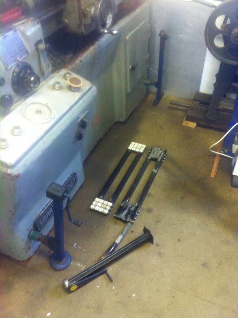

                    If you have a sufficiently strong base rail simple rods laid rail fashion in the direction you want to slide it will do for moving. Could drop it down by using the adjustable feet if you dont mind resetting afterwards.
                    I made a set of heavy duty versions of the inexpensive furniture moving roller sets to move my Smart & Brown 1024 out when I need to get round the back. Basically 1" square speed welded side by side into a frame with the ends cut away to hold lots of rollers.
                    Lighty modified car jacks fit into scaffold poles passed through the lifting holes to raise it. Can't get at the tailstock rear corner so a I fixed a long jack made for a Rover SD1 to the cabinet and left that scaffold pole in place. Welded a nut on the end of the screw to turn it as the standard handle couldn't be reached.
                    I be unsurprised to find that one of the better furniture / washing machine moving sets were up to handling Boxford weight.
                    Clive

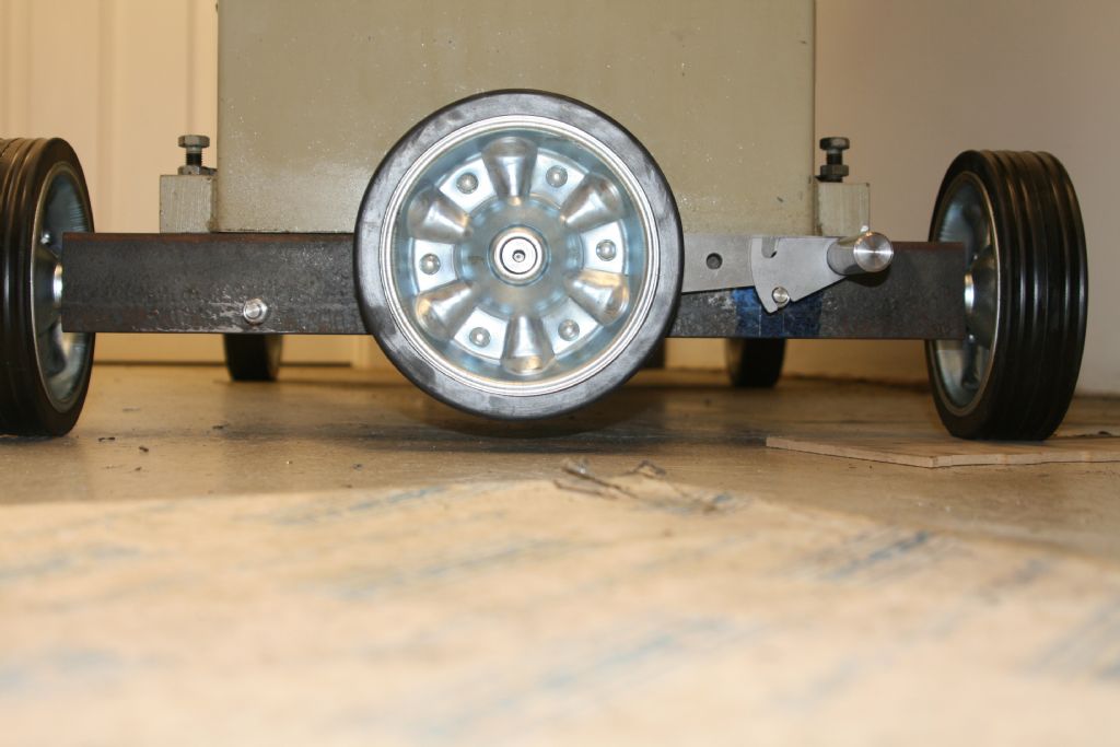

                      This was my solution, albeit, because I already had the brackets and wheels; ex of a coms cabinet.
                      Myford on Wheels
                      There's a couple more photos in the album.
                      I also have a Boxford shaper mounted on another set.
                      Bill

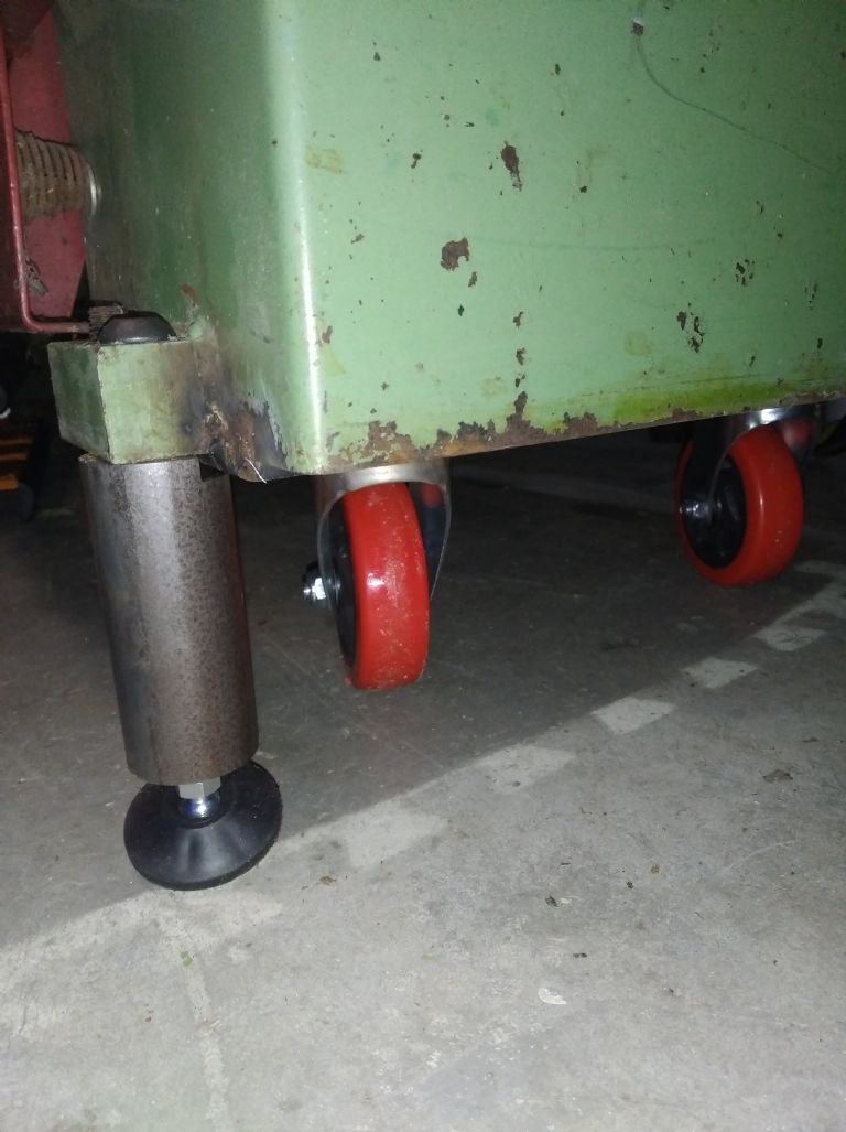

                        I just added some wheels to my new Boxford 11.30, I do it to all my machines as it makes it possible for 1 person to easily move them, and adjust the height.
                        Boxford cabinets benefit from being made from thick steel plate, I welded a 6mm steel plate in each corner with holes tapped to screw some castors to, and drilled and tapped some 40mm en1a I had laying around for the actual feet where it sits permanently, using the original strengthened area for the feet makes sure it's solid, and the wind down m12 feet also double as a means to level the lathe.
                        Boxford 11.30 feet

                            Whatever method you choose the lathe basically has to be lifted. Either onto the wheels/roller/rails or off them using jack up legs as its normal support.
                            If the lathe is already in the corner the devilish detail is how to get it out so you can apply your chosen method to that corner.
                            In my case I had enough clearance between the tailstock end of the lathe cabinet to tilt the 1024 enough to slide some 1/4" or 1/2" diameter rods underneath aligned across the bed. I used a farm jack, the click-click-click climb up a vertical rail thing, to raise the headstock end. As I recall it I got a rod to within about a foot of the tailstock end. By using the rods as combination rollers and rails I got it out far enough to work on that back corner.
                            I suspect that if you choose to use a system like mine it will be possible to tilt a Boxford on its cabinet far enough that one roller frame will get far enough down to the tailstock end to achieve balance with the headstock end supported on the other one.
                            Not a method I'd use more than once tho'. I've done similar in another case and it was all a bit precarious untill dropped back onto the roller frames.
                            If you decide to follow Bills suggestion with jack up castors make sure the jacking system is nice and solid.
                            I have a large set with the wheels welded to a square vertical tube which runs inside another tube fixed to the thing to be moved. A big screw with a tommy bar head moves it up and down. Wheels are 6" diameter, load capcity is high, pushing a ton each according to the specification and they cost the firm a fair bit of money. In practice the relatively loose fit of the tube in a tube means they don't actually work very well at the moving thing. I hauled them out of the scrap bin thinking they couldn't be That bad. With a ton of Pratt & Whitney sat on 8 I found they were worse actually! The slop in the tubes meant they really didn't want to swing around as castors should. Turning meant crowbarring up to take the weight of each castor in succession and lining them up by hand!
                            Clive

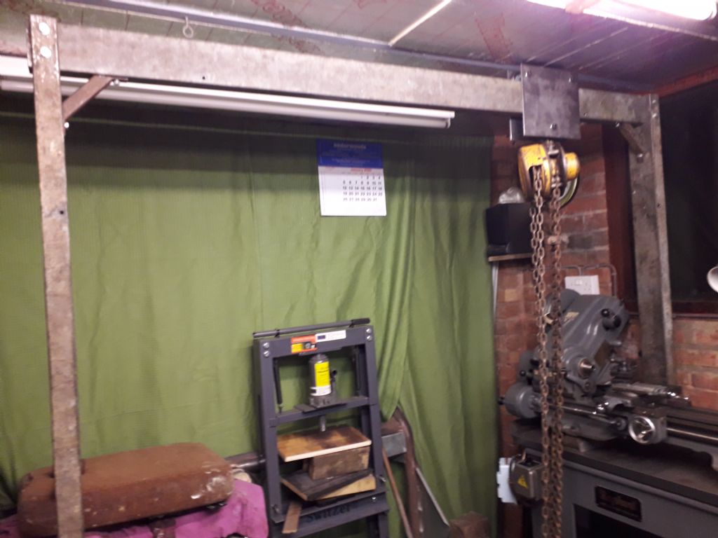

                                  I did it a slightly different way! I used some scrap as they couldn't be certified for insurance 2 tonne pallet racking joists and made an over head gantry to lift the new 500kg lathe into place after the Myford had come out. I leave the gantry in place and remove the rear leg, shown on the left hand in the picture, that is stored by the other one behind the lathe, the free end is roped to the roof joist through the loop above. I made the trolly out of 4mm plate with 50mm roller bearings as wheels.

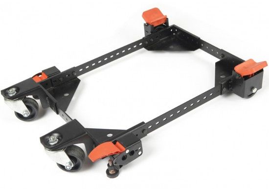

                                    I used one of those trolley affairs from Warco to mount a very heavy victorian printing press on. Your lathe might be a bit heavier but I'm sure that the trolley would take more weight. Moving it isn't easy but is at least possible.

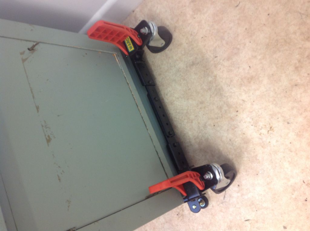

                                        Might be worth noting that the cheap set of Powerfix furniture mover rollers I got from LiDL (mainly to get the lifting handle thingy which is much cleaner in the house than pry bar) are rated at 150 kg / 330 lb so two sets should manage the Boxford OK.
                                        Quick Google showed LiDL did two types. The one I got had the 4 square puck things with multiple rollers underneath. There was a heavy duty 300 kg / 660 lb capacity version with larger L shaped bases and three lots of more substantial rollers (or maybe castors). A bit taller but still significantly lower than the plate on castors furniture dolly. I imagine the same things under other brands can be found quite easily or E-Bay /Facebook marketplace may turn up a used set or two for £ very reasonable. £10 (ish) new I think.
