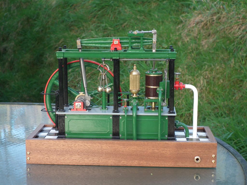

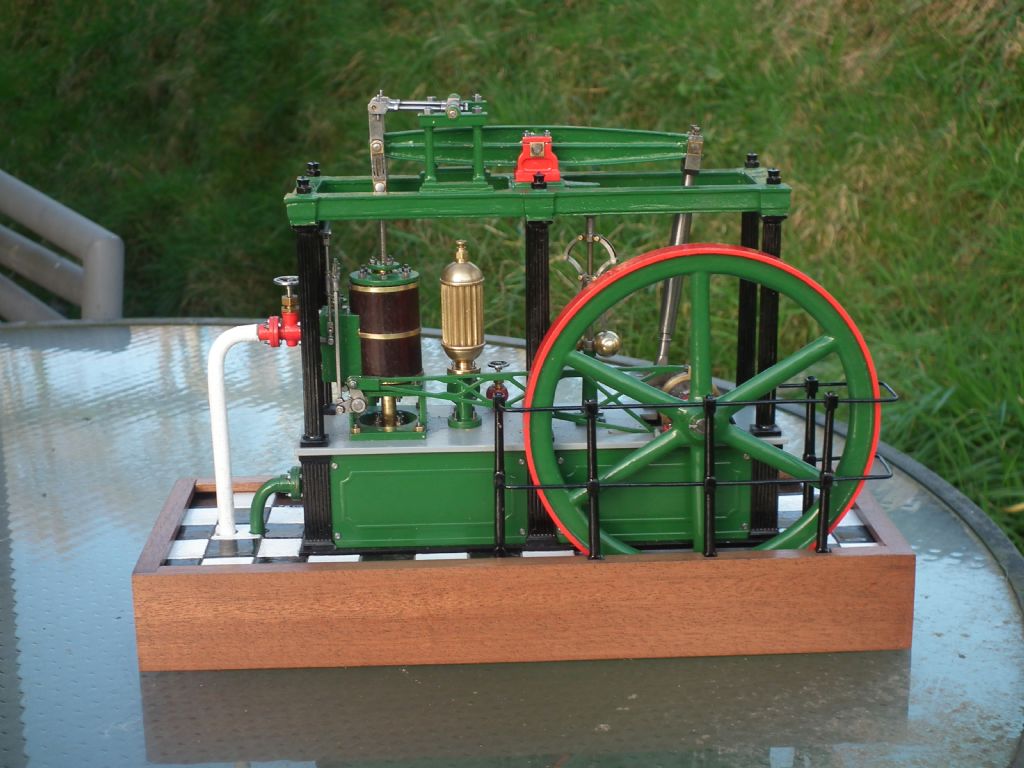

                          #586629
                          Bob Unitt 1
                            @bobunitt1
                            Here's the finished and painted Lady Stephanie, complete with plinth:-
                            I have some video of it running (.mov files) but can't upload them to my Albums. Does anyone know of somewhere that would host them so I could link to them here ?
