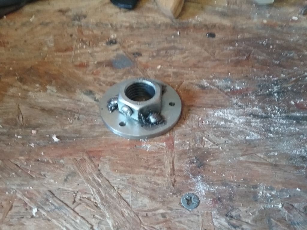

        Driving flange, I took a 60mm washer and bored it to24mm, then bored a m22 nut to 20mm and machine a 24mm lip on the end , it was a good interference fit and I pressed the 2 parts together, checked it was true and then spot welded in place, the locking screws are m5 cheese head but I will replace them with hex head grub screws.

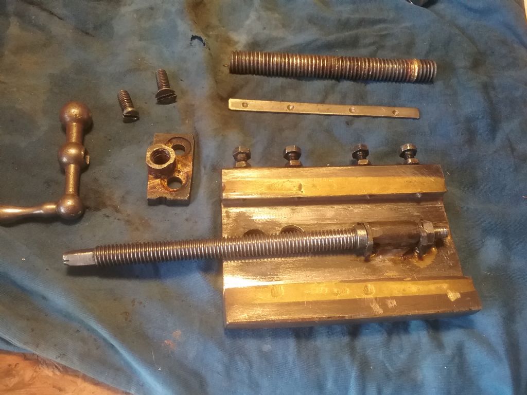

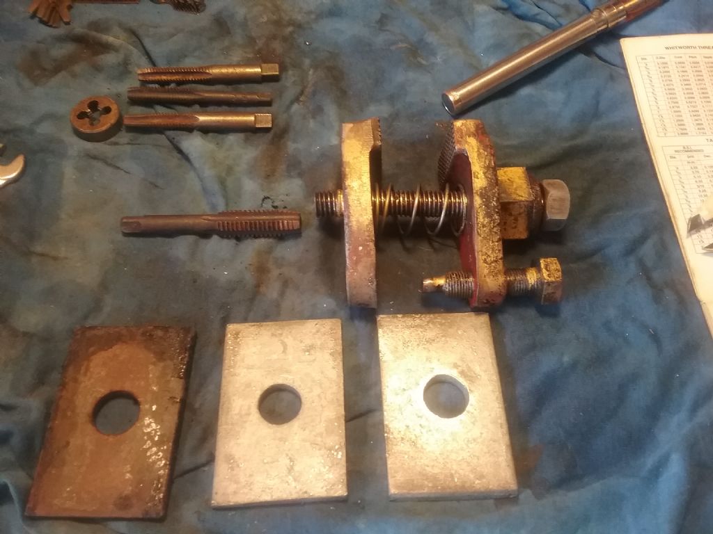

                  Here is the tool post after cleaning in the ultra sonic, all a bit basic but it does work, to my surprise I have a set of 3/8 Whitworth taps and dies which is the size of the cross slide feed screw, main thread of the tool post is a piece of 1/2 whit studding.20170815_173457.jpg

                          homemade, was probably more acurate when first made, dont like the feed screw arrangement as the thread winds out as you pull the tool away from the job, alot. cleaned it all in the ultrasonic and parrafin, adjusted up free play between screw and cross slide, coated all mating surfaces with moly grease, and to my surprise i was able to adjust the jib screws to give fairly free movement without any play.

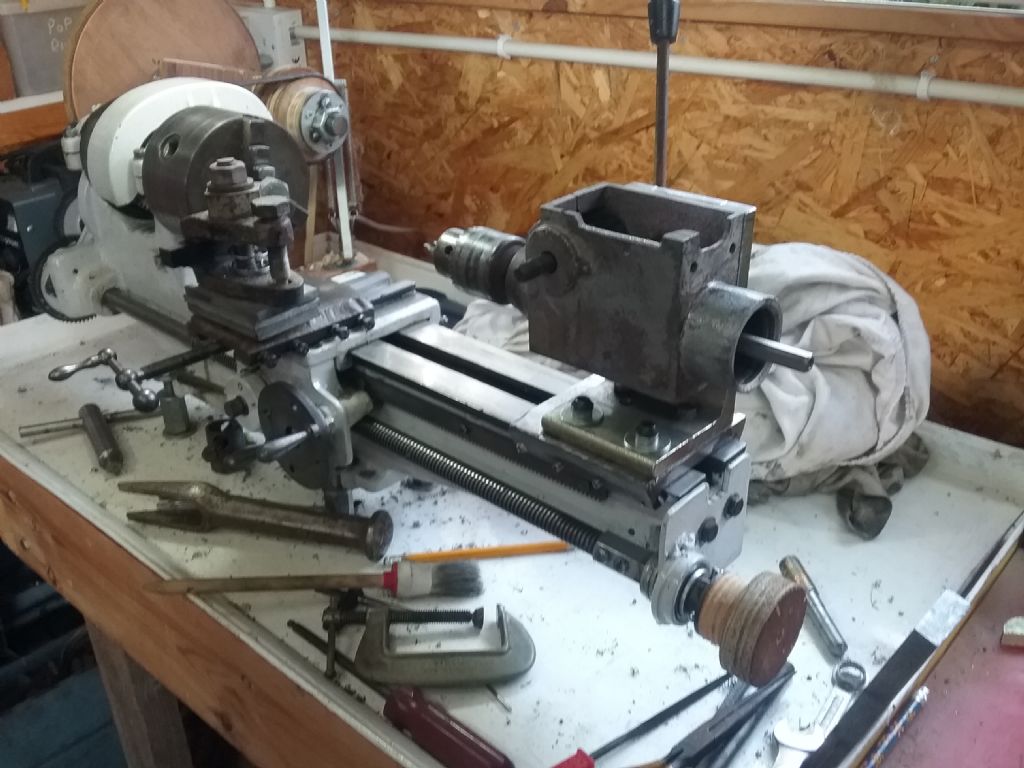

                              after a long pause i am back on he renovation, a tail stock.

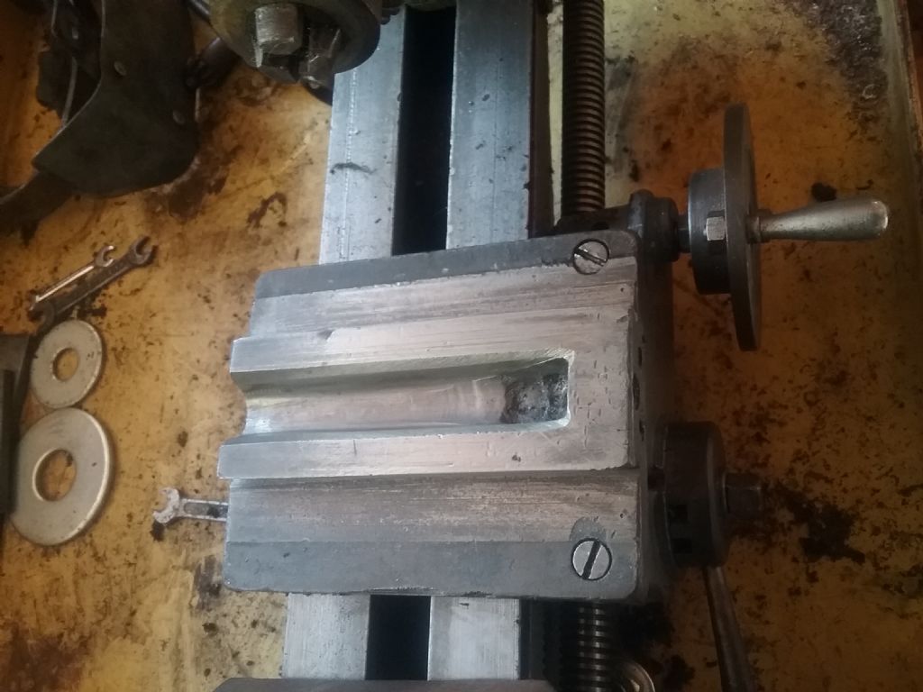

                              in the toolbox which came with the lathe was what i believe to be possibly a part made and abandoned project for a cross slide, just rough metal with the dovetails welded on and jib strap screws put in at various angles, it had also twisted in the welding and brasing, after much fileing and time on the disc sander i now have some thing usable, although not pretty, with the mild steel jibstraps fitted and adjusted it runs up and down the bed with very little slack, my bed has a very severe wear in the centre could be upto 0.2 or 0.3 mm, but seeing the tailstock runs at the end of the bed this should not be a problem. so that is just the foot, the other part will be the headstock from a wickes bench drill cut in half, the bracket to hold this to the foot is a 12mm thick tow bar angle bracket. sorry for the lack of pictures they will follow in a day or so.

                                    they were both very coarse and rough, the black metal shows this. if i had been been making iti would have trued flattened and squared the metal prior to starting assembly, where this was made out of rough bar stock.

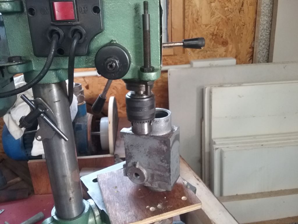

                                        this shows whitch bit of the casting i used,,, although you had probably guessed

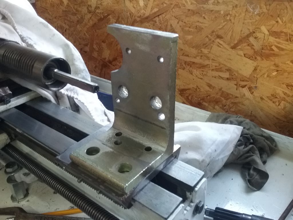

                                          foot and bracket, you can see the holes for the tow ball bolts. the assembly bolts are m6 but the hole in the bracket are 8mm to allow alignment, the same is true of the bols holding the casting to the bracket.20180925_084458.jpg

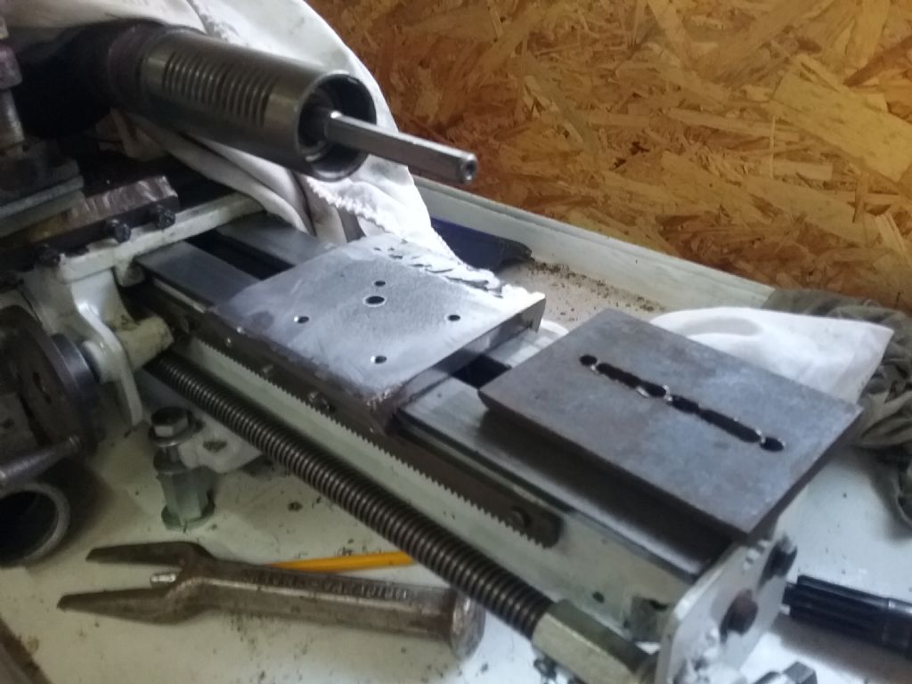

                                              also in the previous shot you can see the repair to the lead screw bearing. the corner of the casting was broken off. a repair hd been effected but the leadscrew was too high causing the bed to bind . i the leadscrew was too short, so i made an extension to allow for the ball race and the knob, the long nut is the coupling piece. whilst the knob looks rubbish the grip is good even with greasey fingers. the lathe is mounted on 25mm spacers ,s o when you drop something inside the bed it falls out of the bottom. must profile the end plate on the bed so the tailstock can be slid off the end.

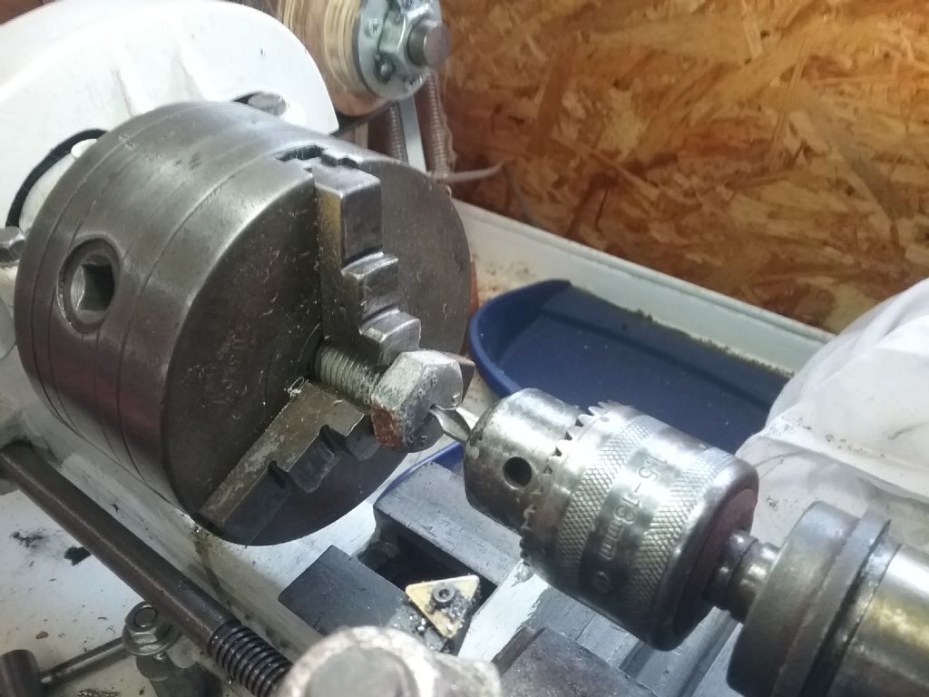

                                                  here it is working,,, not finished, but it drilled a hole in the centre of the bolt smiley,the shaft is free to spin at present so has to be locked to drill, but if i turn a centre point then unlocked it is a live centre. more when i have time
