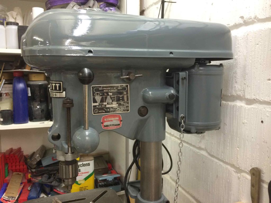

        I have long wanted an Elliott pillar drill and had hoped to buy the Elliott 2G which was in the recent BBC Auction, but I dropped out way before the final price of about £1,000! I bought an Elliott Progress 1 floor standing drill 3 weeks ago which was in fairly good mechanical condition, but a bit tired looking.
        I am now part way through tidying it up, mainly by degreasing, filling and sanding the main chips and dings, repainting with Enamel from Paragon Paints (excellent stuff) and cleaning up the metalwork and treating the screws with the Caswell black oxide process. It's certainly looking a lot smarter.
        Outstanding tasks are:
        • To fit an led light, as per Oompa Lumpa's;
        • To make a locking handle for the quill. Most pictures I have seen of Elliott's show the 3/4" hole at the front of the quill housing to take an 'armstrong' lever, but nothing in it. The "2G" at my local model engineering society has the lever, but I've never seen one on a Progress 1.
        • To fit a chuck guard;
        • To fit a foot operated 'off' switch;
        • To get the chromework rechromed;
        • To fit a linear actuator to the table;
        • To persuade Father Christmas to get me an X/Y Table.

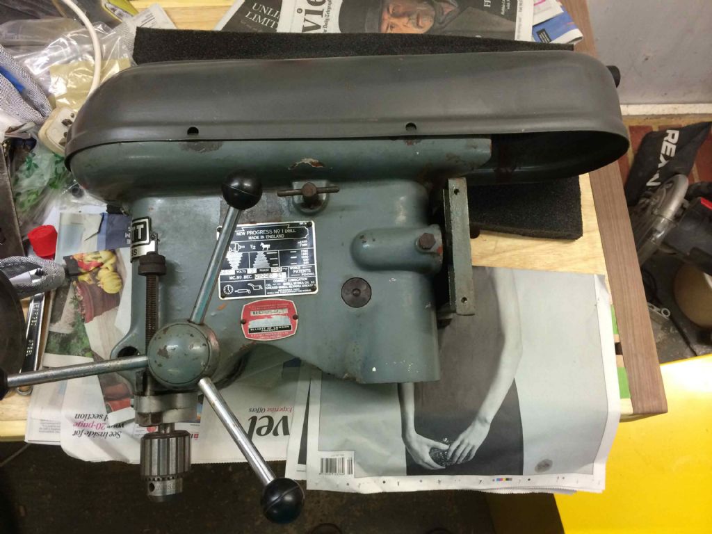

          Here's a photo of the drilling head before I started work:

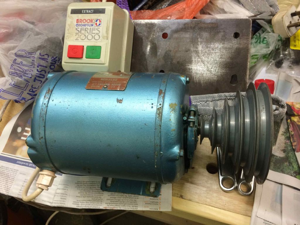

            OK, now that I have found out how to upload photos to an Album, here are some more:

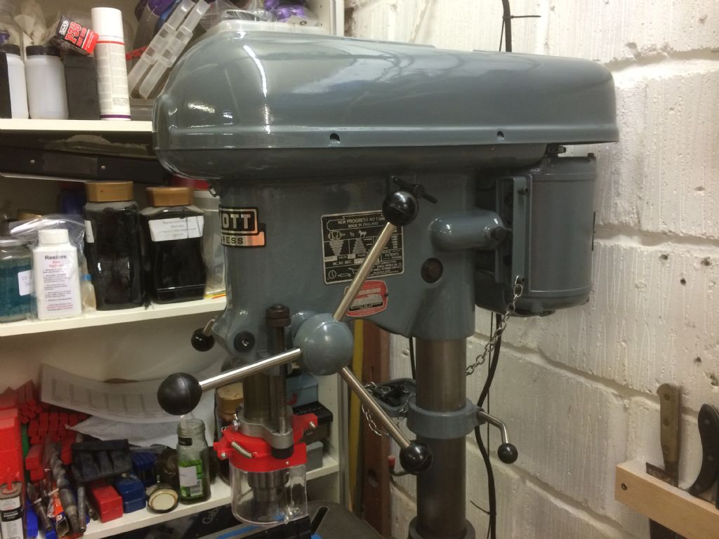

                      My parts arrived back from the chrome platers this morning. Here's how it looks now:
                      Since my previous post I have completed the installation of the LED light (operated via the old motor on/off switch), made an 'armstrong' lever and clamp for the quill, fitted a chuck safety guard, filled in the smiley holes in the table with JB Weld and fitted a linear actuator. The actuator is a great improvement.
                      Just some filling/painting of the table, pillar and base to do and the restoration will be finished.
