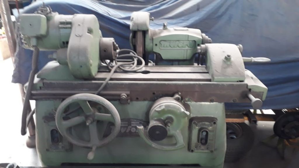

      Hi all,
      I have recently purchased a pre-owned Myford MG9 cylindrical grinder. I will post photographs and information on the restoration of this machine for reference for anyone that may need information for a similar project.
      I haven't yet managed to locate any workshop manuals for this machine, but the disassembly and cleaning was fairly straight forward.

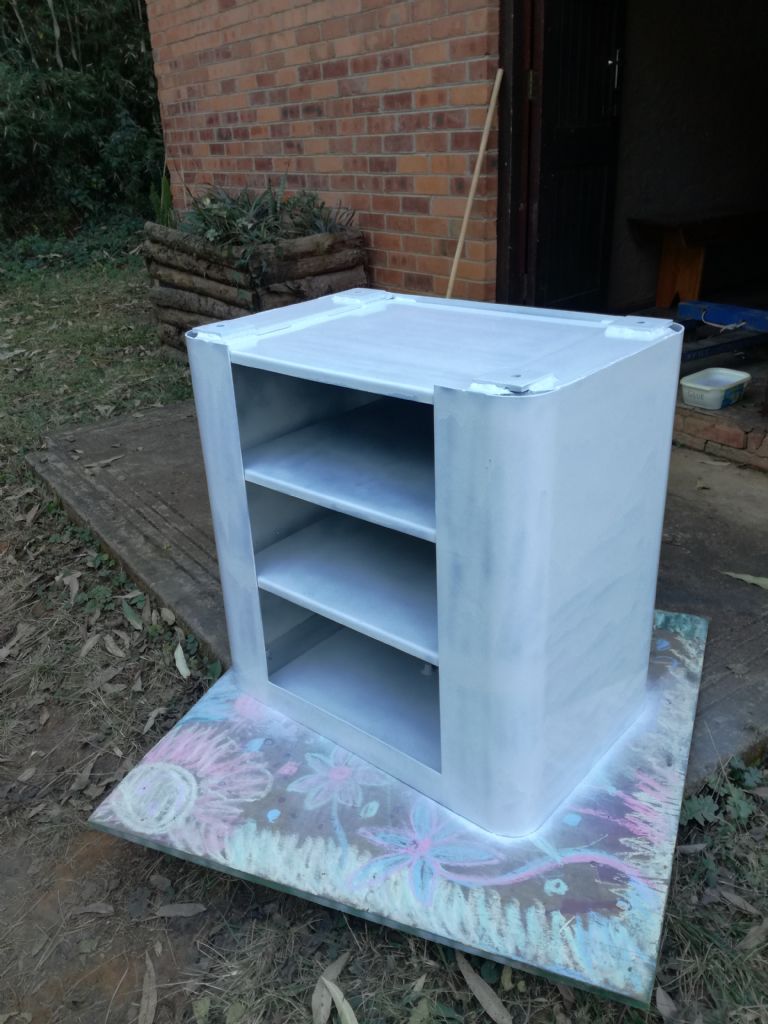

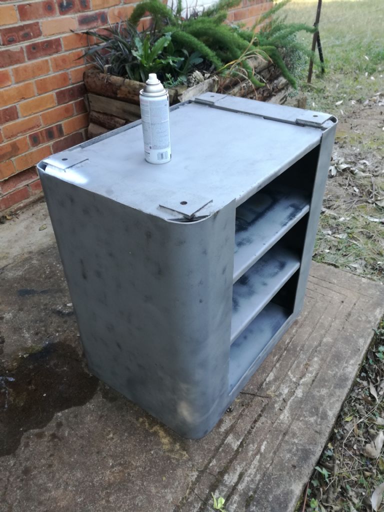

            First order of business: Sand blasting and priming the cabinetimg_20200627_143239.jpg

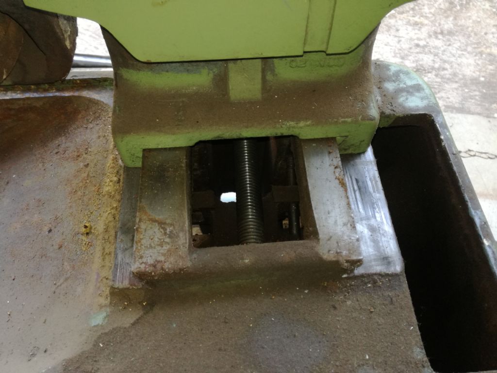

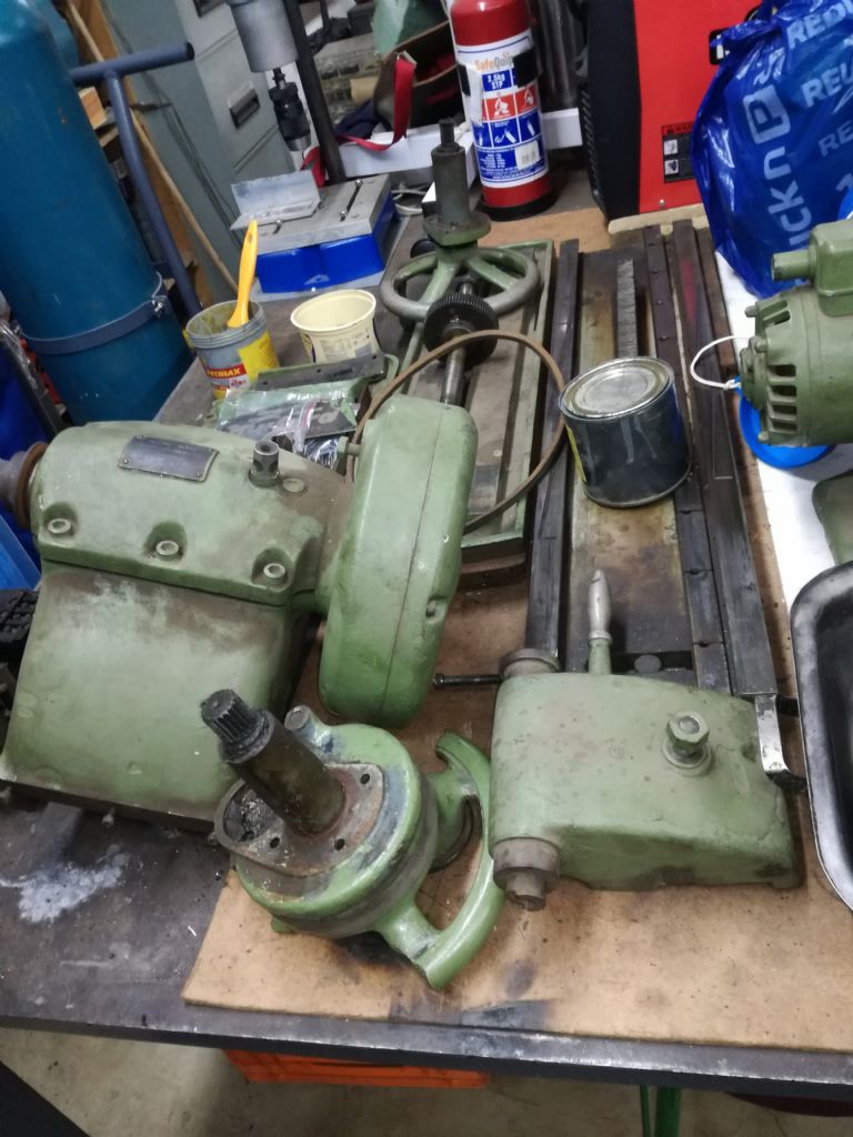

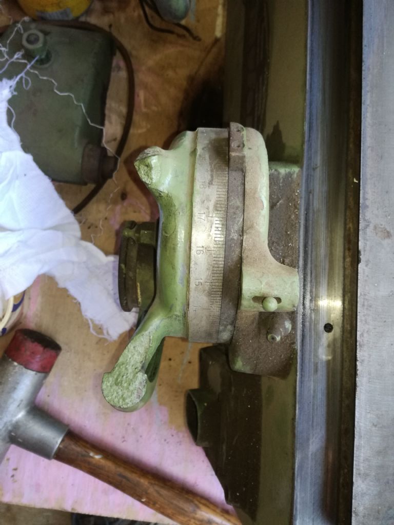

              img_20200704_090102.jpgimg_20200704_090053.jpgimg_20200704_090041.jpgimg_20200704_090034.jpgimg_20200704_090028.jpgNext task, stripping parts off to clean, repair and paint.

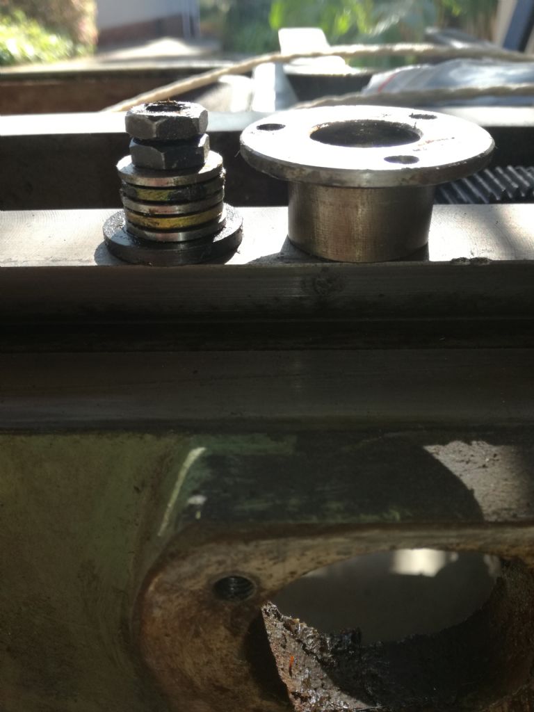

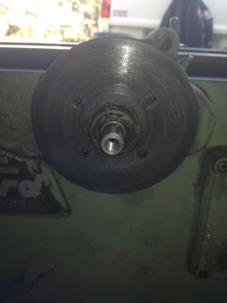

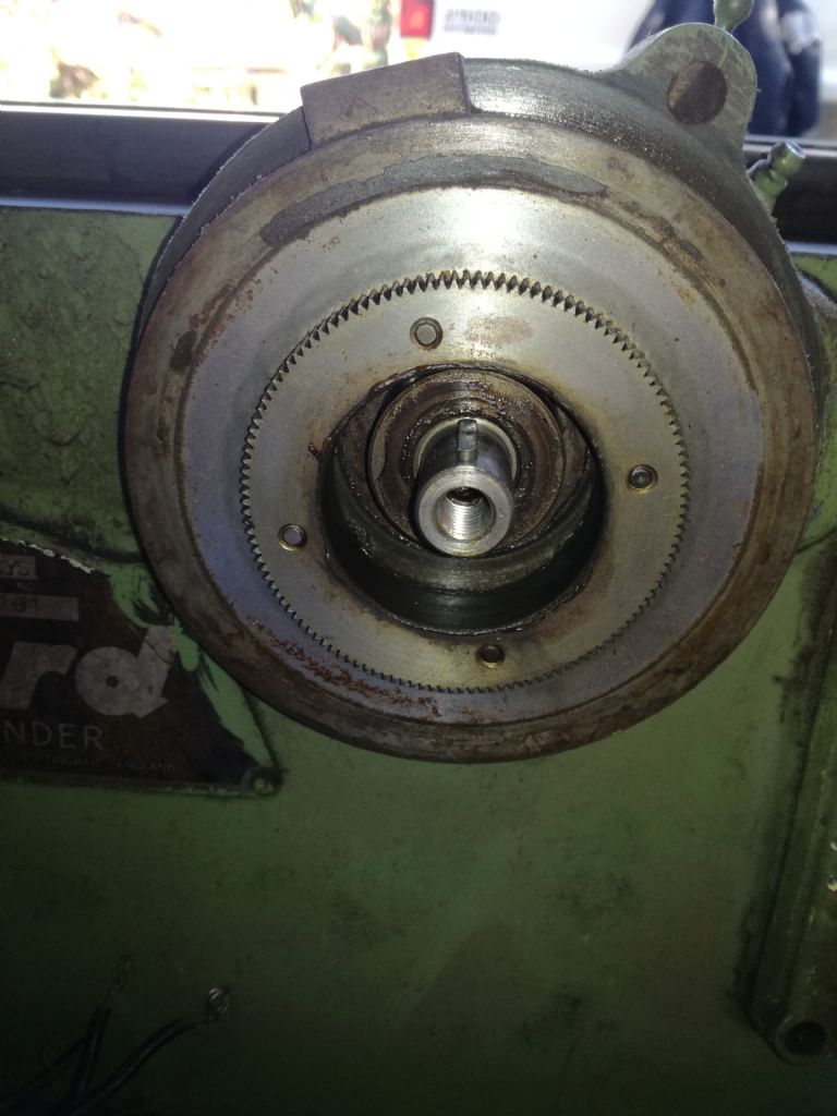

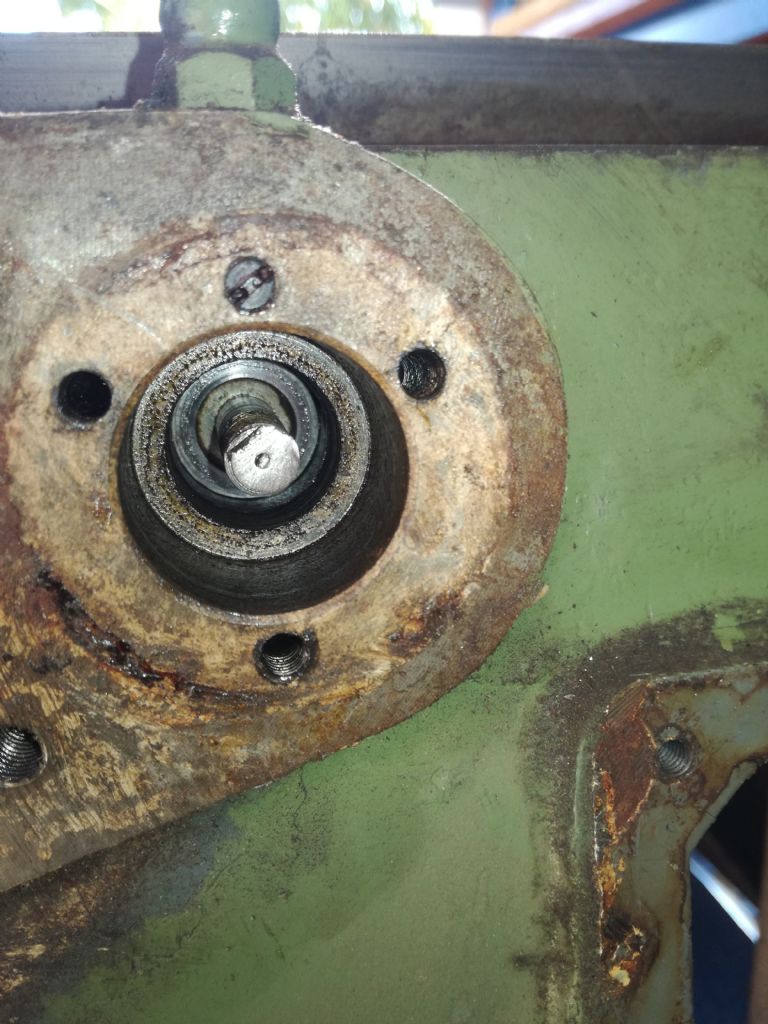

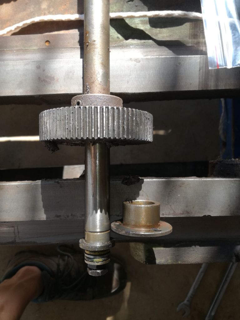

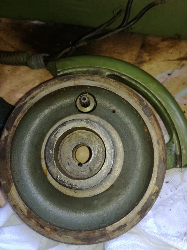

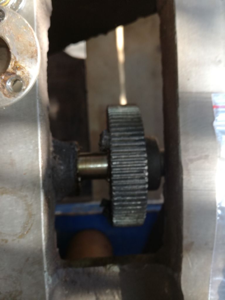

                Getting the drive wheels and shafts out of the main body.
                img_20200704_140351.jpgimg_20200704_140114.jpgimg_20200704_140107.jpgimg_20200704_140101.jpgimg_20200704_093239.jpgimg_20200704_093134.jpgimg_20200704_093129.jpg
                #487459
                Steven van der Watt
                  @stevenvanderwatt67917

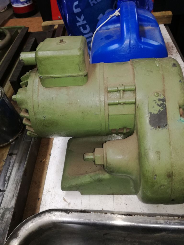

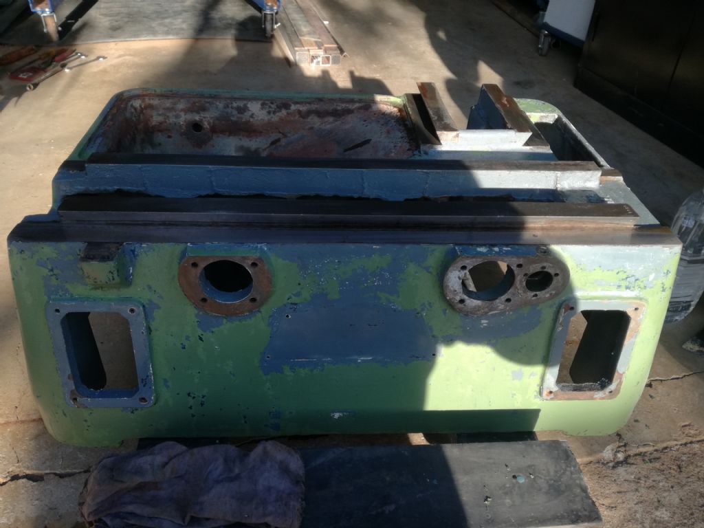

                  Most of the parts separated from the main body. Next job, to pull apart all of these assemblies.
                  img_20200704_155108.jpgimg_20200704_155102.jpgimg_20200704_153949.jpgimg_20200704_153943.jpg

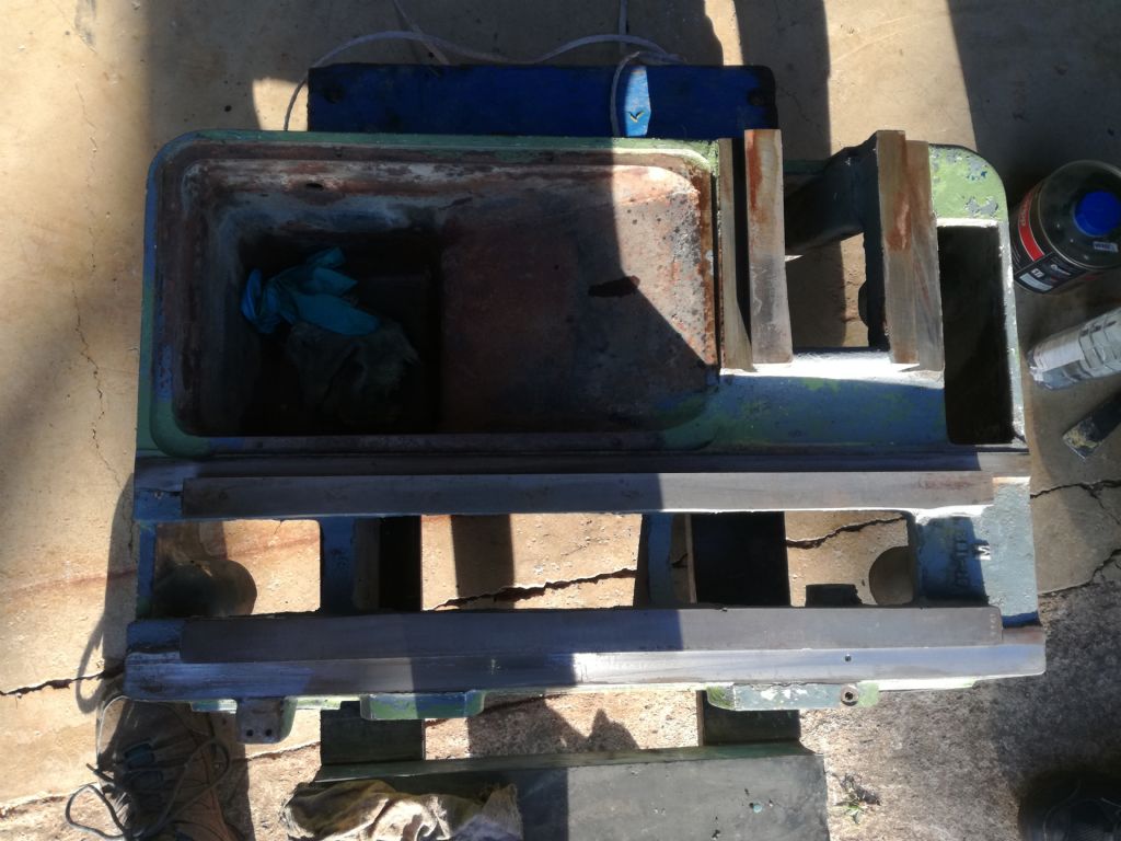

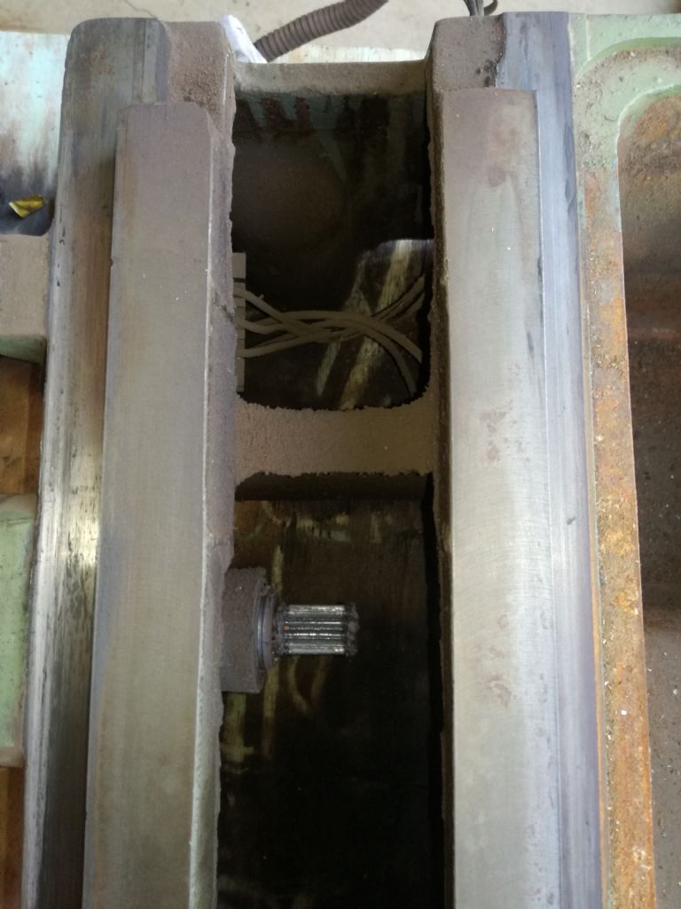

                        I have one of those too, they are not at all common.

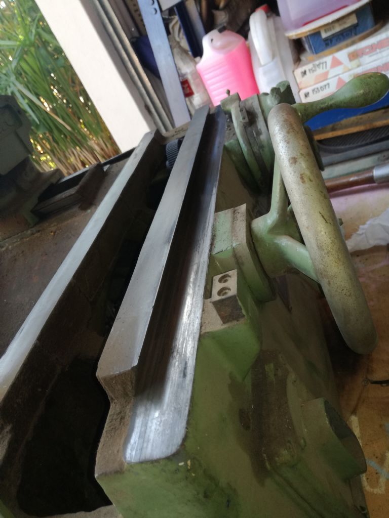

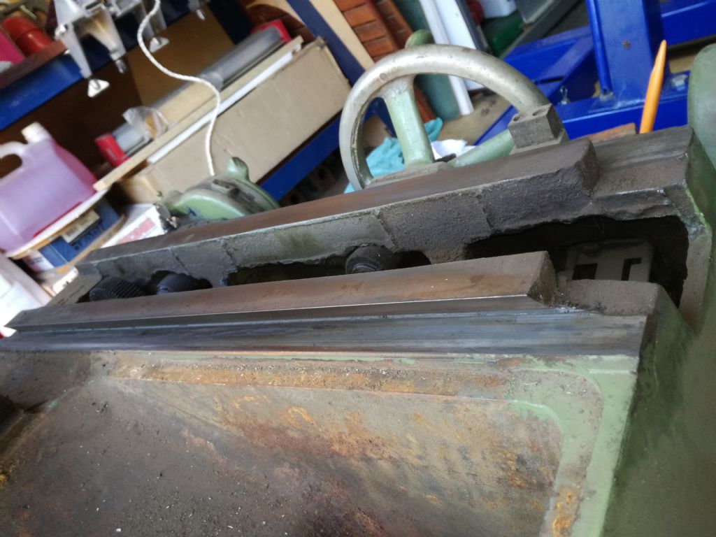

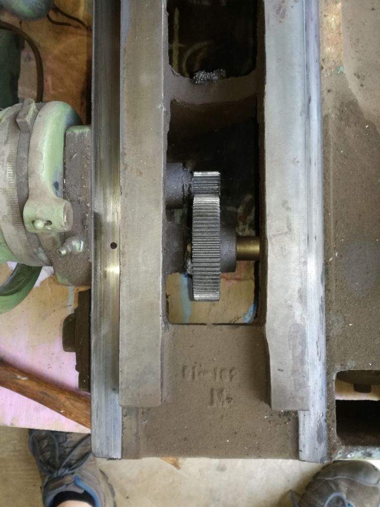

                        Looks like you have a bit of wear in the long ways and they would benefit from a light scrape. Luckily these machines were very evenly but looking at the smear marks on your ways just a go-over with a scraper will improve your oil retention and limit stick-slip in the table.
                        It;s a shame about the busted infeed handwheel but at least it's not the table traverse one. If you have the bits it should be a fairly easy repair.
                        Do you have any other bits apart from what's in the photos? Mine came with internal grinding head and a small steady rest.
