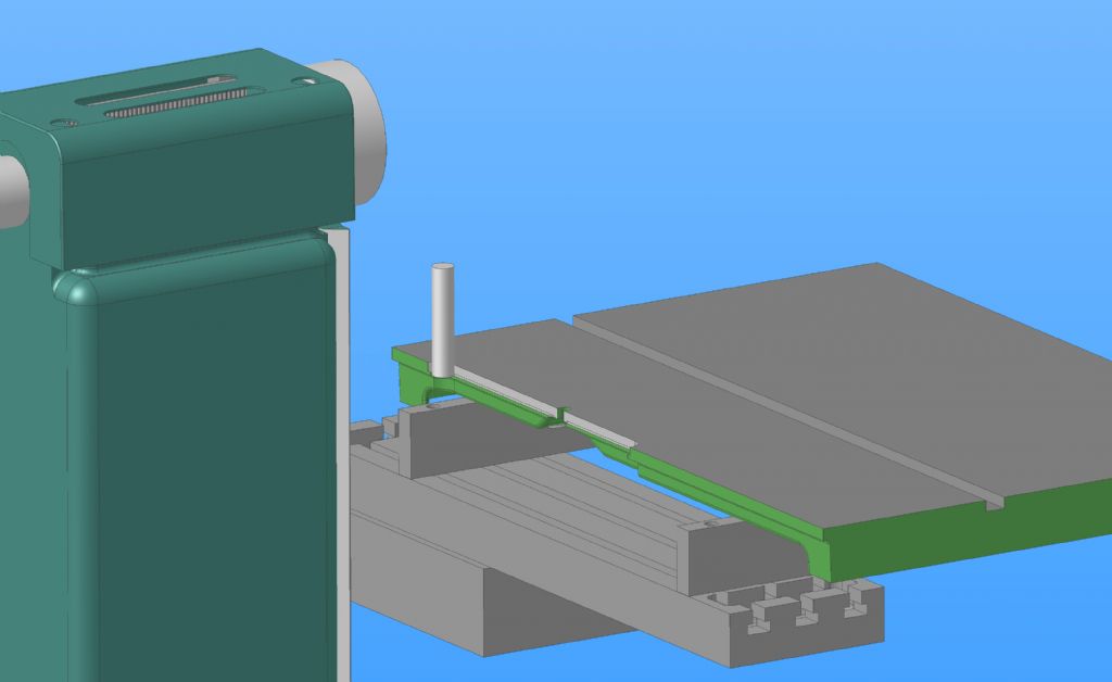

          No progress on the Light Vertical itself but I need to use it to do some modifications to a Wadkin sawbench that I'm restoring…. I'd appreciate some feedback on this…
          I have to cut a rebate into the edge of the saw's table. This is my plan to support the table on the mill, using the existing fixing system and two 50mm x 20mm bars. Does it look ok? I could put a jack where the ribbing reduces? The table weighs about 45kg……

            Thats a lot of overhanging weight straining the knee, is there any way you could use a weight and pulley to assist the balance?

              Thanks old mart. Counterbalancing with weight is a good idea. I'm not too happy working at the limit of longitudinal travel either. Jobs like this are a good case for having a head which rotates around the axis of the column….
              Looks like it will be a day's preparation for 1/2 hour machining

                It is always better to prepare carefully than to regret what you did later. When I made the R8 conversion for the museum's light vertical, I spent ten times as much time setting everything up to be perfect and better than my normal work. There was no second chance to get things exactly right and to my great relief, the results were even better than expected.
                You could move the work between cuts, if the length of cut is too long. Careful re aligning should work fine.

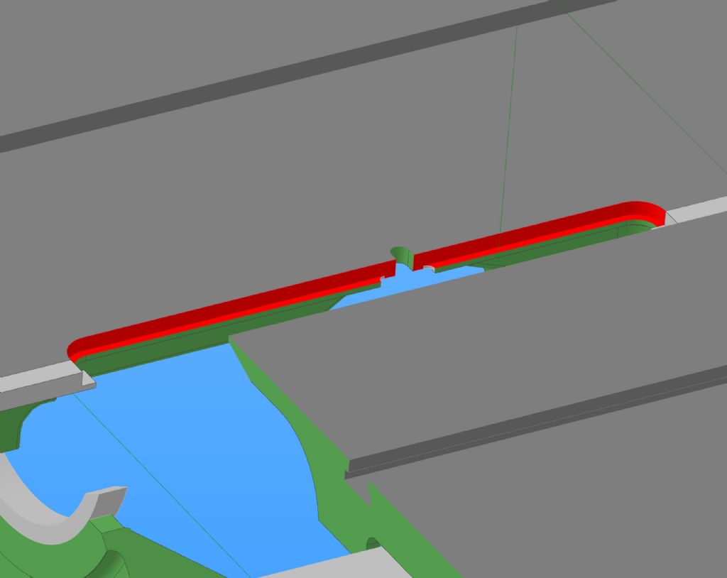

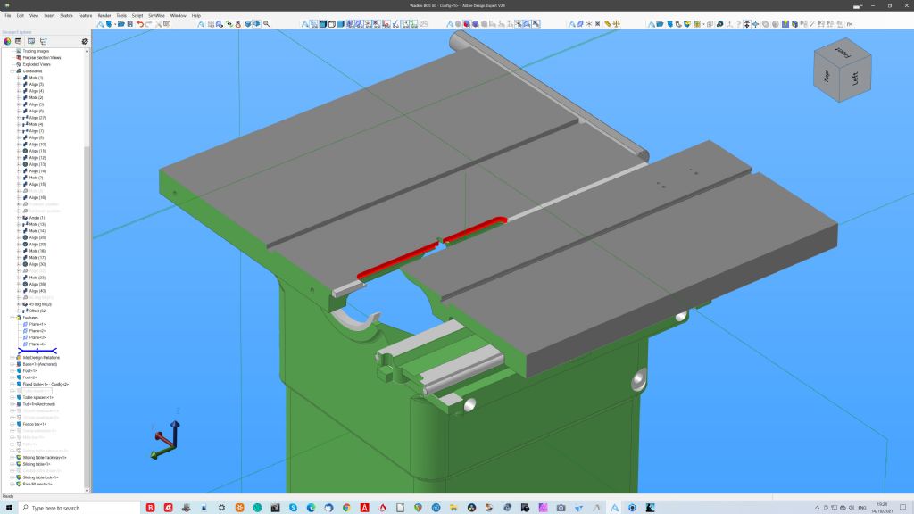

                  Thanks again for your suggestions old mart. 15 months later and I've been wondering if it might be better to take the machine to the workpiece……… The sawbench I'm modifying has a sliding table. It would be possible to mount the ram of my Dore Westbury to the sliding table in order to mill the slot in the main section of the table.
                  In the picture the cut is highlighted in red.
                  Edited By Miles Hellon on 14/10/2021 20:07:59

                    I need a 1" dia. cutter for the end radius. I could get one with a 1/2" shank and use a MT2 collet to mount it as high as possible in the spindle. Was thinking of this cutter

                      That is a lot to pay for one cutter. I wonder if you could get by with a 1" diameter indexable cutter. The type I had in mind uses APHT 11 or 16 inserts.

                        I've never used indexable cutters but I don't see why not. 25mm dia. is fine and with integral 2MT……. I hadn't spotted those on the Arc website. Thanks old mart.

                          The type of indexable cutter I mentioned is not designed to plunge cut more than about 0.01", 0.25mm because it cannot cut in its centre. With that limitation, you could run sideways after the start and cut a groove in several depth steps, or you could use a smaller centre cutting mill to produce a narrower groove before using the bigger one. These indexable mills are available from 10mm diameter with one insert right up to 100mm diameter with about 8 inserts. The shell mills which fit on an arbor to suit your spindle start from about 40mm 4 insert, below that they are usually solid shank. I have a 25mm one with the shank turned down to 20mm to fit an R8 collet.
                          The indexable type are cheaper and the Chinese inserts for steel or aluminium are very cheap, and they are double ended so a box of 10 has 20 cutting edges.

                            Thanks. That should work fine, for me. It's not going to be a very rigid set-up so, I'll only be taking very light cuts. If it takes all morning to cut the rebate, that's ok! I'll do plenty of experimentation first.
