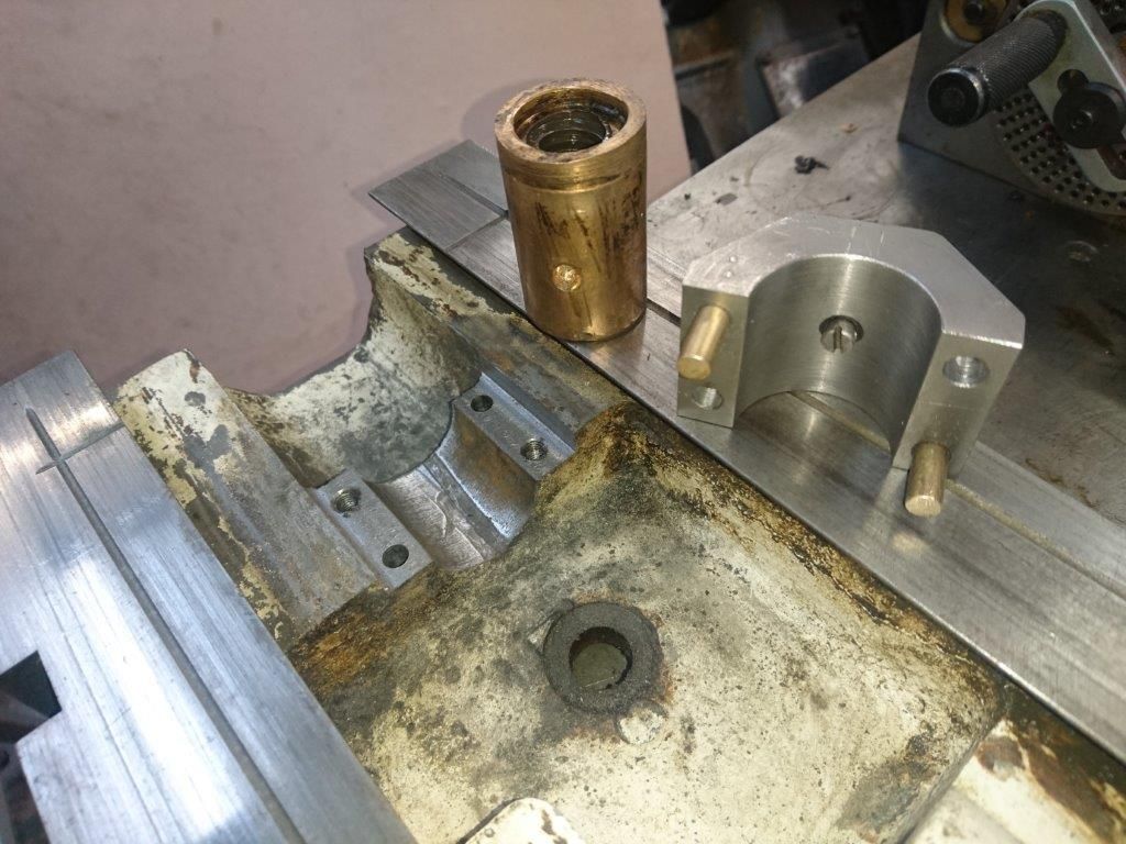

          Tonight's update:
          Pulled the half nut out of the casting. It was a moderate press fit, came out with a bit of help from a piece of M12 studding. Could have used 1/2 whit, but it is a metric machine….
          And here it is fitted in it's proper position.
          There, that was an easy fix (if only).
          Set up and machining tomorrow, after I've got the wood burner going well.

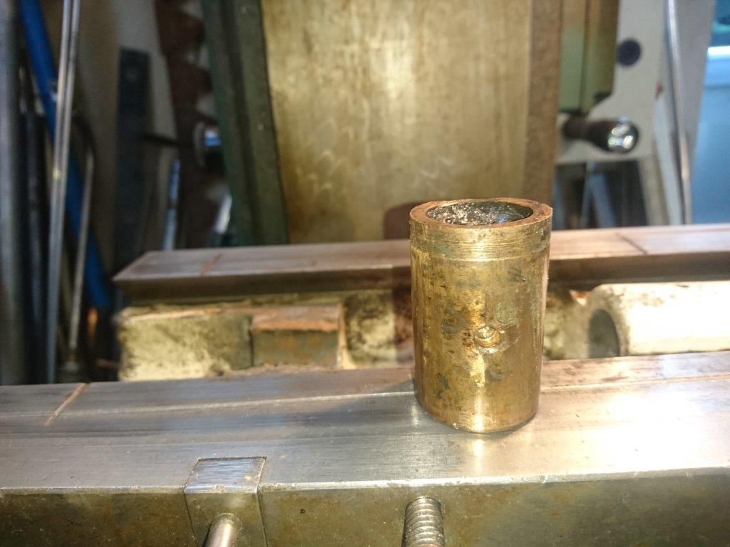

            While it's in your hand Simon can you confirm it's dimensions as 1 1/4" os diam by 2" long.
            I know we can only surmise but I wonder if the damage happened when a new nut was been inserted?
            Edited By ian j on 04/01/2019 19:27:50
            #389379
            Simon Williams 3
              @simonwilliams3
              Posted by ian j on 04/01/2019 19:26:27:
              Ian –
              Bush measures 1.243 OD (mostly) by 1.960 long overall. Material is visually bronze, not brass it's not yellow its pink. (phosphor bronze?)
              I like the suggestion of having broken the casting by over-enthusiastic bush fitting, that's a simpler and more plausible suggestion than somehow it fell over leaving no other visible marks. The only thing is, that bush is a slack sloppy fit in the remnant of the proper location. The socket left is about 200 degrees of a circle so it's pretty easy to gauge the diameter, and although it's significantly scored it's pretty much round albeit oversize. I wonder if someone failed to realise there was a grubscrew locating the bush axially and radially, wound happily on some kind of extractor and only stopped when it was too late. Ping!
              Best rgds Simon

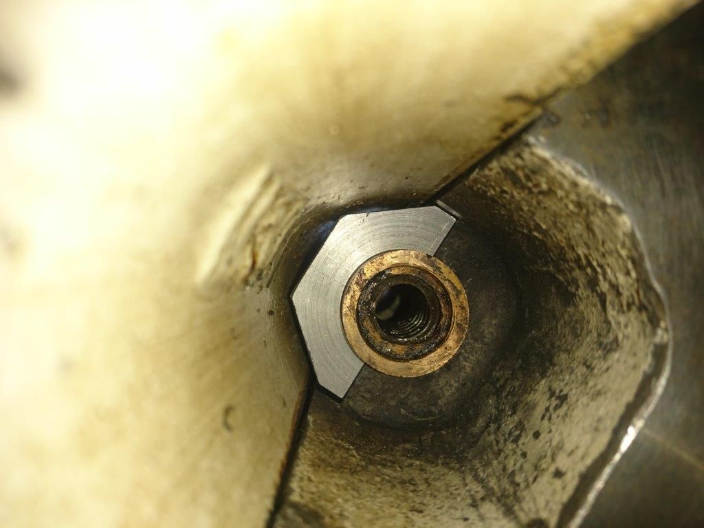

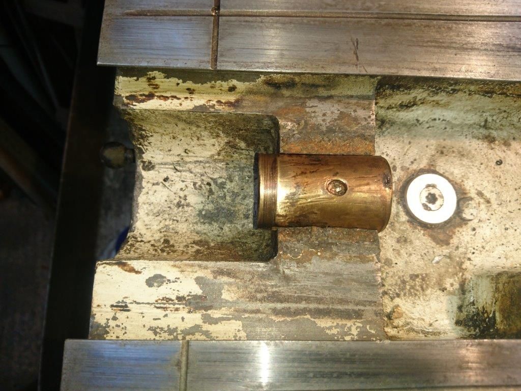

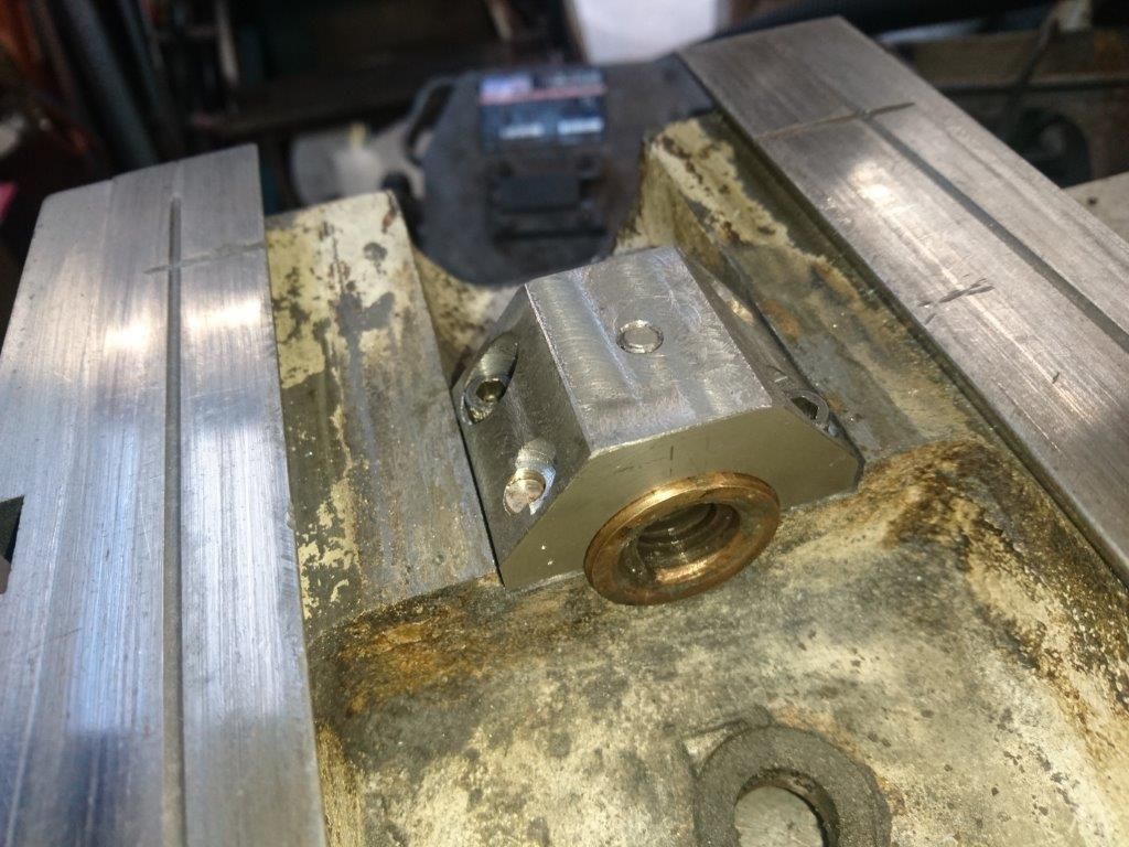

                Good afternoon all.
                Spent my weekend worshipping the god of swarf, so here is the preparation for my repair to the broken leadscrew mounting casting:
                And here it is assembled
                xxx
                And just to prove that it clears the channel in the bottom of the table casting (if only just):
                The orientation of this photo is a bit odd, only so I could get the camera near enough. "Up" is about 10 o'clock.
                So bung it all back together and it all fits and lines up and slides and wotnot. X travel now measures 18-3/16, which is a result I'm very pleased with.
                Thank you gents for your help in determining that it needed surgery, hope your restoration s equally satisfactory.
                Best rgds and a Happy New Year.
                Simon
                #389685
                ianj
                  @ians
                  Simon that's  an excellent solution and work, better than original in my opinion. I'm sure you are very happy with the end result not to mention the extra table travel !

                      You must have read my mind as I did contact the ebay chap.I think he would have been prepared to make one but he must screw cut the thread and then finish with a tap. But he only has a LH 3/4" by 5mm pitch tap.OK for the Y axis but the X is RH.
                      If you join the yahoo Tom Senior group , in the files section there is a file showing how to modify the nut to compensate the back lash..

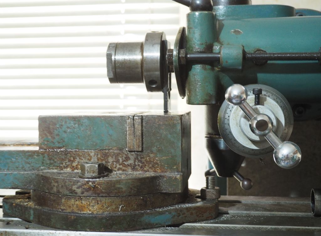

                                  Timely bump. Just about to start working on mine again.
                                  Just received the No. 6 chuck removal wedge set which I ordered from the U.S. on Monday!
                                  Any one have advice on using these to extract a very tight MT2 arbor?
                                  Miles
                                  #469803
                                  Steviegtr
                                    @steviegtr
                                    Not used one of those. When I bought my mill, the chuck was very tight in. Managed to get out with the draw bar unscrewed 2 threads & a hefty blow. Since then not had a problem. I do not tighten the bar hard, Never slipped so far.
                                    Steve.
                                    #469805
                                      Hold chuck and arbor horizintally with wedges lightly in place – tapered edges together, rest one wedge on something solid and tap the top wedge with a copper hammer and it should pop the chuck off the arbor, a third hand to catch the chuck helps.
                                      #469806
                                      Miles Hellon
                                        @mileshellon
                                        I've already soaked mine in penetrating oil and hit the drawbar as hard as I feel comfortable doing. I was worried about damaging the bearings. Will try with the wedge set and a clamp.
                                        Miles
                                        #469815
                                        Miles Hellon
                                          @mileshellon
                                          Thanks Jason,
                                          This is to remove a collet chuck from the machine. I could turn the head horizontally and support the wedge on a machine vice on the bed?
                                          Miles

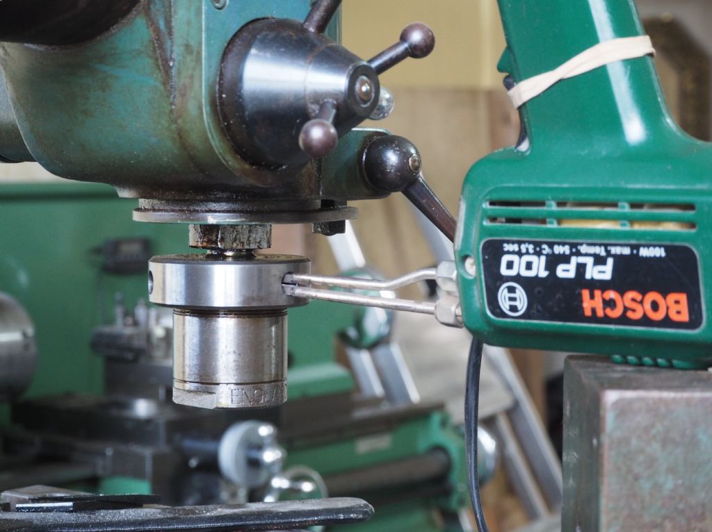

                                                  #469875
                                                  Miles Hellon
                                                    @mileshellon
                                                    Tried heating up the chuck's collar with my soldering iron, in an attempt to free it. No luck with that.
                                                    Anyway, managed to extract the chuck with the wedges, using this setup:
                                                    Thanks again for the help.
