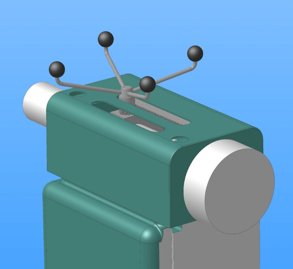

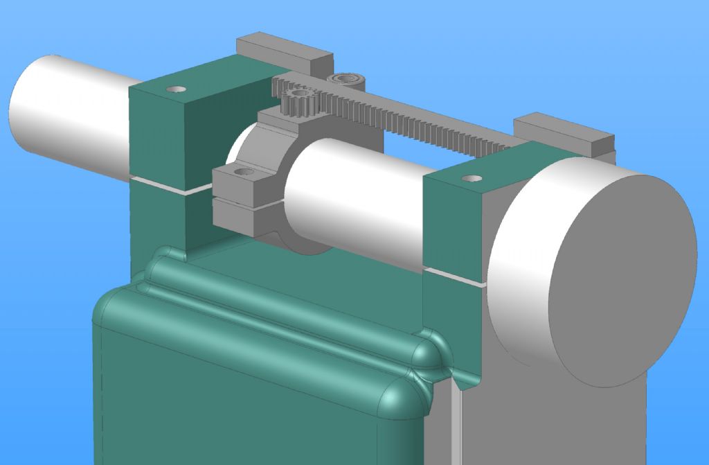

      I've just sketched out my initial thoughts:
      #388932
      Miles Hellon
        @mileshellon
        The idea is to keep everything within the original top cover, which will have a couple of slots added to access the new controls.ts mod. 3.jpg

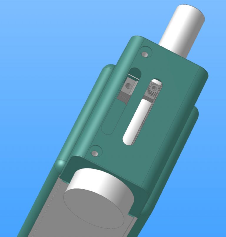

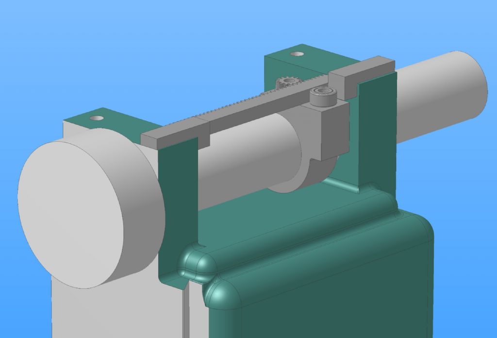

          Maybe something like this?

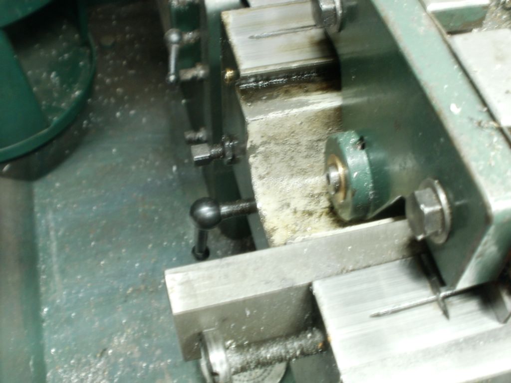

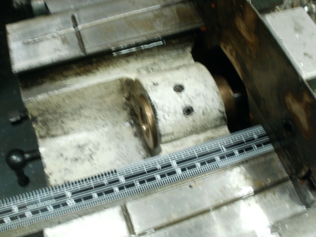

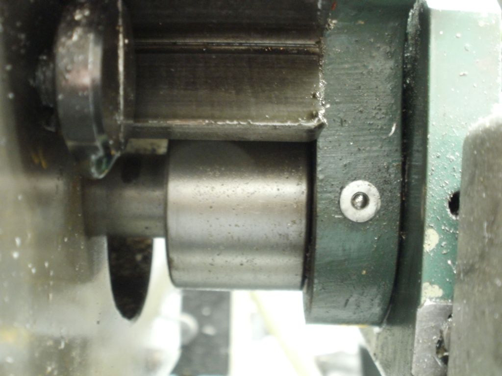

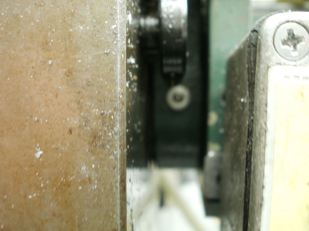

                                #389180
                                ianj
                                  @ians
                                  Yes Miles the limit at the RH end is when the leadscrew support casting hits the face of the lower section.
                                  First photo shows this while the second photo shows the table approaching.
                                  Simon. The feedscrew nut on mine is as you think, to the left,The photo below shows the feed screw casting coming into contact with it. I thought I had photo's of the table removed, but no!
                                   I can take a photo tomorrow if you like as it's only a matter of taking the feed screw support casting off and winding the feed screw out and pulling the table to the right far enough to show the feed nut.
                                  Edited By ian j on 03/01/2019 18:21:23
                                  Edited By ian j on 03/01/2019 18:30:23
                                  #389182
                                  Miles Hellon
                                    @mileshellon
                                    Thanks a lot Ian.
                                    I can confirm that, after tweaking the LH support bracket position to clear the face of the lower section, I've now got 16-13/16 inches of travel. Close enough!
                                    Miles

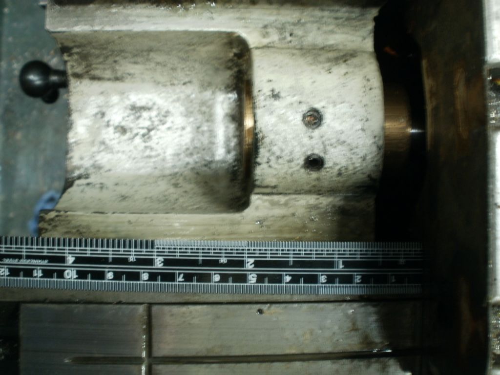

                                      #389205
                                      Simon Williams 3
                                        @simonwilliams3

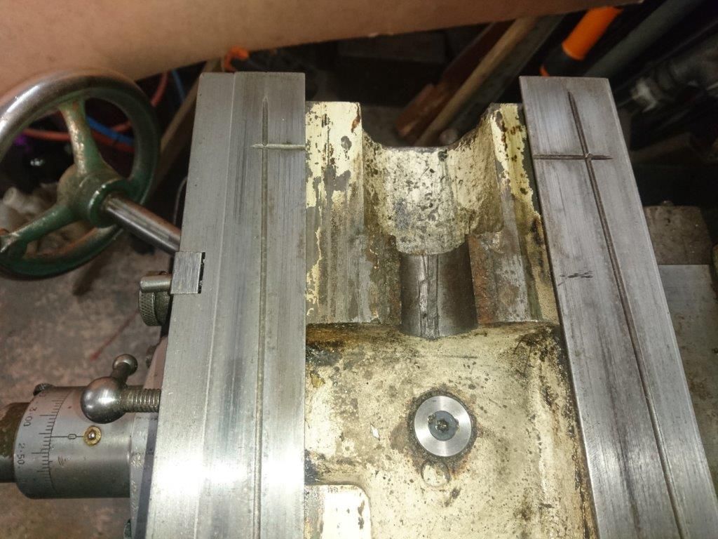

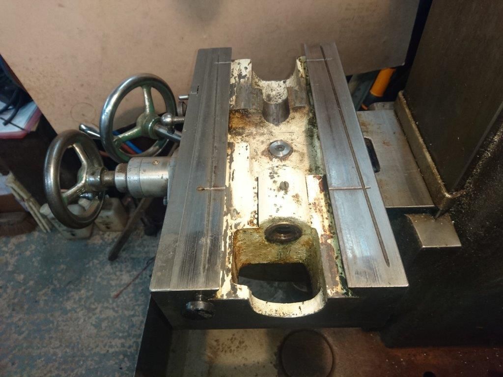

                                        Well, nothing venture nothing gained, so I have stripped the table off the cross slide, and suddenly all becomes crystal clear.
                                        Somebody had a major crash (tip over?) and broke the lead nut out of its casting. Somebody else devised a simple fix – put the lead nut in the other hole. What I have been seeing is the consequence of moving the lead nut 7 inches or so to the right.
                                        Here's a closer view of the site of the break.
                                        Which strikes me as relatively easily fixed, though I do need another milling machine to make a flat area each side of the original bore for the nut. I can then make a half clamp and clamp the half nut back where it belongs. I'm toying with whether I can do this with my horizontal mill, don't see why not with a bit of patience.
                                        However the interesting part of the riddle remains, as I believe all the parts are original. There is a number 14 stamped on the main column above the s/no, and the same number is on all of the bits of the knee, including the table and the gib strip. So I'm lead to think that all the bits are there, but not necessarily in the right order.
                                        Keep you posted!
                                        Regards to all
                                        Simon

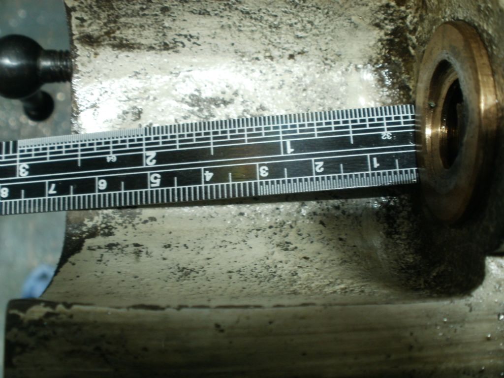

                                        #389227
                                        ianj
                                          @ians
                                          p1032091.jpgp1032090.jpgp1032087.jpgSimon.
                                          That's very interesting !
                                          Here are some photos of the lead screw nut on mine.Bit late as you have found the problem.Difficult to understand how that damage could occur.
                                          I have about 017" of back lash on my nut.If you ever find a source of new bronze nuts let me know.
                                          Edited By ian j on 03/01/2019 22:04:01
                                          #389232
                                          Simon Williams 3
                                            @simonwilliams3
                                            Hi Ian, yes I think your pictures just about seal the diagnosis. You're right though, I can't imagine how someone managed to do this much damage without wrecking at least something major, so I'm scratching my head a bit. I see no evidence of dings or bruises elsewhere, suppose I should be grateful it has survived this well.
                                            I guess it doesn't matter too much, I've just got to get past that and find an honourable fix, even if I have to get someone locally to make the necessary mod's to this casting. I'll keep you posted.
                                            And thanks to Miles for letting me hijack his thread.
                                            Best rgds Simon
