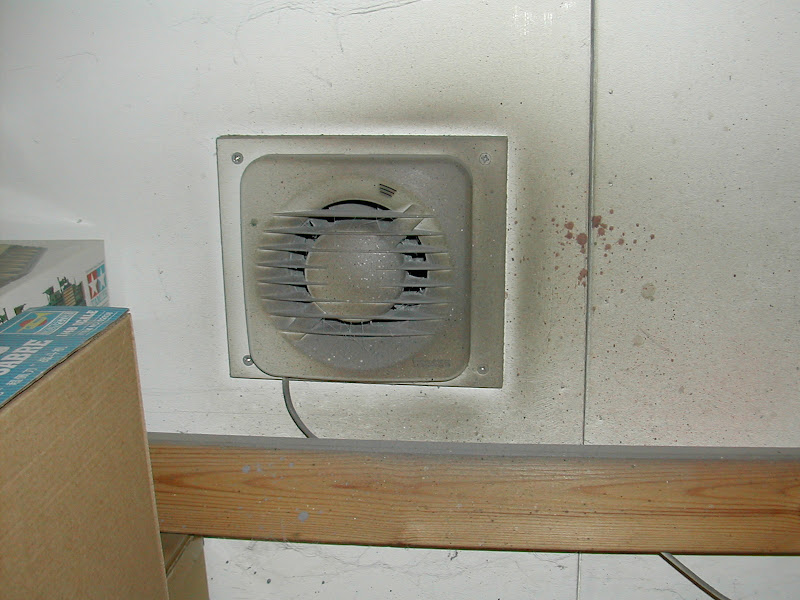

Beside ME I do have a lessor passion for plastic modelling and when not ME’ing am spraying constantly though mainly with acrylics which cause no problem. However there is a product called Alclad2 which, cellulose based, is very pungent and I cannot spray it without the mask above. Coupled with the mask I have fitted a small 4″ wall mounted fan beneath my bench which copes admirably in getting the fume out without causing a gale and items are sprayed in it’s general direction. A B&Q job, it must have been in use since around 03 and is really due for a change as it’s getting a bit rattle-ly
You can see from this that it really draws the paint in. It should be pointed out that with a high cellulose overspray this may present a fire risk – something to be borne in mind.
