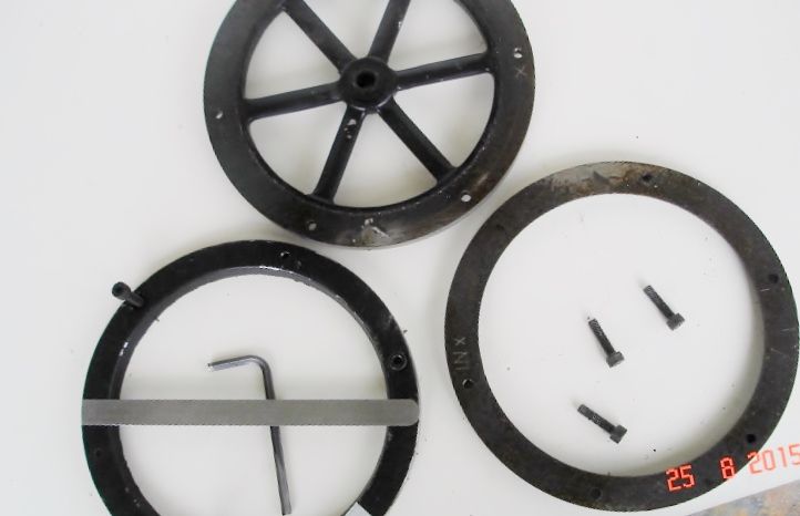

                                The bits needed to make a fly wheel for one of my hot air engines, it started out as three discs of 10 mm hot rolled plate(cut outs from another job), the centre on drilled out for spokes, and a hub brazed in, the other two made into rings to form the rim, the three bits bolted together with 10-32 UNF bolts, the outside skimmed in the lathe.
