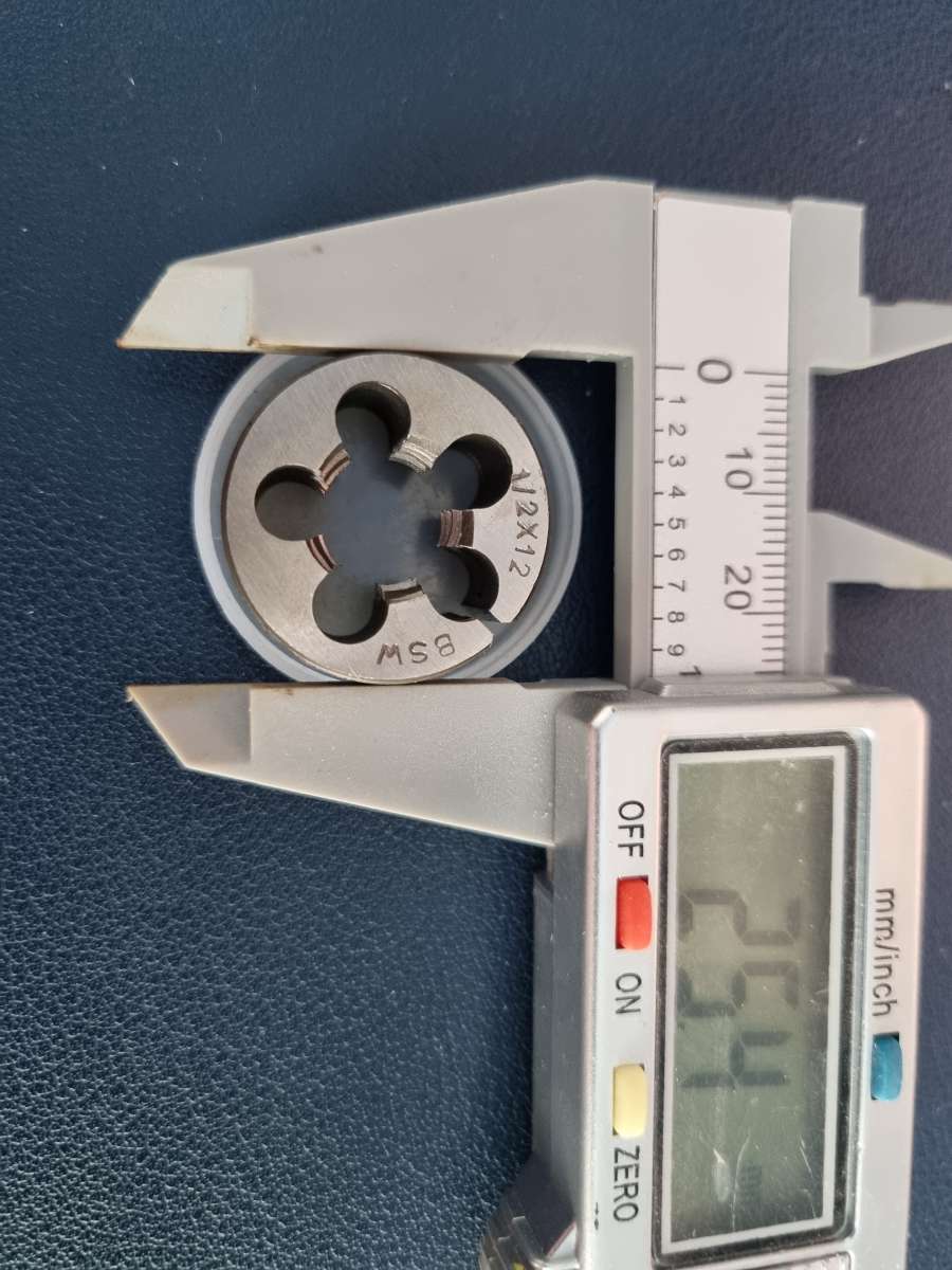

                                      Danni Burns
                                        @danniburns84841
                                        Thanks Jason
                                        So it’s a manufacturer preference.
                                        I’ve just bought a 1/2″ BSW with 1″ (25.2mm actually) diameter, and it looks disproportionate. Maybe, because it’s (supposed to be) Tungsten or just manufacturer cost saving. I don’t mind as long as it cuts the thread well – for £6 I’d be a fool to moan. It’s half a day (turning and milling) wasted if it makes a pig’s ear, though.
                                        My main point is – I know I won’t be using the holder/wrench that I was expecting to use, and it could be hard/uncomfortable work with a smaller handled wrench.
                                        FYI – My quick search for wrenches (online shop) showed 25mm for a max. M9 die; with 38mm for M12 and bigger.
                                        20250325_124739
                                        Thanks
                                        #790400
                                        Danni Burns
                                          @danniburns84841
                                          Hi Rod
                                          I think split dies are better (more expensive as well). They give some control of tread cutting, using the middle cone screw to expand the cutting diameter.
                                          But if your tool does that job you want, it seems you must have the best tool for it.
                                          cheeers

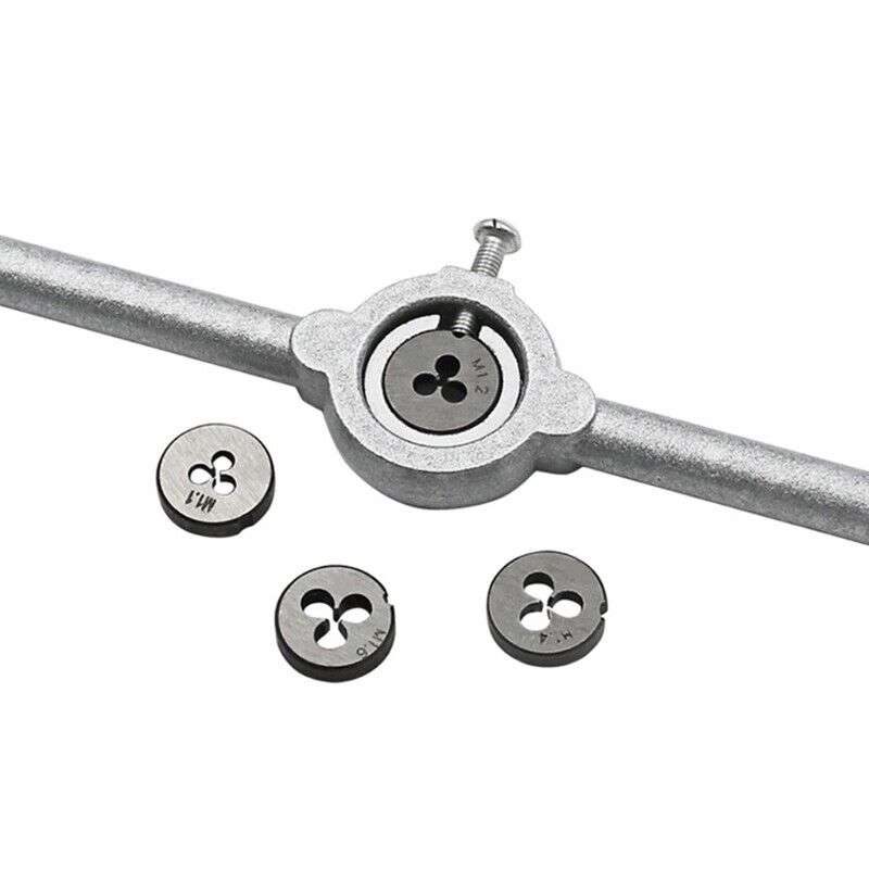

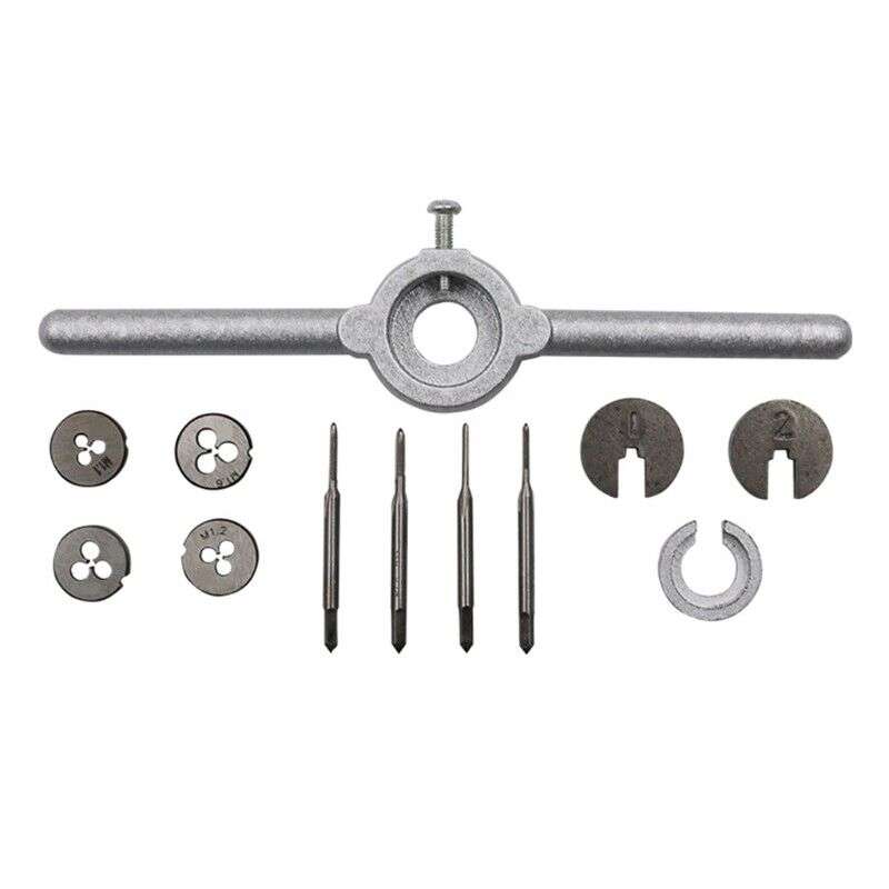

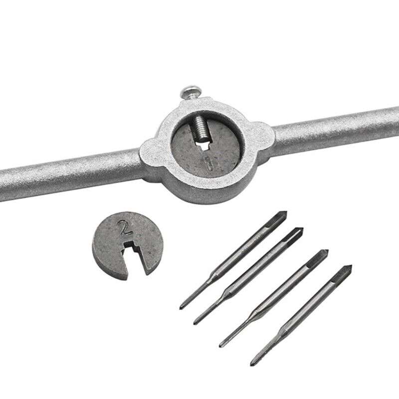

                                                Maybe I have led a sheltered life, but I have also never seen one of these inserts to make a die wrench into a tap wrenchtap holder2 s-l1600tap holder s-l1600

                                                  Nicholas Farr
                                                    @nicholasfarr14254
                                                    Hi Danni Burns, I bought one of those sets of taps and die’s, with the adapters for holding the taps in the die stock from Chronos, a few years ago, Mini tap and Die’s needless to say they were rather fiddley to use, and I didn’t think it held the taps that good, but I did buy a size 0 tap wrench from Tap wrench size 0 which holds better and controls the use well.
                                                    Regards Nick.

                                                    Danni Burns
                                                      @danniburns84841
                                                      I found that I had a 25mm die holder/wrench (actually, it’s double-sided with 20mm) that I had made as an apprentice. So, I just opened it up to 1″.
                                                      I’ve just done the job with that (manually, but the part held in the lathe chuck) and made a real mess of the part and my hands. It undercut approximately 30% of the length of the thread – this can only be due to swarf build-up, really, so entirely my fault.
                                                      BTW the thread is only 2″ long, and Mild Steel at that!
                                                      Anyway, it’s too much hard work without the leverage of a large die wrench and I’m not convinced that a sleeve wont just create a point of weakness i.e. that would mean holding the die with only 1 screw.
                                                      In conclusion, a 1″ dia Die for cutting a fresh 1/2″ thread is way too small. Lesson learned.
