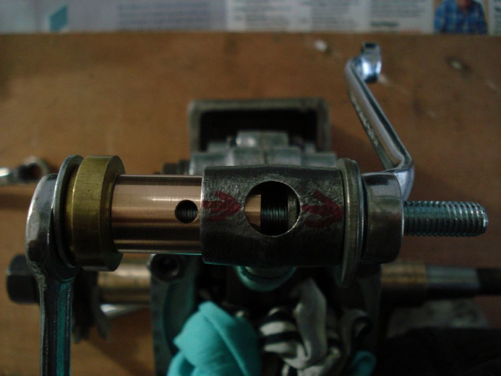

                      With the lathe in pieces, it is probably a bit too late for this, unless you reassemble. (After all it has run for some time like this, and you are going to replace the parts anyway )
                      Obtain a short piece of studding and two nut (say M8 ) Tuurn up a large diameter washer and two cylinders,(with clearance holes through the centre ) one just smaller than the OD of the oilite bushes, and the other larger.
                      You now have the means to push the bushes out of the casting, and to pull the new bushes into place.
                      The new bushes had been soaked in oil for 24 hours before fitting.
                      My bushes were then too tight to admit the new shaft, so the an undamaged portion of the old shaft became a D bit to open up the bushes, to allow the new shaft to enter..
                      Howard

                                              Oilite bushes are sintered and porous, so that having been soaked in oil it is retained in the pores. Reaming can smear the metal and close up the pores, and therefore the oil supply.
                                              Hence the need to soak the new bushes in oil for 24 hours before installation.
                                              Followed by regular top ups when in service.
                                              For the time that it takes, reassemble, and use the lathe to make the washer and dollies to press the bushes out and the new ones in.
                                              As I said, rather than ream, and risk smearing, I used the unworn end of the old shaft as a D bit to skim the few tenths off the ID to allow the new countershaft to go into place. (Pulling the new bush into place will squeeze it and reduce the bore by gnats whisker )
                                              By changing one bush at a time, the old bush can be used to ensure alignment whilst opening up the bore of the new bush, and then use the first new bush to hold alignment for opening up the second bus, ready for the new countershaft..
