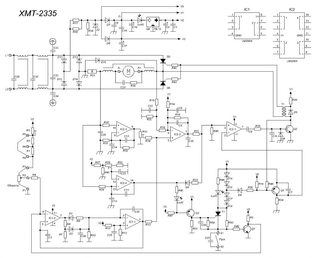

      Needing to replace a motor speed controller seems to be 'not uncommon'. The motor on my Sealey SM2502 stopped working after I tried using a 65mm slitting saw. The motor is OK because it works with 12V DC (Slowly but with plenty of torque.
      I examined the control board and it has no signs of frying any components. I poked around with my Scope and, apart from the rectification of the input mains supply, it was too hard to trace any fault – apart from no output.
      I'm tempted to try a twenty quid controller from eBay, which is ok of a 300W DC brush motor at 230V. I could try replacing the major active devices and the capacitors but it could easily cost me a lot of fruitless effort and the cost of the bits. I can't find a schematic diagram either, which makes it doubly difficult.
      I understand that quite a few people have gone down this road, rather than paying a lot of money for a manufacturer's replacement. Are there any lessons to learn? I was wondering if some extra protection in the form of a MCP breaker might do the job as the available cheap boards don't claim to have any (afaics).
      What's my chance of success? I really don't want to be without the Mill for longer than necessary.

                          It would be really handy to get hold of a schematic diagram of this thing. I guess the makers don't want it to be very public.
                          I was always hopeless at getting a diagram from just a PCB and I am totally out of practice now.

                            Unless you operate with a fully isolated floating supply, “poking around” with an oscilloscope is not a good idea.
                            The 0V rail is referenced at half mains voltage.
                            There are 2 heavy current diodes and 2 similar rated scr’s connected in a full wave bridge configuration.
                            The scr’s are triggered by the low level electronics. If the supply to these isn’t present then the scr’s won’t be triggered at all….Check the 15K 2W carbon resistor adjacent the 0.01Ohm current sensing resistor…..

                                Here is a schematic for the XMT-2335 board in case you do not have one.
                                Arc Euro stock them under Seig X2 spares but they are £136.31.
                                Les.

                                  Cheers Les. That diagram is very helpful. That sort of circuit is far from intuitive when it pulls itself up by its own bootstraps. I'm just wondering if it could be the speed adjustment pot or its connections. After all, the last thing I did before it wouldn't;t work any more was to use the switch or the pot itself.
                                  In the light of the fact that the board show no signs of heat or damage and there's no funny smell anywhere I can now look at places on the board to check on the paths there and back from the pot. The only annoyance is that I won't be able to look at it till tomorrow pm at the earliest.

                                      Posted by John Rudd on 20/01/2021 13:53:51:The scr’s are triggered by the low level electronics. If the supply to these isn’t present then the scr’s won’t be triggered at all….Check the 15K 2W carbon resistor adjacent the 0.01Ohm current sensing resistor…..
                                      Spot on – well done – the 15k carbon resistor is O/C. So none of the control circuit gets any power. Is the other resistor in parallel just a backup to keep some bias on the downstream bits?
                                      Actually 2W rating doesn't leave a lot in hand (200V squared / 15K is 2.5W) so a bigger replacement may be a good idea. The way it's mounted implies they expect it to get warm.
                                            The purpose of the 100k resistor isnt clear…Its value is too high and its rating too low to be of any useful purpose.
                                            I generally replace the 15K carbon unit with a 5 Watt ceramic wirewound type for a lasting repair…(I've told all my secrets now…)
