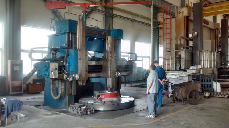

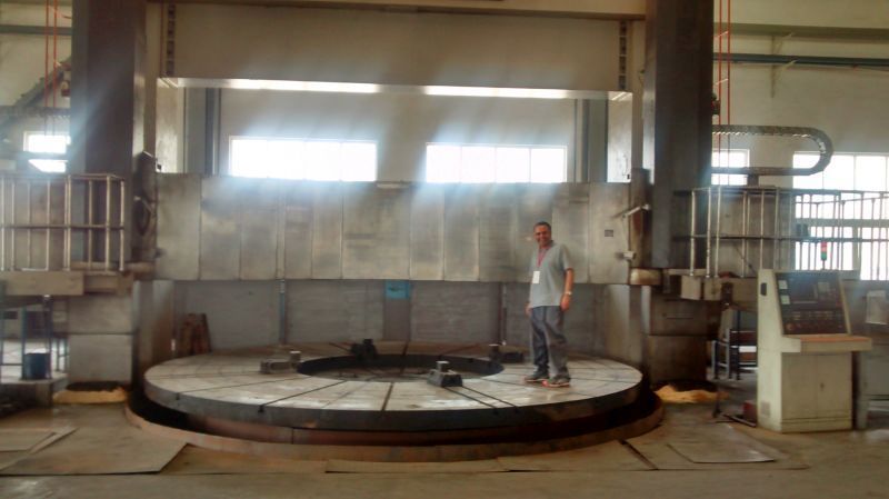

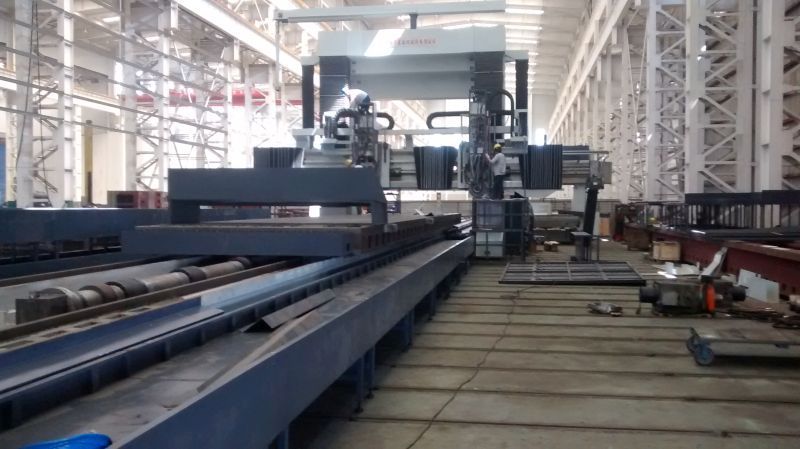

                      Pictures by the late John S.
                      Neil.
                      Talk about a Freudian slip… I typed lathe instead of late. That would have tickled John's sense of humour!
