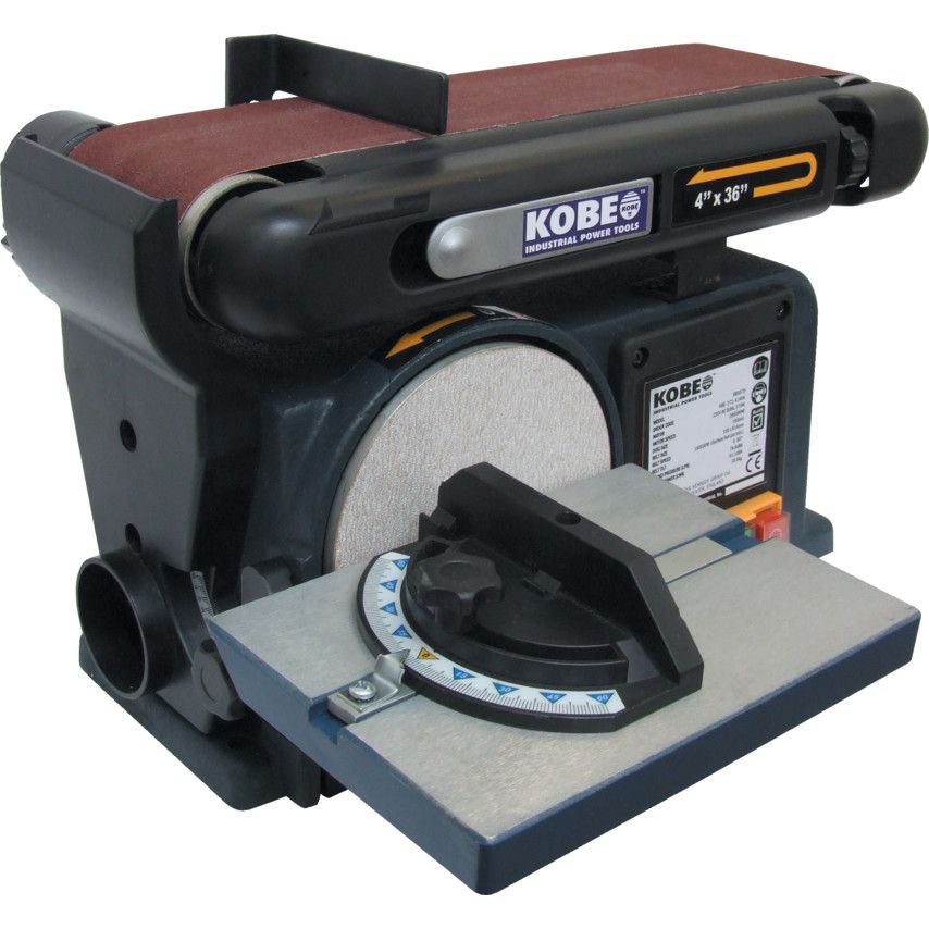

      A friend offered to let me use his Kobe belt sander if I fixed it! The problem was that pressing the green button would start the motor but the motor stopped as soon as the green button was released.
      Here's a picture of the sander:

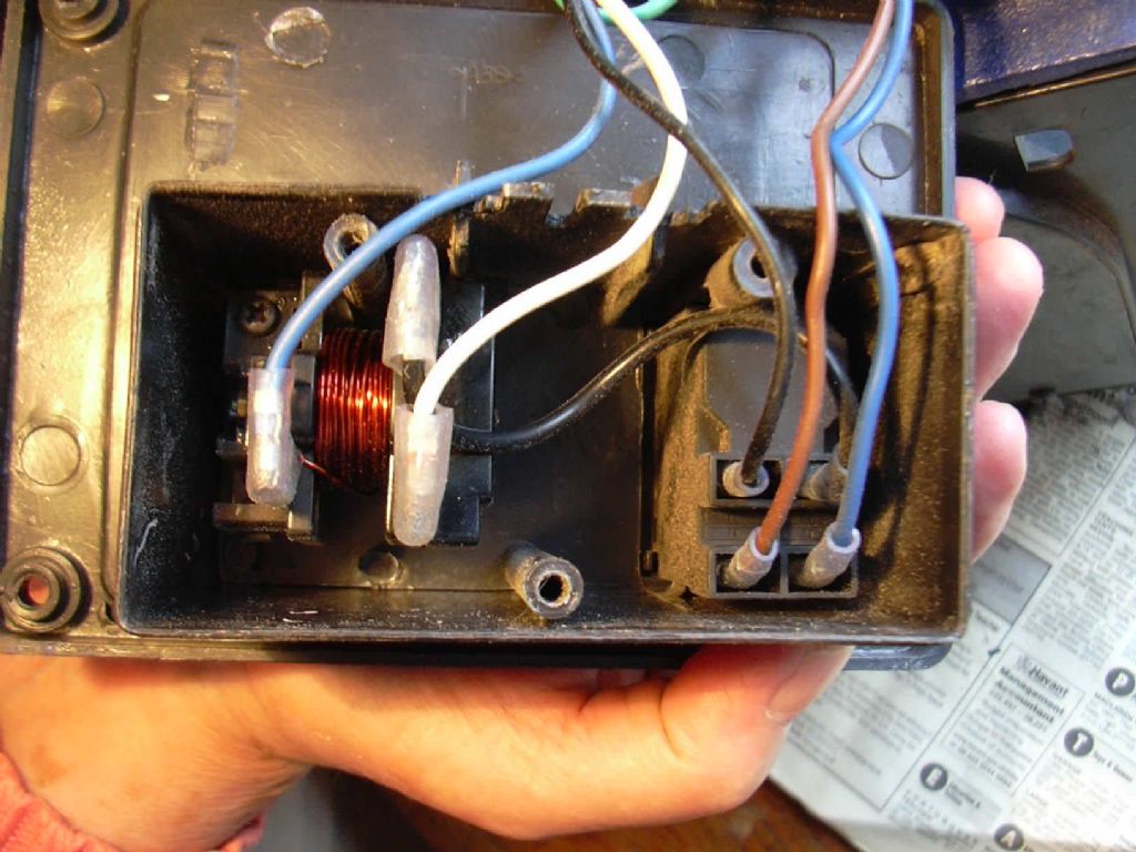

      I released the control panel from the sander body – here's a rear view:
      (The main object of this photo is to help me reconnect after the repair.)

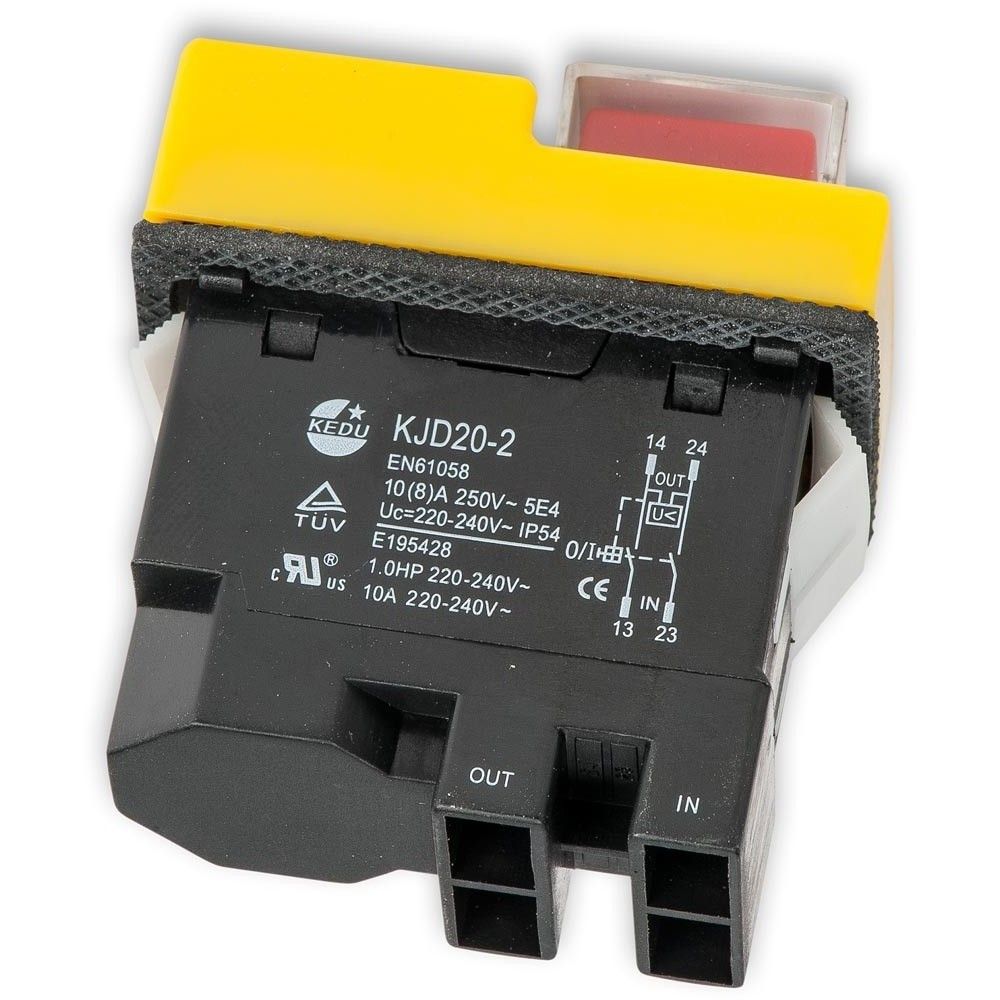

      The gizmo on the right is the NVR switch – here's another view of that:
      I've found a replacement NVR switch on the web and ordered one. The NVR switch is held in to the rectangular hole in the panel by two springy plastic tabs. Releasing these required liberal quantities of perseverance, tea and 'holding my mouth right'!
      The gizmo on the left is, I think, the starter relay. When the panel is mounted in the sander the connection on the left (blue wire) is uppermost. This is consistent with an arrow marked 'up' moulded into the relay body.
      Referring to Workshop Practice Volume 24, the motor in this sander appears to be the type with no centrifugal switch. The starter relay is operated by the initial inrush current and connects the starter winding. When the motor is up to speed, the current falls and the relay drops out, de-energising the starter winding.
      The motor, intriguingly, has eight connections! One of these is a ground, then there are three wires for 'run', 'start' & 'common'. The remaining four wires (two pairs) connect to TWO capacitors. I'll take a few more photos and upload them here soon. I'll return to this aspect in a later post.

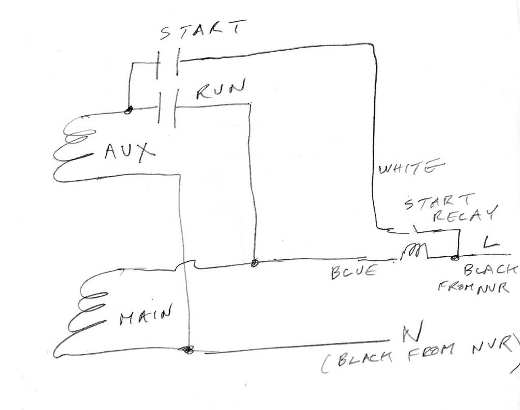

          I think it is most likely that the NVR switch is the cause of the problem. You can check this just by removing the wires from the out connectors and connecting a mains voltage bulb in their place. If the light goes out when the green button is released then it is the NVR switch that is faulty. I would not bother tracing the rest of the motor wiring at this stage as I cannot think of any way anything else could cause these symptoms.

              Hi Swarf,
              I think it could be wired something like this.

              Vic
                @vic
                The problem with Far East NVR switches is that they are made from some kind of soft copper for the contacts and hardened blancmange for the body. laugh

                      Posted by Les Jones 1 on 02/09/2016 17:27:46:
                      Hi Swarf,
                      Les.
                      Full marks, Les, I hadn't thought of that configuration. I'll buzz through the connections and check it out. One thing I don't like about the wiring of this device is that all the switching is on the neutral side rather then on the live.

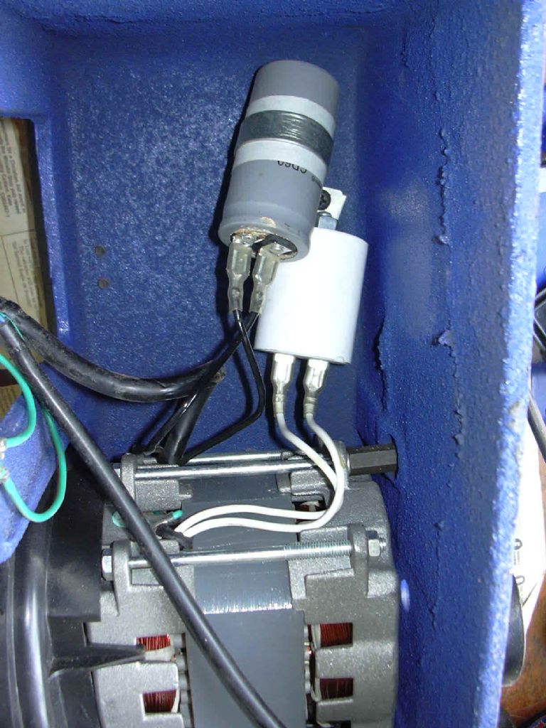

                            Here's a photograph of the interior of the sander showing the capacitors and part of the motor:

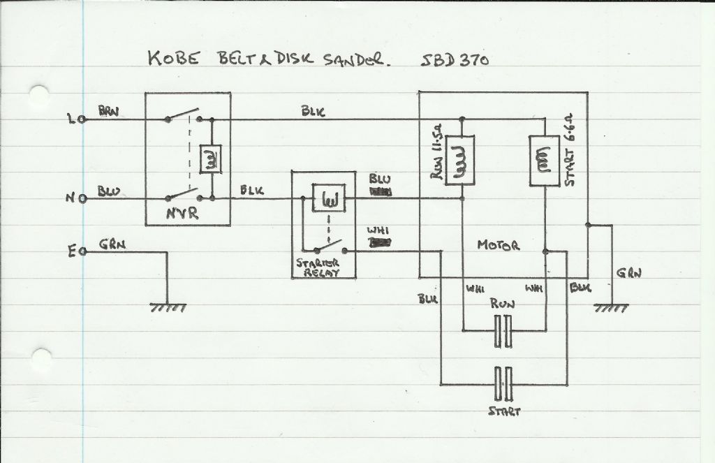

                            As promised, I've done a bit more circuit investigation. Here's the circuit as rendered by my tame drafting spider:
                            It's basically the same as suggested by Les except that I've shown how the capacitors are connected via junctions within the motor body. Also, as I mentioned in an earlier post, Kobe have opted to have all the complexity on the neutral side rather than the live (sorry, 'phase'! ) side. The capacitor mounting clips obscure the capacitor values and I didn't want to disturb them at this stage so their values remain a mystery for now. I have noted the motor winding resistances.
