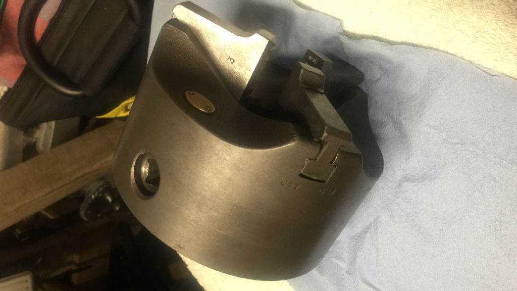

            And to hijack the thread, as is my wont, I've just cleaned up a Taylor 3 jaw which has a dished front face and strangely angled jaws which move closer to the back of the chuck as they close. Not seen anything like it before.
