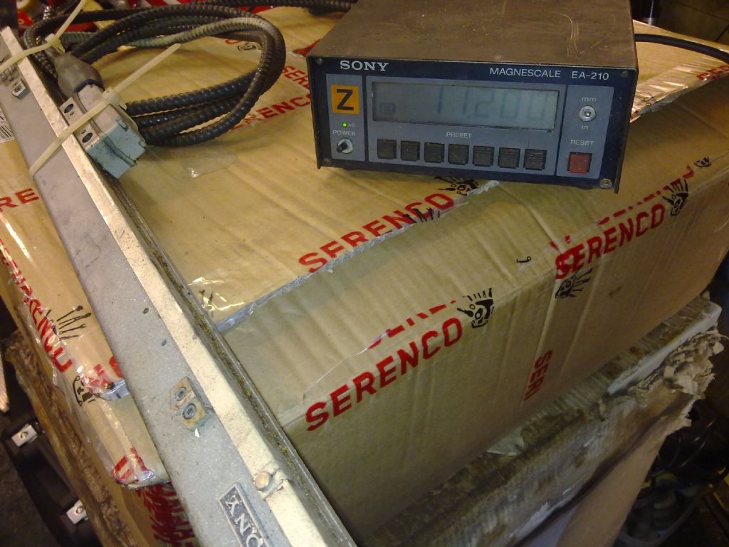

                                    Got out into the garage this morning & to my suprise found the single axis readout and scale I mentioned. Even more suprising was that when the scale was connected & mains applied it still works – it has been sat up in the garage loft for at least 15 years !
                                    I was also right about it being a "Magnascale", which means that it is a Sony device & not Mitutoyo, so no use for fault finding assistance in this case.
                                    Anybody have a requirement for an apparently functioning single axis readout with a 500 mm travel 0.005 mm resolution scale ? OTOH, maybe it could be used on the wheel downfeed axis of my surface grinder ….
                                    Nigel B.
