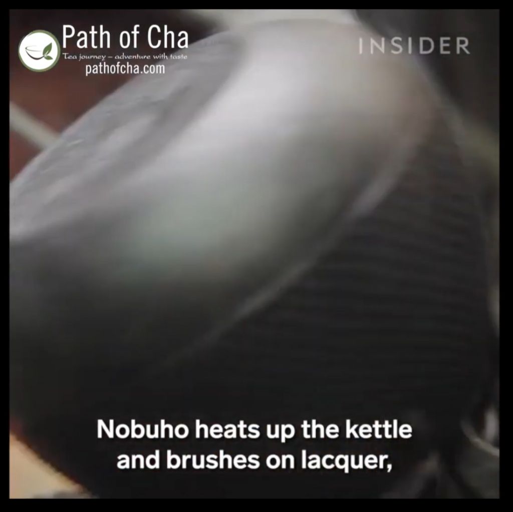

                              I wonder if the original was applies hot, such as in the production of these Japanese tea kettles; about 6 minutes in, though the whole video is worth watching
                              Though I did see this commercial video whilst I was wandering around the net as well
                              Bill
                              Edited By peak4 on 31/07/2023 21:31:53
                              #654643
                                Fascinating video, Bill … thanks for sharing it
                                Frustrating though, to hear only the word lacquer used in reference to whatever was dusted onto the hot metal
                                Edited By Michael Gilligan on 01/08/2023 07:59:31

                                        " Nobuho heats up the kettle and brushes the lacquer on "
                                        Anyone looking for an easy solution for a matching colour will almost certainly fail For centuries the japanese were the masters of decorative metalwork, and their knowledge probably extends to even a simple object like this bell. The wise words – that it is the most skilled work, by the most experienced, should be carefully considered. Oh sure you can find a cheap western alternative, but it will never match the original. Why would they give away their commercial secrets?

                                          Posted by david bennett 8 on 04/08/2023 23:15:37:
                                          Anyone looking for an easy solution for a matching colour will almost certainly fail For centuries the japanese were the masters of decorative metalwork, and their knowledge probably extends to even a simple object like this bell. …
                                          dave8
                                          Ancient craft-skills are unlikely to have been applied to a Replica bell sold in 1985, and probably still available new!
                                          I agree matching colour is difficult though. Repair Shop used to annoy me because it skipped over important details, but later programmes are more forthcoming. They would fix this with paint. They carefully prepare the surface, cleaning and making good, test various paint types to find the one that sticks best, and mix to get the correct colour, perhaps a range of near misses to improve blending. They make it look easy, but I think a good eye, steady hand, suitable brushes, experience and plenty of practice are needed. I noticed they often apply paint in much smaller quantities than I would, probably taking much longer to build up the effect than TV implies.
                                          I'd be very surprised to find the bell is made of Bronze, because it's expensive. More likely to be Brass in a replica, maybe something even cheaper like plated steel.
                                          Whatever, the patina will have been produced by dipping the item into a hot chemical mix, compounded to create the appearance of ancient Bronze in a few minutes.
                                          Several mixes could do the necessary, but we've no idea what the chemicals used were. It makes a difference – all acids react with Copper to produce green salts, but the greens aren't the same. The green produced by Vinegar on Copper, an Acetate, isn't the same as the Verdigris produced on Copper roofs by Carbon Dioxide, which is mostly a Carbonate. Paint is much more controllable.
