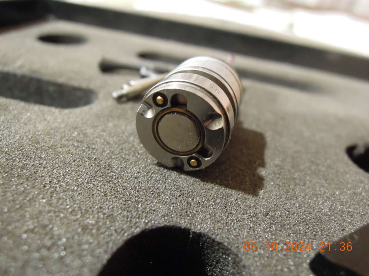

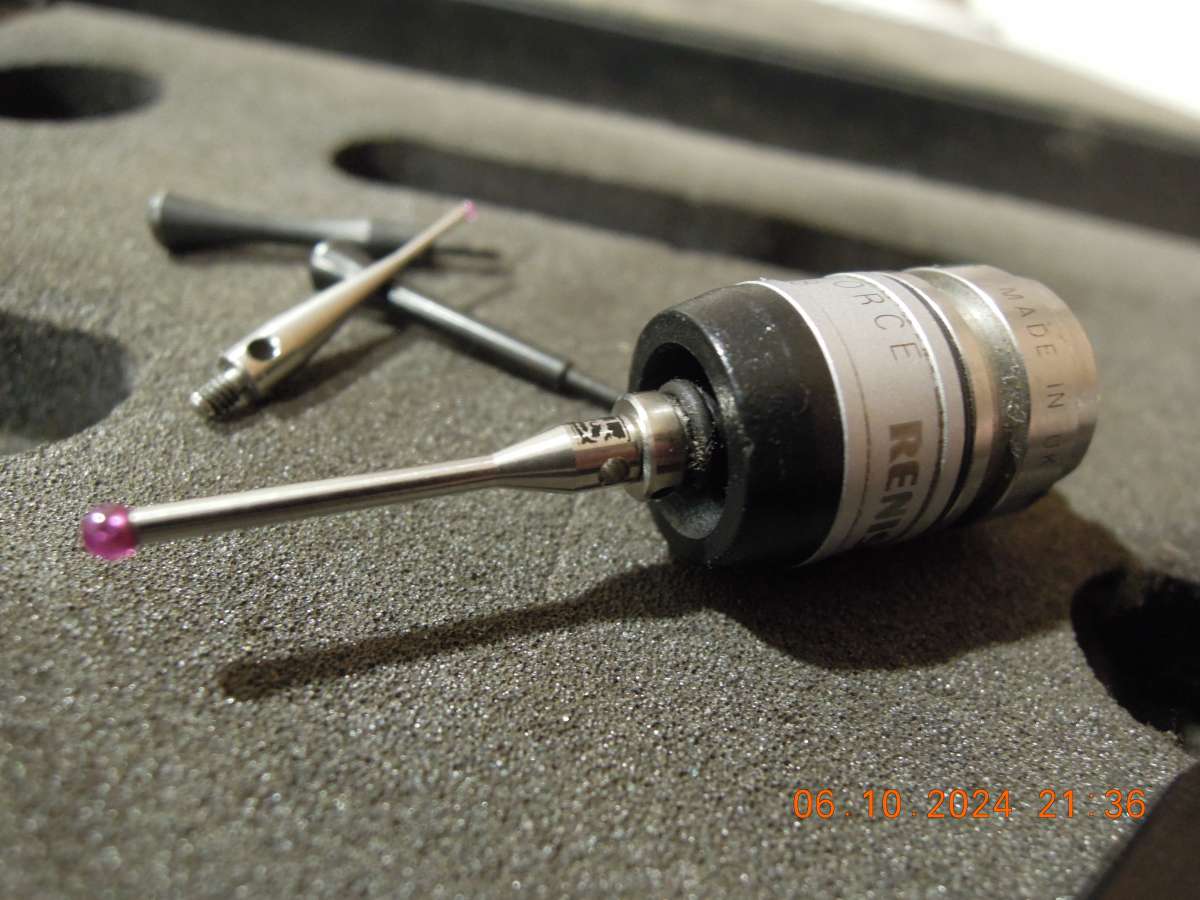

      I purchased some setting rings at an auction recently and the lot included a number of bits and pieces. One of these was a small box containing parts of a Renishaw TP20 touch probe from a CMM.DSCN1293
      DSCN1294
      I did think I would attempt to re-sell it but I’m wondering if I can make a edge-finder out of it. There are two small brass contacts on the upper face of the unit, which look like electrical contracts, but these seem to be open-circuit regardless of whether the probe tip is touched or not. So its either broken OR I have no idea what I’m doing!
      Can anyone advise me as to how this probe unit indicates to the CMM that its touched something? Reading the booklet in the box that the probe came in, the tip sensitive to 1/2 a micron deflection, so its a pretty clever device 🙂
      Gerry
      #757695
        Could be a strain gauge rather than resistive sensor?  The latter requires a voltage to be applied, and detects a current change on contact. Ohmmeter required.
        A strain gauge produces a voltage on contact, so I guess no external power needed unless it contains an amplifier.  Voltmeter required.
        Another guess: the resistance change and voltage produced are both tiny, requiring a sensitive multimeter or a scope to see what happens.  The electronics in a CMM are probably more sophisticated than a simple on-off switch detector.

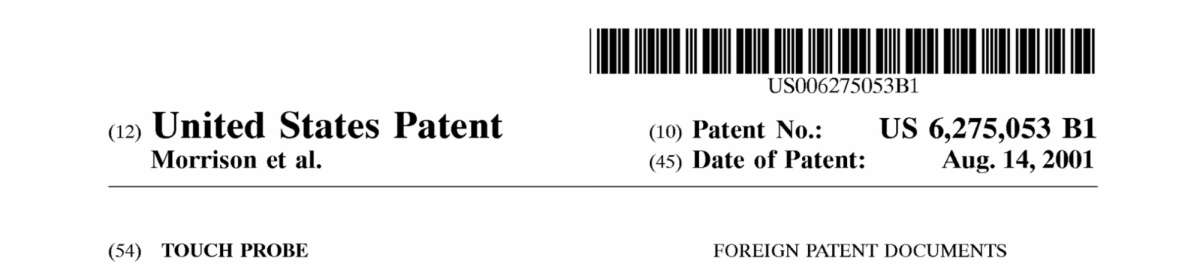

                216 patents of potential interest:
                https://worldwide.espacenet.com/patent/search/family/027516963/publication/US5505005A?q=nftxt%20%3D%20%22renishaw%22%20AND%20nftxt%20%3D%20%22touch%20probe%22
                Edit: Not sure if it is directly relevant to what you have, but this one is refreshingly ‘readable’

                    I missed the start of this thread. I’ve used these probes in custom machines.
                    They are closed circuit when undisplaced and open circuit when displaced in any direction. If this one is reading open when untouched it is faulty. This couls be due to mechanical displacement or damaged contacts. The contacts are not designed to carry any significant current or voltage but checking with an multimeter on Ohms is OK. Check to see if the probe looks and feels like it seating properly. Also check that the external surface of the rubber bellows is clean and undamaged. They are mounted to the CMM arm or CNC magnetically so that in a crash they are knoked off rather than damaged.
                    Robert.

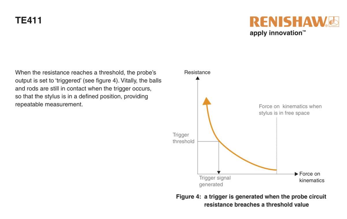

                          I spent a little while last night watching this:
                          https://youtu.be/m2D4iYep_pQ?feature=shared
                          which seems to point me in the right general direction … but your advice is always welcome.
                          Must admit, I was very impressed by Renishaw’s throw-away comment here:
                          IMG_0175

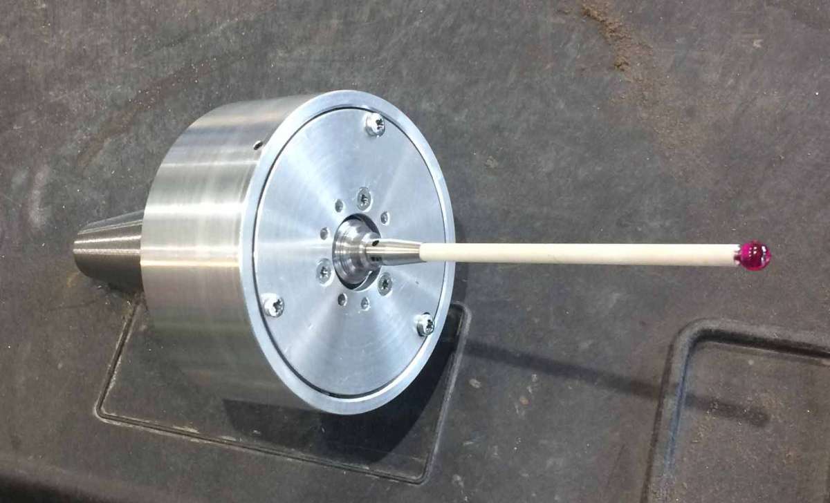

                                  I would love a proper Renshaw unit but couldn’t justify the cost. I ended up making my own.
                                  It works on the three pairs of ball bearings and a tri-lobe centre principle.
                                  I use it for location on my CNC mill via an ad-on wizard for Mach 3.
                                  It is surprisingly accurate for such a crude device.

                                    Les,
                                    Very nice. I’d be very interested to know how you cope with runout of the probe tip. Ignore, adjust mechanically, compensate electronically, etc. ? Do you get more accurate results than are obtainable with a wiggler or edge finder ? I appreciate that there are reasons other than accuracy for using such a probe.

                                          Chris,
                                          The actual probe tip is a Renshaw one, from a “source”.
                                          The whole centre is held on the three round head philips screws that you see. They are in over size holes to allow for a small amount of adjustment. Also there are three small hex grub screws in the outer rim to push the base about (you can see one of them). I set up the tool in the mill with a DTI against the ruby ball and fiddled about for best position until I got zero movement on the DTI.
                                          Then, in the wizard I use ( https://www.craftycnc.com/probe-it-wizard-mach3/ ), you can do a calibration routine based on a known round object. I used a large ballrace centre.
                                          The unit is then always placed in the same rotational position when probing.
                                          The wizard then allows many different shapes and edges/corners to be probed and fixed as a zero point for the start of an operation.
