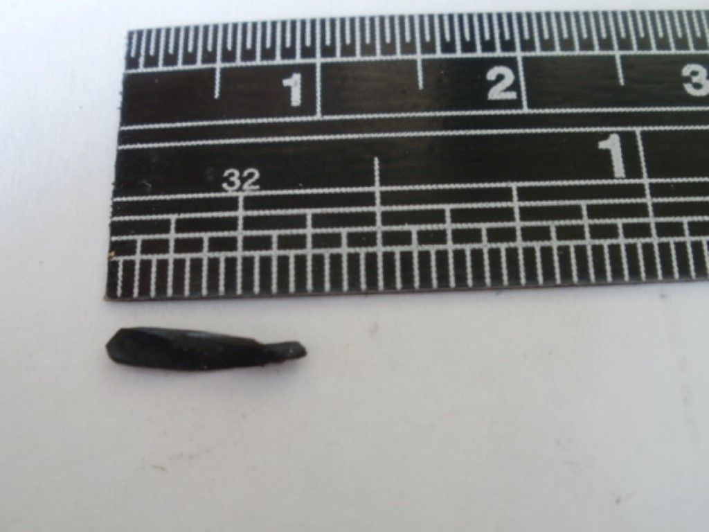

      John.

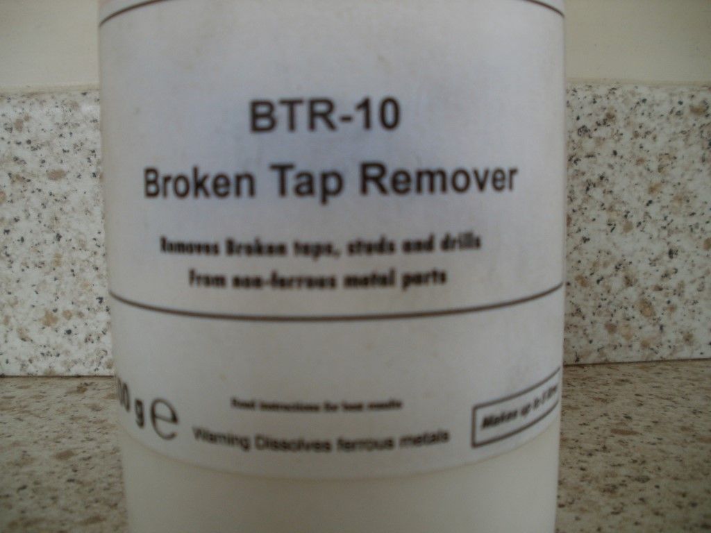

      Earlier this week I broke a No. 50 drill in a block of Aluminum . Some time ago I bought a product called BTR-10-broken tap remover, (Translunar technology Ltd , Bucks) it contains 33% aluminum sulphate.
      The instructions say to dissolve a quantity in water in a aluminum /glass container and simmer the part . It states no action occurs at a lower temp.
      After approx 1 hour enough of the drill had been dissolved and it just fell out.
      If you are close to Stoke On Trent you are welcome to borrow the solution.
