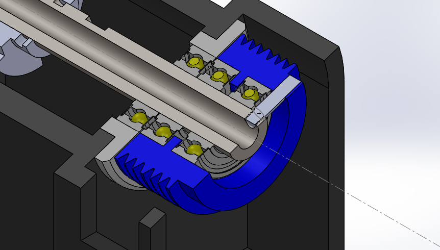

      So the page here says that to avoid belt pull issues the pulleys are put on ball bearings with a peg transferring the rotation to the spindle. Stops belt pull affecting accuracy/surface finish or something like that.
      Am I copying the concept right? There is just a peg going through a hole in the pulley to screw into the spindle. I am sure that Smart & Brown had their reason but I am looking at it and it just looks like a reinvented version of the keyway.
      #12826
      Rainbows
        @rainbows
        #269395
        David Jupp
          @davidjupp51506
          No – more complex than that. I have a S&B plain lathe and have replaced the bearings for the pulley cluster. The pulley is supported by 2 ball races from a central hollow sleeve. The sleeve is bolted to the end of the headstock.
          The spindle passes through the aforementioned hollow sleeve and runs in tapered bronze bush at nose end, and a matched pair of angular contact ball bearings at rear end to take thrust (at least on my own lathe). The 'peg' arrangement transfers drive from pulley to spindle.
          On the S&B, you can remove the spindle, yet still run the motor/belt as the pulley remains in place.
          #269416
          Rainbows
            @rainbows
            Oooh I had been misreading that sleeve as just floating on the spindle. Thanks a tonne.

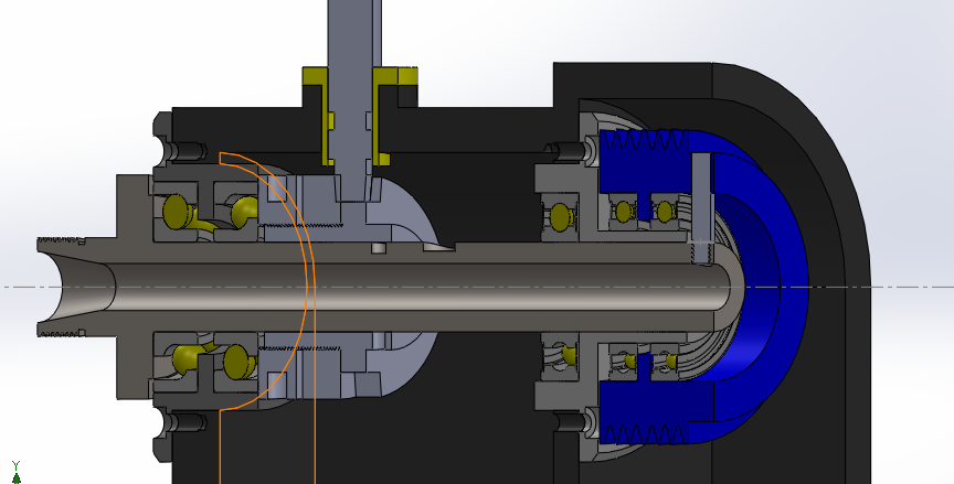

                          Rainbows
                            @rainbows
                            Redo!
                            Spindle will be going 4000rpm so gonna double up with poly vee and bearings.

                              Rainbows
                                @rainbows
                                Integral collet, no exploding chucks.
                                Tho I checked and bison cast iron chucks at 80mm work to 5000rpm
