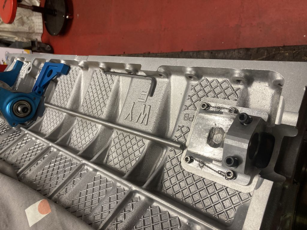

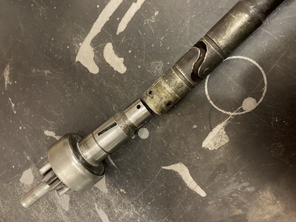

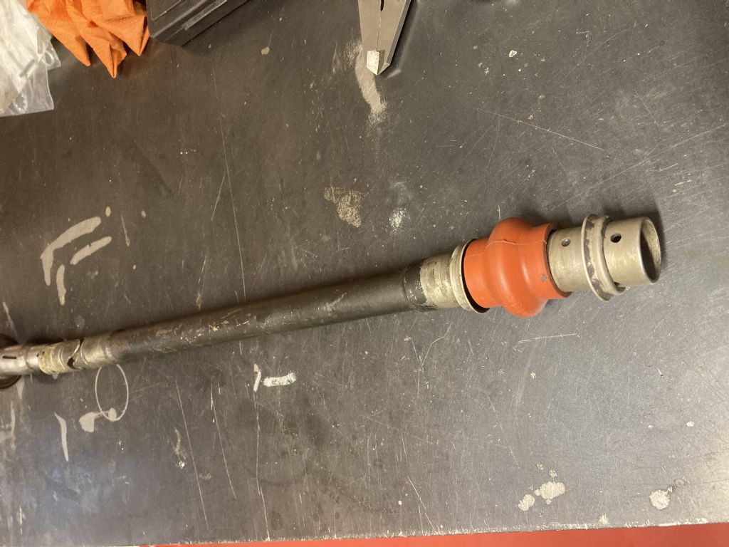

      I am currently involved in the restoration of the engine for a rare car from the early 1990's. The engine uses a remote start system where due to space limitations the starter motor is mounted some way from the rear of the engine. To enable the starter pinion to engage with the ring gear, this starter system uses a long shaft (almost 16" long) with two hook joints and also has a one way sprag clutch onto which the 10T ring gear pinion mounts.
      What I am looking for is a better hook joint than the current pin type system, the type I'm thinking of is the 'ball and claw' type often seen on machine tools (particularly table drives for milling machines ) as I believe this type does not have a very pronounced cyclic speed error.

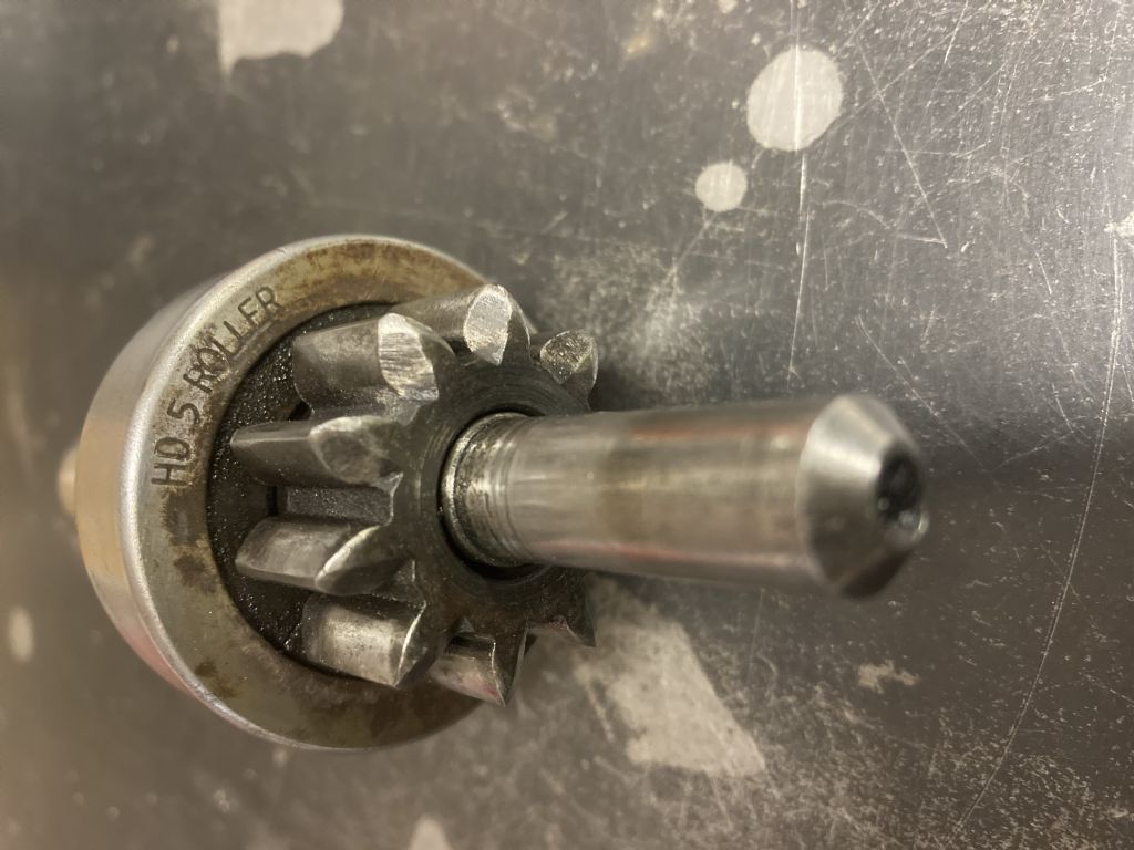

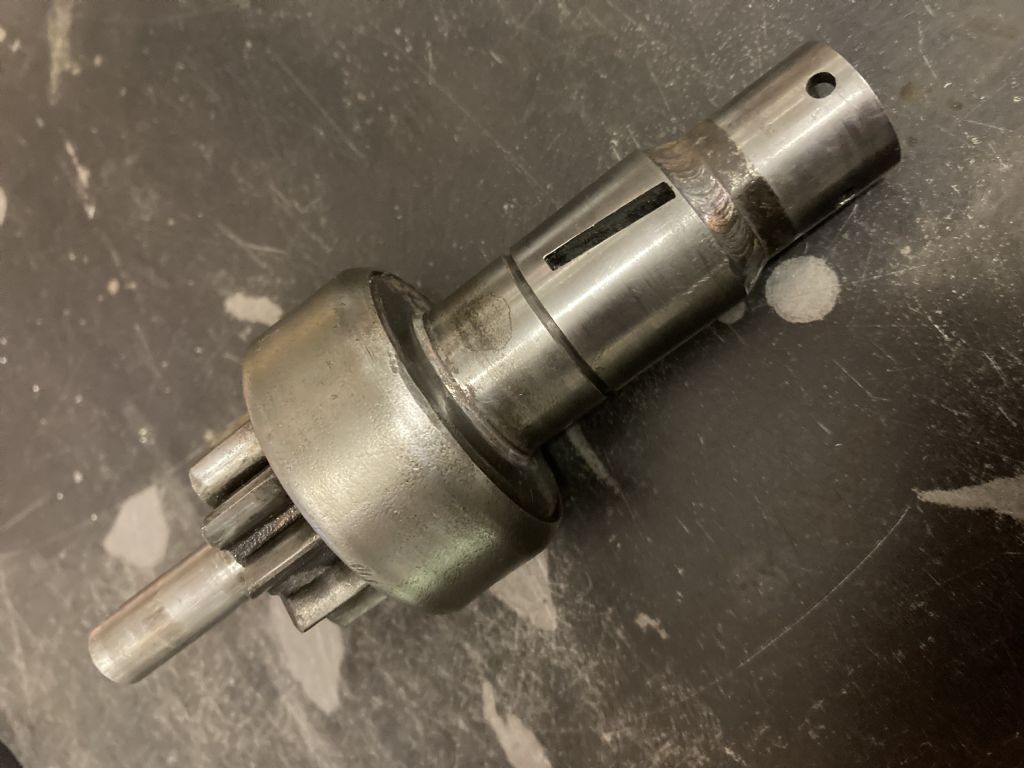

      The other item I'm looking for is a replacement for the drive sprag clutch into which the starter pinion fits. The motor operates by the usual Bendix gear which moves the pinion into mesh with the ring gear, but it would appear that the sprag clutch is there to protect against a 'backfire' which would (and does!) wreck the long drive shaft from the remote starter motor.
      Here are some pictures of the current parts:-
      img_0220.jpg Flywheel end of the system, shaft is 3/4" diameter.
      The sprag clutch with starter pinion mounted
      End view of the 'sprag' with the only markings on the component
      The end which connects to the remotely mounted starter motor
      A view down the length of the block showing the sprag clutch mount in the foreground and the starter motor (mounted by the blue anodised bracket ) in the rear area.
      Thanks for any help / assistance / suggestions / cups of tea / and sympathy offered.

          Any cyclic speed error, if I understand your pictures properly, will be minimal, and surely nothing to worry about. Any starter has its own cyclic variation because of the compression in each cylinder.
          As to the sprag clutch, I am at a loss to help. If the one you have has failed, there may be room to fit an alternative somewhere in the length – but this would require a firm attachment as the reaction on the clutch if there is a kick-back has to be accommodated. What jolly fun …

            If as you state the 10t pinion is mounted on the roller clutch then presumably when the pinion is thrown out of engagement with the flywheel gear the whole shaft (with its significant mass) has to move rather swiftly as well.

              Nothing to be concerned about re cyclic variation. You may find a suitable sprag clutch in an overdrive or an automatic gearbox, though these typically have a rather larger od.

                  A wide variety of sprag clutches is available from bearing suppliers. Usually identified by that number on the side. Ditto "Bendix gears" if the gear and clutch are made as one piece.
                  The sprag clutch will not protect against backfire as the backfire force is applied in the direction that makes the clutch engage even harder, just like hitting extra high compression in effect. The sprag clutch is usually so that when the engine starts and the flywheel revolves faster than the starter drive gear, the sprag clutch lets go and the starter motor is not over-speeded as a result.
                  In the absence of a spiral spline or solenoid to move the gear out of engagement with the flywheel ring gear, it looks like that gear is permanently engaged and so the sprag clutch is permanently in operation allowing it to free wheel, so wear on the sprag clutch internals will be fairly rapid. Norton used a similar system on their woeful electric start Commandos and suffered this problem. Nothing much you can do about it other than replace the sprag clutch at suitable intervals, or go to a whole different starter system that disengages the gear physically.

                    The shaft is more or less in line so the cyclic issue – no issue ! The sprag clutch is there to handle the overrun, not a kickback and looking at the shaft in front of the pinion I assume that is to allow the whole affair to drop back when the solenoid disengages, so yes it's pre engage ? The whole idea is not great, there are some very small hardy spicer type U/Js about but whether using them would improve things ? Since there is so little room I suspect they have used the biggest bit they could fit in ! Good luck, Noel

                      Virtually every rear wheel drive car and truck, etc has universal joints in the drive shaft and would have a slight cyclic speed error but does not cause a problem.

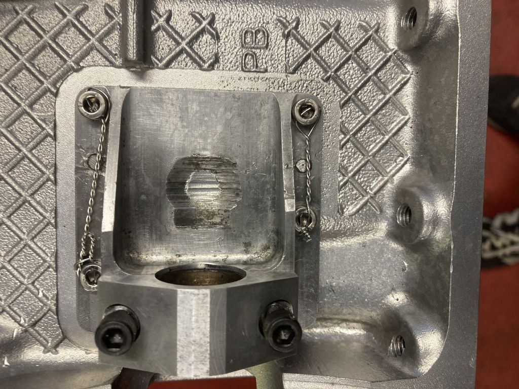

                          This engine is being restored after it had been 'mullered' by some unknowing mechanics when it was in Japan. The lower hook joint in the system had worn badly and damaged the bracket housing:-
                          The damage on the sprag support bracket caused by the lower hook joint.
                          The repair that had been done was that the 4 outer bolts had stripped the threads in the block and the answer they used was to put Nylok nuts on the inside of the block! (which meant the sump had to be removed to access the nuts ) not surprisingly the Nyloks (two of them ) were found lose in the sump when we stripped the engine!
                          We have now Helicoiled the threads and cross drilled and wirelocked the Allen screws. The dowels were also opened up to a larger size and are secured (by step drilling on the inside and by covering them with the lock wire run )

                          We have now identified a suitable sprag clutch arrangement which we can utilise (Reynolds Machine Tool division SO/SX series ) and we think we have found a suitable small hook joint system that has needle rollers. Available from WDS engineering supplies. But I'm still keen to find a UJ which has the ball and claw system. I am in contact with numerous ex colleagues at TWR, so I am getting assistance from their log books as well as my own, all helping to jog a 30 year old memory of these parts. The original UJ's were Dayton #20271 MTX – 5.771 DM. These we believe were American sourced and probably helicopter linkage parts.

                              I think the sprag Clutch is there so that if the pinion doese not disengage from the flywheel gear when the engine starts the whole shaft is not driven at some thousands of rpm (depending on the gear Ratio).

                                Likely that the sprag clutch is to protect the starter motor from over speed.
                                The pinion to ring gear ratio will be about 12 or 13:1.
                                The big CAV and Simms starters for Bus engines did not enjoy remaining engaged when the engine was running! They were not designed for 26,000 + rpm!
                                So being run at 100,000 rpm plus would not do the motor or couplings on your engine any good at all!

                                  What actually causes the damage to the bearing support bracket? If the pinion shaft carrying the Hooke joint is was well supported then the outer diameter of the Hooke joint would not be able to leave those score marks on the casting.

                                    The ring gear to starter ratio is 5.7:1 – this is because the flywheel / clutch assembly is a 5" diameter multi plate unit and the ring gear has just 57 teeth (starter pinion being a standard 10DP 10 tooth item ). It is therefore impossible to tuck the starter motor in close enough to the flywheel, hence the remote mounting of the SM.
                                    We have now sourced the parts which will allow us to replicate the original. I found a Ball & Claw UJ at a local Engineers Suppliers which was gathering dust on their shelves and it appears to be a far more robust item than the cross pinned Hook(e) joint [Thanks Ian for reminding me of the correct spelling of that]. The new UJ is very slightly heavier than the original (+ 25grm ) but the mass of the system is low as the shafts are High Tensile tubes not solid shafts. This keeps the mass of the connection low to allow the rotational and for and aft movements.
