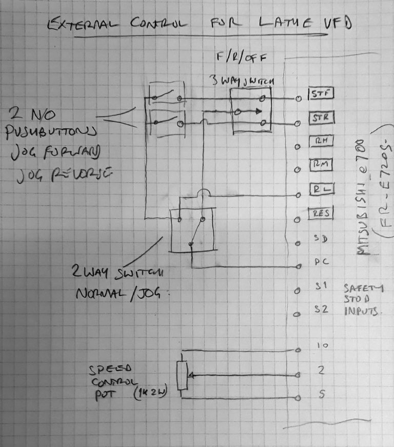

      After using my Boxford with the original 3 phase controls for a while I converted it to single phase with a Mitsubishi VFD and have been controlling it with a little remote parameter setting unit ever since. The remote unit duplicates the controls on the front of the VFD and has tiny buttons so not ideal but has helped crystalize ideas of how I want controls to work. Main thing is I want to go back to a 3 way forward/off/reverse switch for the normal running but I want to have a push button controlled jog function. I think this should work ok and have worked out a wiring scheme shown here. On the Mitsubishi the jog function trigger can be assigned to several different terminals, I'm using RL here. I have the Mitsubishi manual and I think I can set all the parameters I need to get this to work, the thing I can't figure out is how to arrange safety stops. This needs to do two things:
      1. Provide an "panic button" emergency stop.
      2. Hook up the various interlocks to prevent running with covers open.
      I think it should be possible to use the Safety Stop (S1 7 S2) terminals to do this but the manual only seems to describe using this with a "safety relay module". I think that a simple continuity circuit across these terminals will do the job but it also needs a reset function to prevent it restarting when offending door is closed if the run switch is left on – this is because the logic of the unit will be set to work with an "always on" signal to the start terminal (STF or STR). I hope there is a parameter setting to do this but haven't found it yet.
      Have any Mitsubishi users out there any ideas about how best to achieve this?
      Thanks, William.

          You could use a 24V no-volt release start / E-Stop module. These a re cheap enough. Arrange the guard switch(es) to drop out the no volt coil and one contact to the VFD.
          Robert G8RPI.

              Posted by Robert Atkinson 2 on 07/04/2021 12:59:26:
              If you mean a 240v NVR on the mains input to the inverter then I'm reluctant to do that because as I understand it it is bad practice (ie likely to damage the VFD) to stop it by cutting power on the input side.
              I expect some external arrangement of switches and relays could work but I'm hoping that a simple continuity loop through S1 and or S2 will do the job if I can find the correct parameters to prevent restart when continuity is restored.

                Ok, just had an illuminating conversation with a chap at Inverter Drive Supermarket. By default the two safety channels, S1 & S2, are shorted to PC (24volts). Any interruption to that voltage on either of them will cause the VFD to trip and immediately cut output power (I think it can also be programmed to apply an emergency brake to whatever machine it is powering) once tripped it will need a reset before it will power up again. I haven't quite figured out the reset circuit yet but I'm going to experiment with the basic continuity loop idea. Obviously this could include any number of door switches, interlocks and big red buttons.

                  I had a quick look at the Mitsubishi manual for the FR E729S inverter. The wiring diagram shows details of the safety circuits which show dual inputs S1 and S2 for the safety stop. It is intended that each device in the safety system should be provided with two electrically independent contacts ( closed when safe and open when unsafe ). Each circuit ( PC to S1 and PC to S2 ) should contain one of the dual contacts in each circuit. The intention is that there is two identical safety circuits which normally operate together hence giving two chances of a safe stop – operating only one circuit ( such as in the case of a mechanical failure ) causes a lock-out until both circuits are opened.
                  PLEASE, PLEASE make sure that the principles are adhered to – they are there to keep us safe ( even if they are a little more difficult to understand and implement ).

                    So should I be duplicating the circuit and use double pole switches or is it more complicated than that?

                      No ,
                      Meant a 24V NVR, powered from the PC terminal and contacts to the safety circuit.
                      Addressing Bobs comment, while using dual circuit stops is best practice, it depends on the machine. A Failure Modes & Effects Analysis (FMEA) would be carried out and severity of failures addressed. The level of protection will depend on the hazards and use. For a non CNC lathe or mill used by a skilled operator a dual circuit protection system would not normally be required. If you did a safety analysis on a chain saw as a new invention it would never be allowed!.
                      One particular failure mode of most E-Stops is that the switch module fits on the back of the button assembly and it's actuator has to be pressed to open the contacts and stop the machine. If the switch block is not fitted or falls off for some reason the E-stop wont work, dual circuit or not. The only mitigation for this is testing the E-Stop, but the switch block could drop off as you reset it. I've looked for a fail-safe E-Stop but never found one.

                          Inverters are a complexed, software controlled motor drives. As such, we must understand that the drive may fail either without any power to the motor or with full power to the motor ( or anywhere in between ). Since the inverter is under software control, either failure mode is possible and the standard Start, Stop, Forward an Reverse controls which also pass via the software may become inoperable. To prevent unsafe situations, safe shutdown inputs are sometimes provided, generally preventing the output stage of the inverter from driving the motor, preventing power transfer by disabling the output devices.
                          So, lets look at the safety issues surrounding inverters on machinery :
                          • Your lathe motor is directly connected to the lathe chuck via a system of belts, pulleys, gears and shafts, therefore any unexpected starting of the motor will result in potentially dangerous rotation of the chuck – imagine should the chuck start turning whilst using the chuck key – potential injuries could result in loss of fingers, hands or even arms.
                          • Equally, un-safe opening of change-wheel guards etc. also exposes the user to similar hazards should the motor start without warning.
                          According to the diagram posted by William, he is expecting to find door switches and an external Emergency Stop fitted to his machine.
                          The reason for the provision of two parallel safety circuits ( PC to S1 and PC to S2 ) is to reduce the affects of potential failures in the safety circuits – i.e. there are two chances of detecting a failure rather than one therefore the door switches and Emergency Stop should form part of these twin parallel circuits.
                          OK, so lets look at the requirement for safety switches on machinery :
                          • Safety switches should have two independent electrical circuits ( one for each safety loop ),
                          • Safety switches should be forcibly disconnected when the guard is opened ( or Emergency Stop pressed ). This ensures that the contacts of the safety switch are forcibly opened even if the switch contacts were welded closed due to a fault.
                          • Doors should be fitted with a 'tongue in the slot' type safety switch or a suitable mechanical cam to force operate a roller type limit switch. Note that the limit switch must be a safety type switch and that micro-switches generally do not conform to the safety requirements.
                          • Emergency stop switches manufactured and CE marked ( yes we know the Europe issues and the comments about China Export markings ) by reputable manufacturers will provide dual safe contacts.
                          • Safe operated switches providing two electrical circuits may still fail because their fixings may come loose allowing the switch to fail to operate. This is the subject of another whole massive set of legislation.
                          Finally, one should provide two identical loops from PC to S1 and PC to S2 ( this is the reason that the drive manufacturer provides two terminals ) – looping the two safety inputs together defeats the purpose.
                          One final note regarding the safety circuits, the inverter should not re-start after the safety circuits are completed following a safety stop but must be provided with a manual method of re-starting i.e. a Reset pushbutton or maybe the Start button to be pressed again.
                          Finally, to address Robert Atkinson 2's comment regarding the integrity of Emergency Stop switches, it is generally accepted that designers of industrial control systems will incorporate a suitable monitoring relay which is specifically designed to detect such faults ( and many others ). The Mitsubishi manual details such a system a few pages on from the normal connection drawing.
                          Sorry to drag this out, but our safety is of the utmost importance.

                                Download the instruction manual from :
                                https://gb3a.mitsubishielectric.com/fa/en/dl/8113/M_FR-E700SC_A_UK.pdf.
                                On page 3-14 is a table showing the control circuit specifications for input circuits. The bottom two lines detail the requirements for the control of Safety Stop S1 and S2.
                                Quote :
                                " S1/S2 are safe stop signals for use with in conjunction with an approved external safety unit. Both S1/S2 must be used in dual channel form. etc… "
                                Page 3-24 provides the manufacturers suggested method of connection of the 'approved external safety unit ' in fig. 3-15 ( other 'approved external safety units ' are available from other manufacturers ).
                                Since the manufacturers specifically state that "S1/S2 are safe stop signals for use with in conjunction with an approved external safety unit", it would appear that the drive does not have the capability to perform the dual channel integrity checking.
