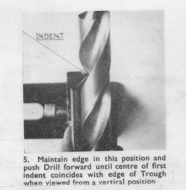

        Andy, it's a LONG time since I used the Reliance – now have a Quorn – so I offer that as an excuse if the following is irrelevant.
        I've been thinking about this "mark" on the trough and it led me back to the link you were sent in 2018 to the Reliance, 2-sided instruction sheet.
        It appears that from the instruction sheet version I have, a reference to "the mark" when first setting the drill to be sharpened is absent. On my sheet, this image below seems to be the scant info on how to set the drill's radial position in the trough once this previous instruction is completed > "PLACE DRILL IN TROUGH AND ROTATE DRILL UNTIL LOWER CUTTING EDGE OF DRILL ASSUMES A VERTICAL POSITION"
        Then……
        Reference there to "indent" I take to mean – from the photo – the twist drill's spiral. In fact there's no reference to any mark on the front of the trough.
        My instruction sheet shows there were 3 sizes of Reliance DGJ marketed 1/8 to 1/2", 1/4 to 1", 1/4 to 2". The images show sharpening a taper drill > 1/2" so it may well be that this infamous mark only appeared on the smallest jig.
        If you wish I'll email you a high res copy of my instruction sheet – send me a PM.

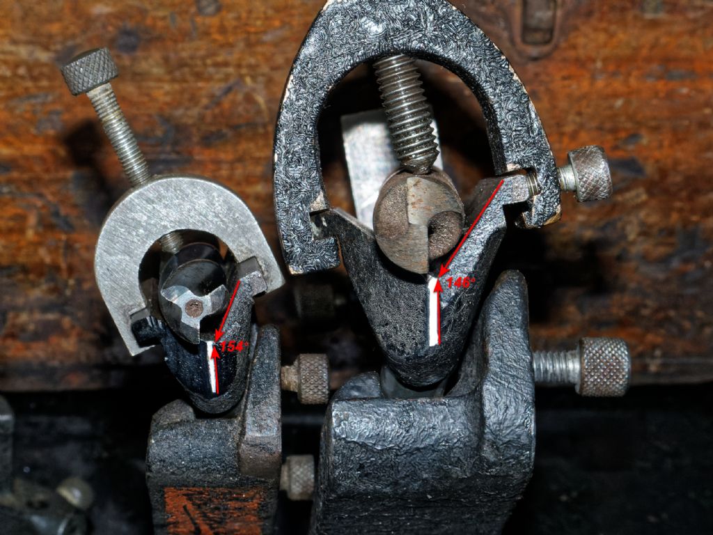

          Here you go folk, I've just been playing with the camera, some Tippex and a black paint marker.
          N.B. I've not set the correct drill projection for the diameter, for depth of field reasons, but you get the idea.
          The No1 jig for up to ½" seems to have the line at a slightly different angle, but it's all a bit hard to tell, as the castings are rough and the corner is cut off at a different angle as well.
          The No2 is easier to measure, as rather than just a line, there is a definite step in the casting.
          Yes I know I've not quite got the core drill lined up correctly.
          When in use, I've actually got a bit of aluminium angle with a flat along the outer corner.
          This means I can clamp down along the flutes, rather than just having a point contact as shown here.
          I picked these two drill bits as they contrasted better than newly sharpened ones
          Some of the parts really weren't that precisely made; e.g. the clamping arrangement on the No2

            As I see it the picture implies that a thin sharp edge, such as a razor bled, placed vertically on the end of the trough should contact both the spiral lands when the drill is pushed forwards to the correct position.
            If that is the case the narrow slot, rather than engraved line, described by Roy would be a pretty effective optical gauge to help set things by eye. Basically look down from above the drill and the outer edge of the slot should be just visible past the two edges of the spiral lands.

              Thank you all gents. The tippex and end-on shot helps a lot.
              #608713
              peak4
                @peak4
                Posted by Andy Carlson on 07/08/2022 23:12:35:
                No problem, on my No.1 in the photo, there is a defined angle on the casting, just behind the vertical red arrow.
                The white line just to the left of it was scribed by something sharply pointed, maybe 1.5mm away from the corner but parallel to it.
                I've just deepened it slightly with a knife edged needle file, filled in the groove with Tippex and enhance the black crackle finish around the edge a bit.
                There is no actual scribed line on the No.2. but a step in the casting, which effectively makes a line where it intersects with the cut off corner.
                That third photo on Tony's site would appear to be of the  rarer one, just smaller than the No3 jig, the big one, as it also has the additional Y shaped middle drill support, so the front is obviously a lot larger; as such I suspect those lines are intentionally milled in.
