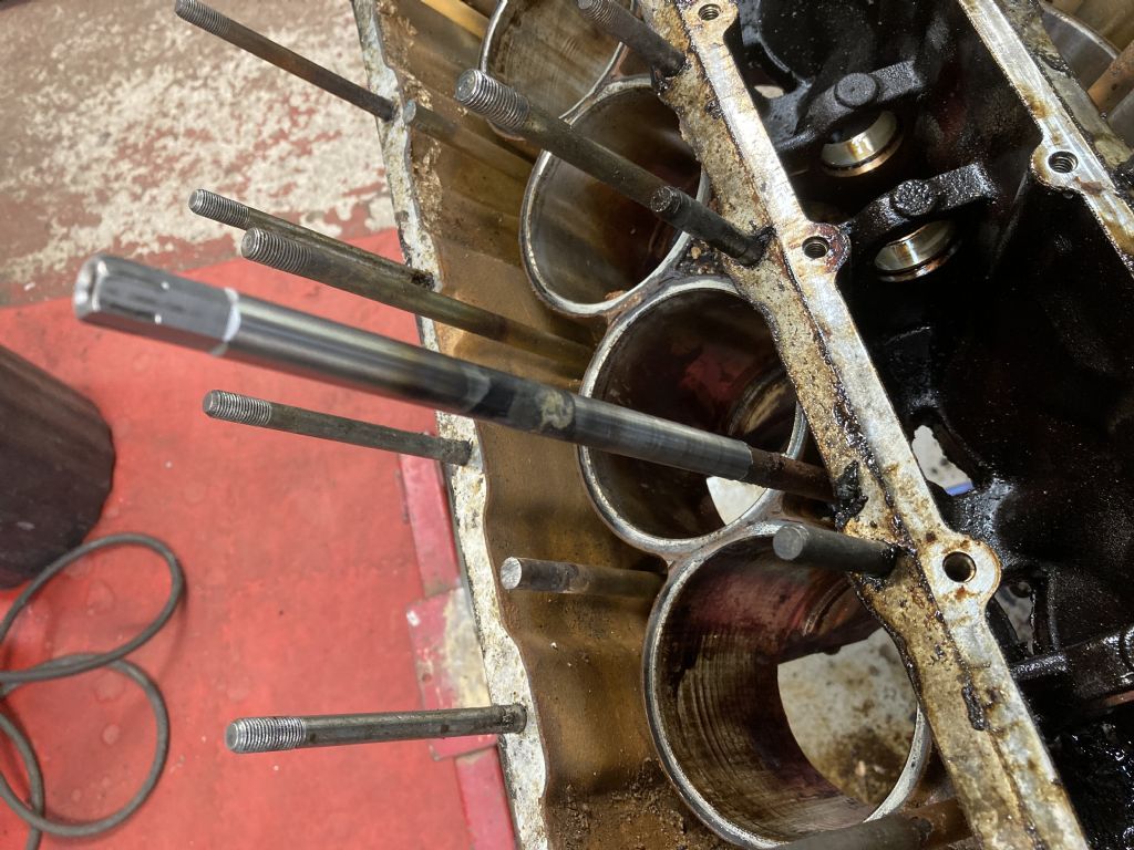

      One of the problems of working on older IC engines is in removing the cylinder head where a steel stud passes through the head casting. There is a heavy tendency for the stud to corrode through galvanic action and this is not helped by the seepage of coolant into the stud passageway.
      Recently we were removing a head from a Jaguar V12 engine and had to resort to sawing through 4 of the 14 studs on one of the cylinder banks when the head refused to lift more than an inch or so. We have at our disposal a 'head puller' which consists of two one inch thick steel plates which bolt onto the head in place of the cam carrier and this then uses rods to press down on the exposed stud ends, thereby lifting the head away from the cylinder block.
      Thinking back to my time working at Triumph Cars we had similar problems with the Triumph Slant 4 and V8 Stag engines and I remembered one of the fitters made a tube saw which went over the stud and into the stud hole in the casting to remove the corrosion.
      This led me to make a stud 'tube saw' which was made from a 12mm silver steel bar with a 7/16" hole drilled up it – leaving a ~0.5mm wall thickness! After re-sharpening the teeth several times we eventually cut through the crud on all 14 studs on the other cylinder bank and the head released easily.
      I am now considering making another tool from a higher grade of tool steel (D2?) and also considering a diamond plating on the tip of the saw to replace the tooth form.
      My question is – has anyone knowledge of a company that can diamond plate a tool? Is there any known supplier of D2 tool steel in tube form (it doesn't have to be exact sizes as we can machine to finish size )?

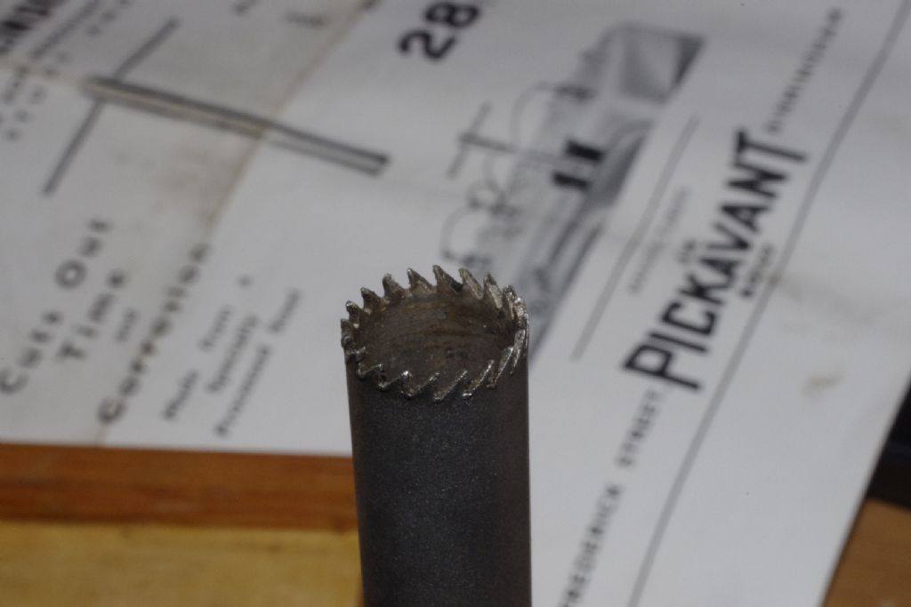

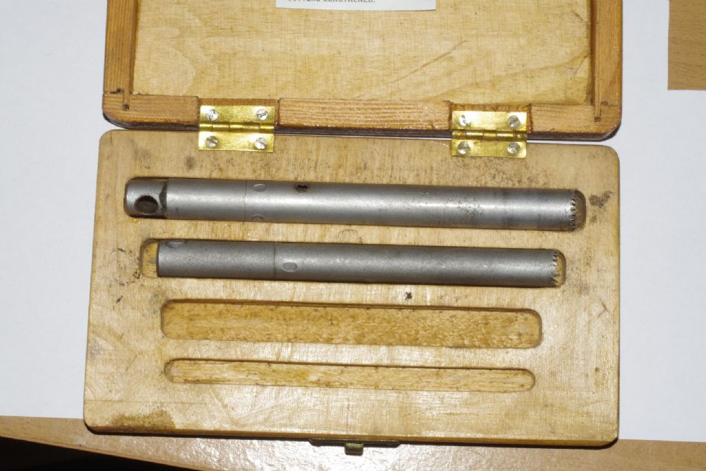

                  When the museum inherited the workshop and tools a couple of years ago, there was a wallet of Pickavant tubular saws of several different sizes made to remove the corrosion products from between cylinder heads and the studs from the block. They are very thin wall, to pass over 3/8", 7/16", 1/2" 9/16" and 5/8" studs. I had never heard of them but they do seem a very good idea.

                              _igp2892.jpg_igp2893.jpg_igp2894.jpgI remembered some of the details of the tubular cutters. We only have the 7/16" and 1/2", the 3/8" is missing. The 7/16" has a bore of 0.442", od of 0.5" and the doameter at the tips of the teeth is about 0.513". The effective length is 2.95".

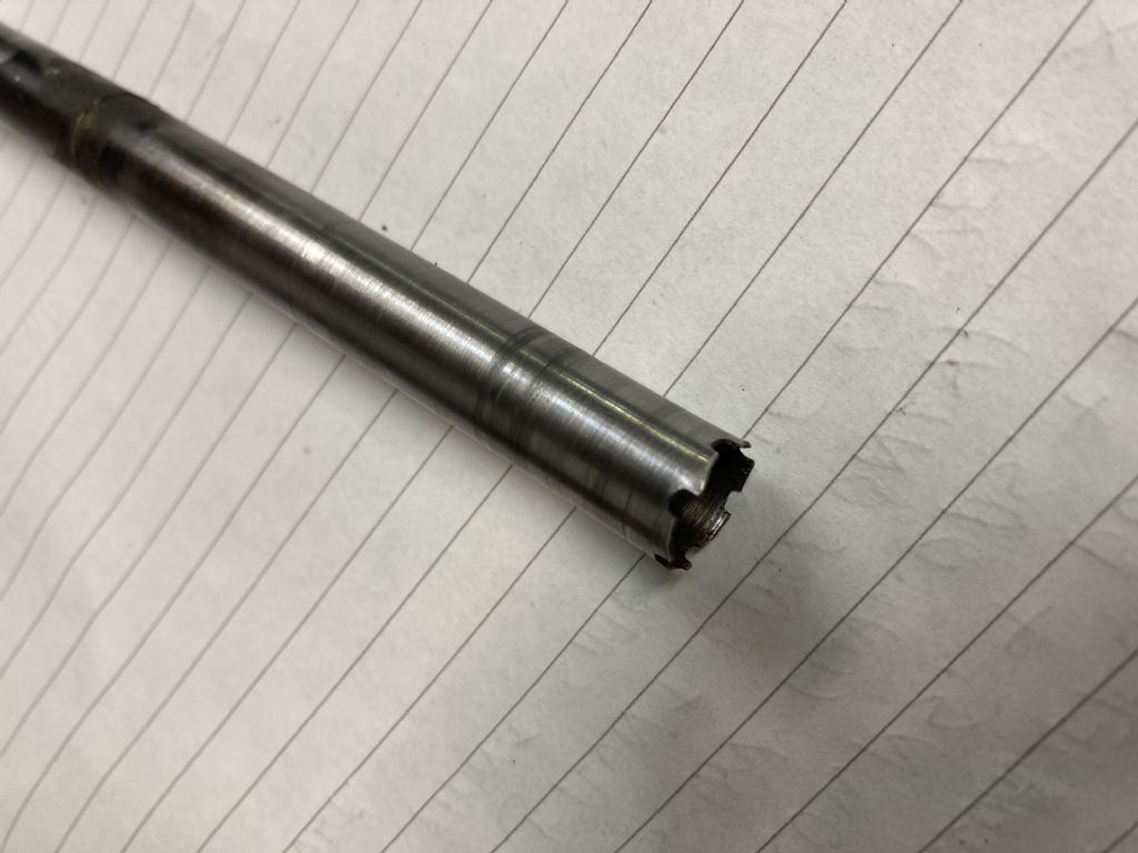

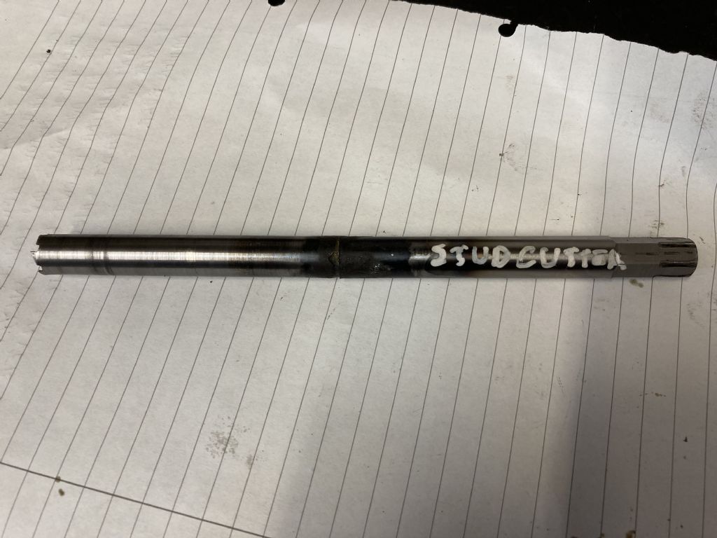

                                      OM – That SP tool looks just like mine! the saw has to go over 4" through the head and it is impossible to seal it against water (coolant) as the lower end of the stud is within the block waterways.
                                      Here is a picture of the tool and the job it did:-
                                      It broke during use at the point where the 7/16th" drill ended, so we silver soldered it back together after turning a register on the solid part of the shank. The teeth were reground about 4 times on a Clarkson T&C grinder, so it finished up about an inch shorter than it started out.
                                      This is a picture of the block with two of the sawn studs showing (this is 'A' Bank – we didn't have to cut any studs on 'B' bank after using the saw ). We used penetrating oil, acid, heating and cooling – all to no avail. As you can see the studs 'live' in with the coolant which doesn't help matters any!
