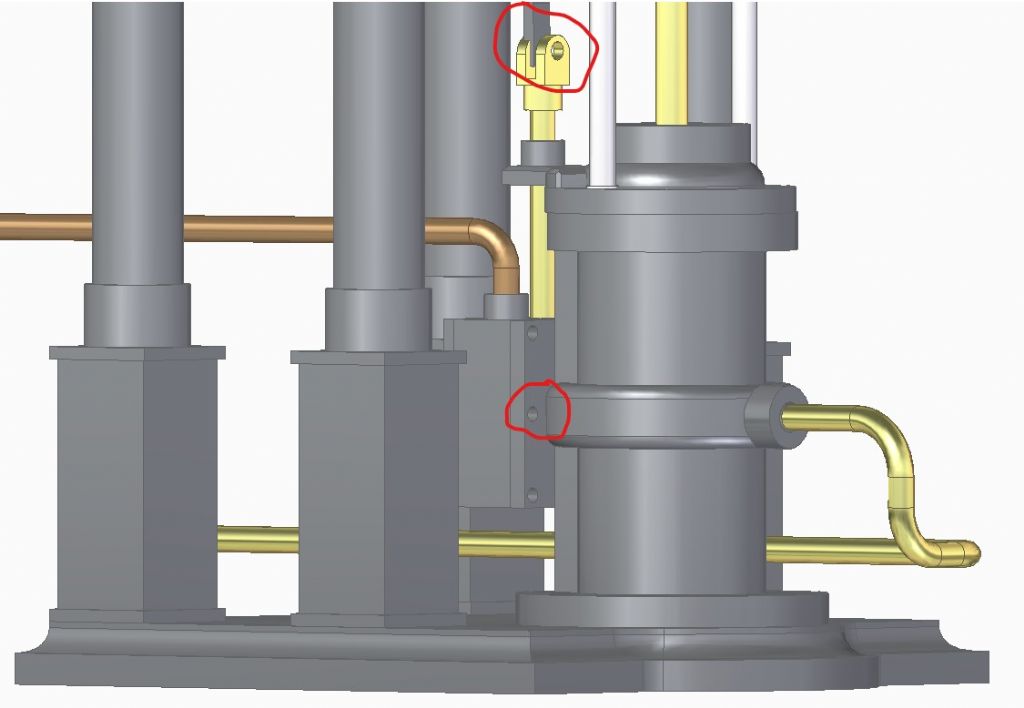

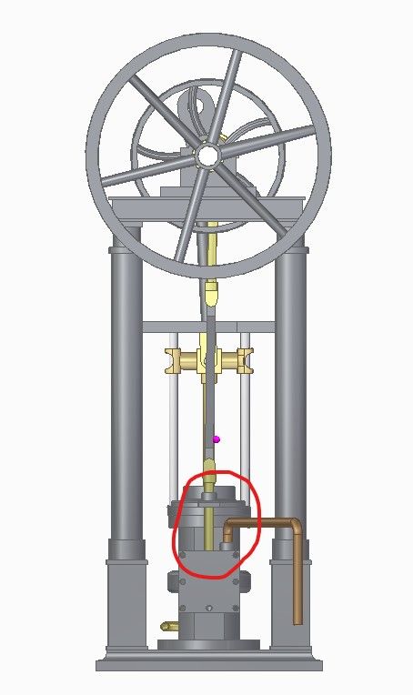

            More progress with Soiid Edge and the model:
            • added a guide for the valve rod using 'Create Part in Place', which is a very helpful technique allowing new parts to be defined on an Assembly. No need to remember things like flange diameters, PCDs, and bolt hole positions. I don't think Fusion has it and FreeCAD certainly doesn't.
            • used 'Create Part in Place' to add and position the D slide inside the valve box so the eccentric movements open and close the ports correctly.
            • added a steam input to the valve box and two pipe runs for steam feed and exhaust. Pipe runs travel awkwardly around and inside the model and can be a lot of work to define in 2D. Solid Edge's 3D sketch tool simplifies the job. (After how it works is understood!)
            Then inspected the model for faults, missing features, improvements and misalignments.
            Found a few, ringed in red:
            • Bolt hole forgotten in the valve-box cover. (Unlike the other cover holes this one can't be drilled through because it would cut the valve-rod. I meant to come back to making a shallow hole and didn't.)
            • A small problem is with the middle cover holes in the valve-box. They emerge on the cylinder side close to the exhaust belt, which would make assembly of the real model a little inconvenient. I'll probably leave it!
            • The strap connecting the valve rod to the eccentric is misaligned because I got the bend angle slightly wrong. This can be corrected when I make a planned change and take the strap much closer to the eccentric hoop.
            Now I've cracked pipes a new trip will be adding a throttle valve. As PatJ said, this stuff is addictive…
            #599771
              Dave you should not need to worry about that central pair of valve chest holes, studs would have been screwed into then from the valve side so no need to get to the back of them. A little more thickness to the port face would not go amiss then the studs can go into blind holes.
              Your six holes are rather close to the edge/corners.
              I was in two minds whether to add a valve to mine but did not in the end as I would have just left it open anyway and used my manifold to control air flow

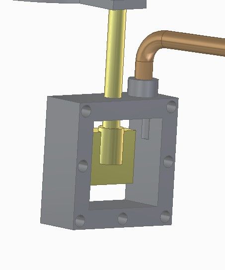

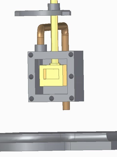

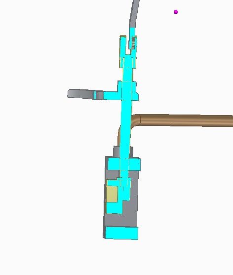

              #599789
                Thanks Jason.
                Looking at the too close holes got me worrying about the D-slide valve. May I pick your brains on that too please?
                From the front:
                Rear:
                Section:
                So, there's nothing holding the slide valve flat against the face apart from steam pressure and the valve rod. One way of fixing it would be to extend the back of the valve so it rubs against the cover, which is more weight and friction, Therefore I'm wondering about putting a couple of rounded end screw adjusters through the back of the rear cover that could be tweaked to press the slide against the port face. Works mechanically, but liable to leak I feel. How is yours done?
                And worrying about leaks, I've noticed there's no stuffing box on the valve rod or cylinder top! Back to the drawing board!
                Ta,
                Edited By SillyOldDuffer on 29/05/2022 11:50:09

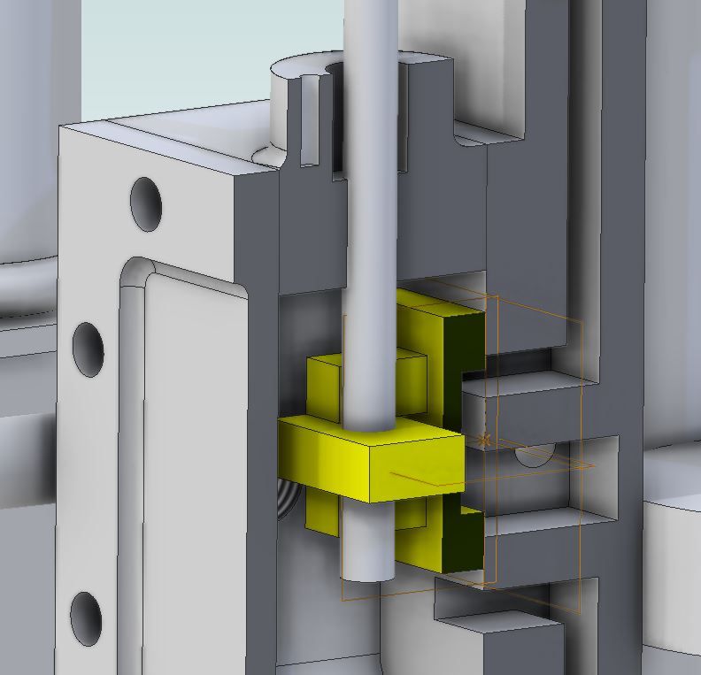

                #599797
                  Generally you don't need to hold the valve against the portface, as you say steam does that. Some designs have a small flat bronze spring but the majority have nothing.
                  What you do need is an allowance for the valve to lift off the port face should you get a build up of condensate in the cylinder then the valve will lift and let it out. On a lot of models the valve has a slot for a rectangular nut, the slot being a bit deeper than the nut. here's a section through the engine with nut and Valve rod not sectioned, you should be able to make out that the nut does not touch the back of thevalve
                  #599812
                    Thanks Jason. I was in danger of overthinking model slide valves:
                    • friction: how much power is needed to operate a slide valve? Considerable I suspect.
                    • material: cast-iron for low friction.
                    • reduced contact area for low friction versus increased leakage
                    • pressure: what's the effective steam pressure on the valve? (Pressure on the boiler side less exhaust pressure from the cylinder.)
                    • Lead and lap
                    • lubrication
                    Notice my list doesn't include condensation and the need to let the valve lift off! And now condensate has been dropped into the mix, water collecting in the engine is another worry.
                    Your nut makes me realise I've another improvement to make. My design sits the end of the rod precisely in a socket, so both rod and socket have to be machined accurately to length. Better drill all the way through the block and allow the it to be adjusted on the rod.

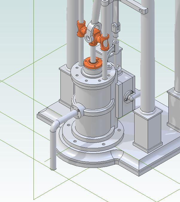

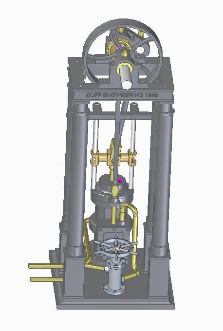

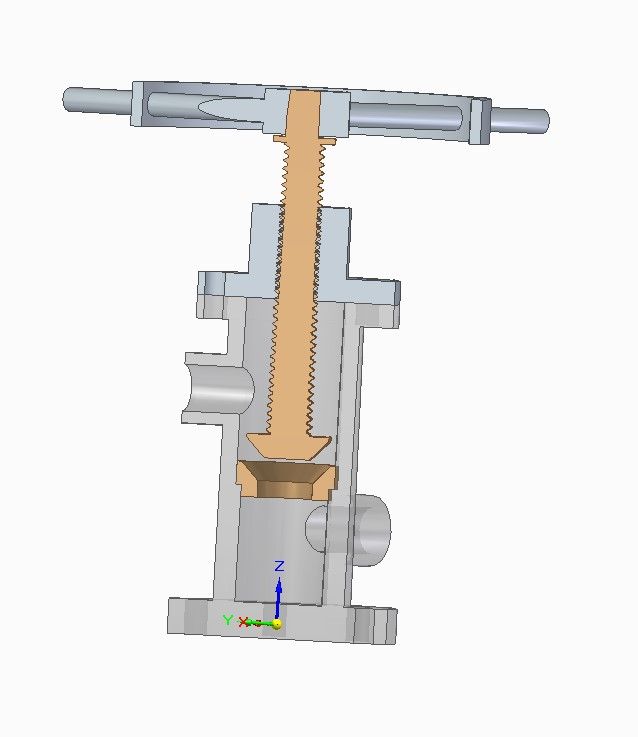

                                #599955
                                  Various fixes and additions: oilers, a throttle, new pipe runs, and embossed lettering on the top.
                                  Not sure about the throttle, which is guesswork as the section view shows:
                                  A tapered plug screws down into a matching seat. It should do OK as a stop valve, not convinced it has the fine control of a throttle. The cavity under the seal is purpose made to fill with water! I've also arranged it so steam comes in the top, which means the spindle is under pressure when the engine is off: not good when the gland leaks. I can see at least one other dubious feature.
                                  Got into a few fights with Solid Edge. 3D-CAD is great fun when it works smoothly but frustrating when it suddenly doesn't function as expected and for no obvious reason. Doubly annoying when the reason is found to be me doing it wrong!
