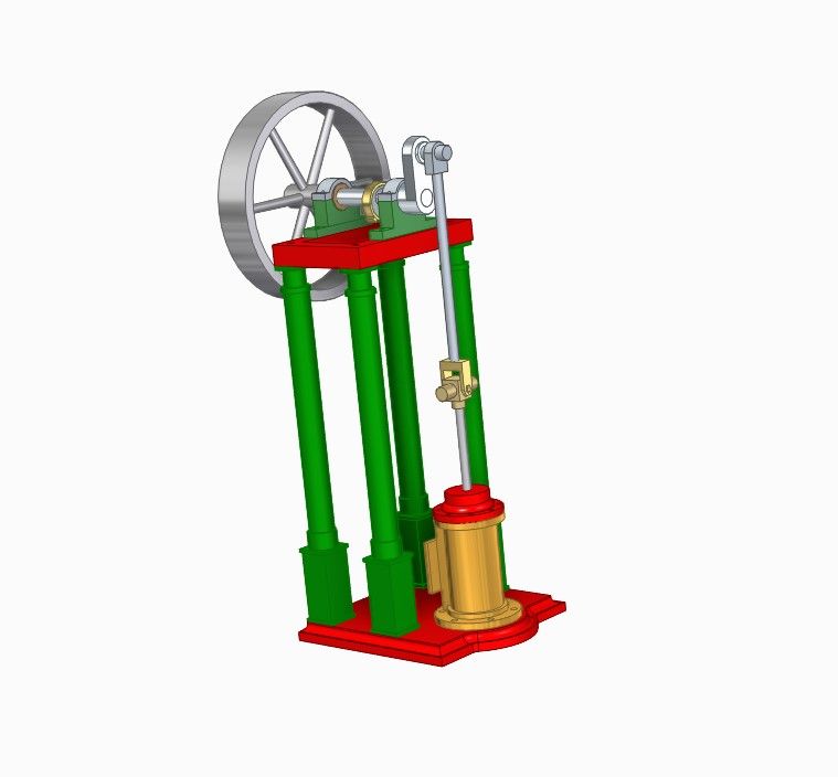

      This thread is about how 3D CAD helps designers spot errors as a design develops. It's founded on JasonB's build thread, which is inspired by the Stuart Turner Real Engine, based on a full-size type.

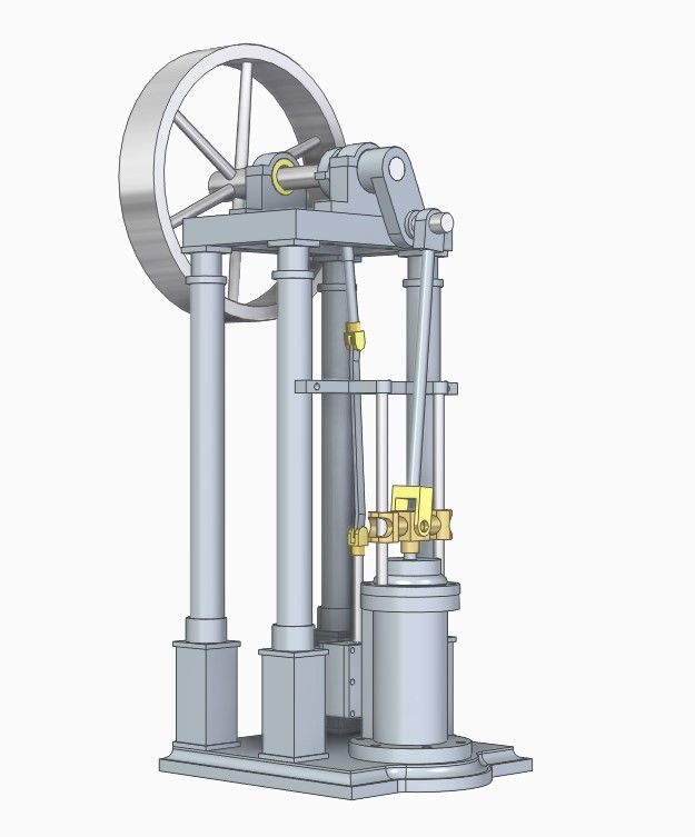

      Learning Solid Edge, I was looking for an advanced Assembly exercise in which I develop an entire engine from a photograph only.  The goal to create engineering drawings from an idea of the layout without the dimensions needed to build a working model. Jason often does this, and I can work from his latest .
      In CAD Jason's Real Engine looks like this::
      And my unfinished blinged-up clone in SolidEdge:

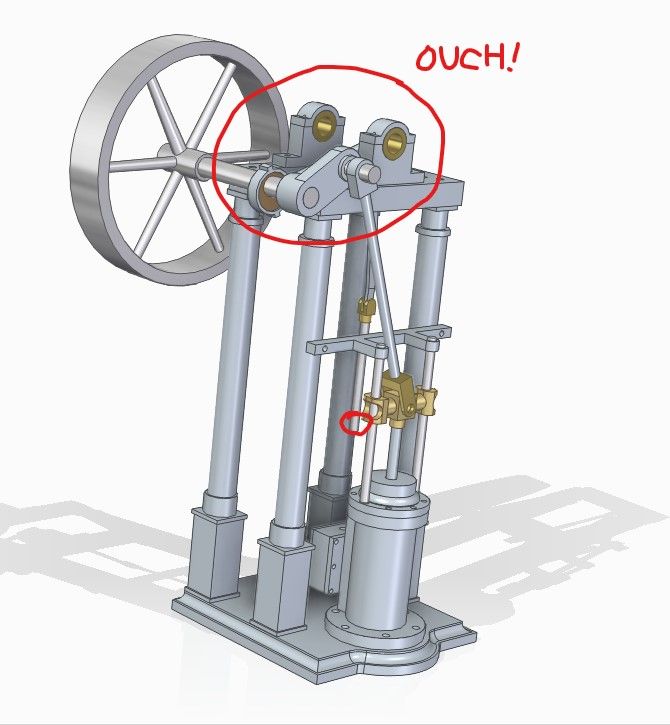

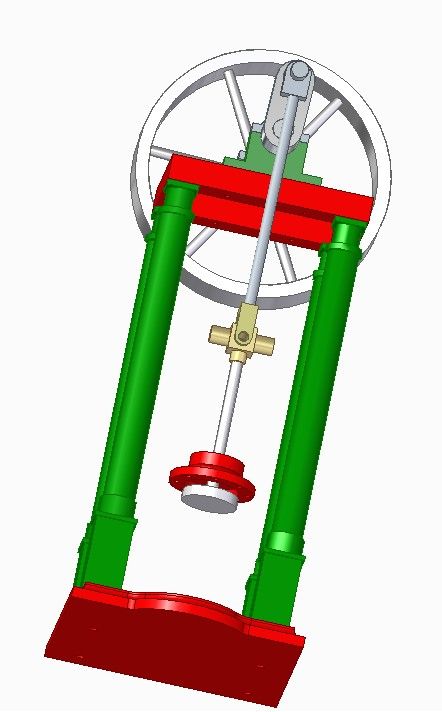

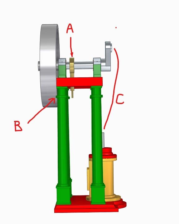

      Not bad, but CAD helps spot important errors:
      A – eccentric can't connect to the slide-valve (when it's added). Easy fix
      B – Flywheel is on the wrong way round and hits the frame. Easy fix.
      C – Base is foreshortened so the piston can't connect to the crank via the conrod. Fixing it is a good test of the CAD package: can I just slide the front of the base and the cylinder without disturbing the pillars and complicated headstock? Fingers crossed, I think it's easy.

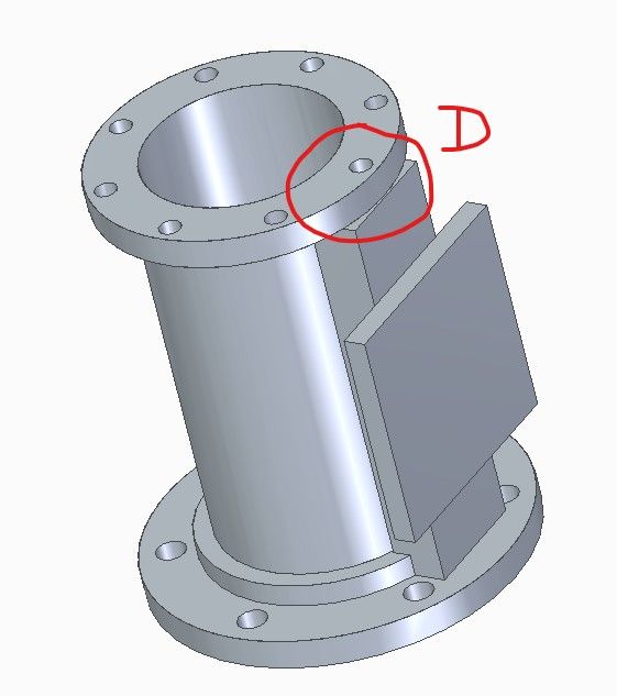

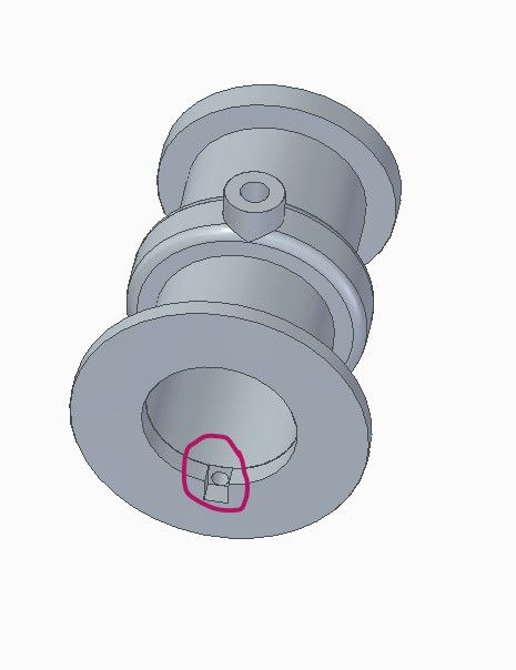

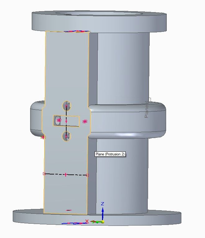

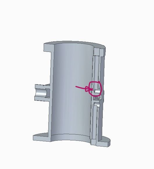

      A serious flaw in the cylinder:
      Here, one of the 8 PCD stud-holes, circled D, is too close to the steam port. All 8 holes need to be rotated to provide clearance.

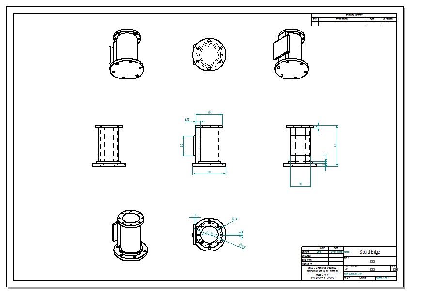

      I need a dimensioned Third Angle Plans to fabricate parts in my manual workshop, no castings. CAD generates the plans, and the operator adds dimensions and other annotations as necessary by clicking.
      The cylinder example reveals another glitch – the dimensions highlight the chance to use standard stock sizes has been missed! Reducing the amount of unnecessary machining and swarf.is always worthwhile.
      Makes me appreciate Jason's efforts even more!

          The eccentric won't be such an easy fix as when you move the cylinder further out the valve chest will move too and then you find the eccentric rod hits the entablature. Took quite a while playing about altering parts and then looking at the assembly as it updated to get something I was happy with.
          You will probably also need a 5 stud bottom cylinder cover fixing as your nuts will be close to the passages. Yes it's a separate part so you can bore the cylinder right through not blind as you have it

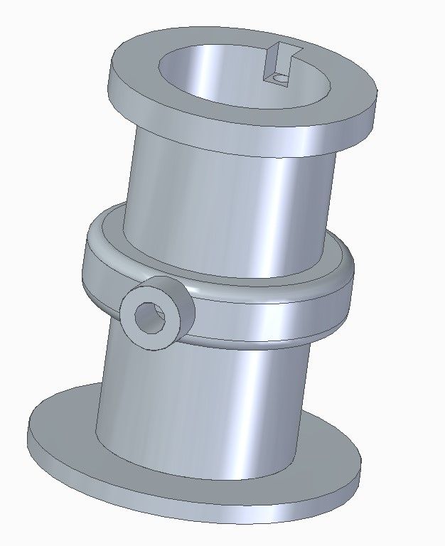

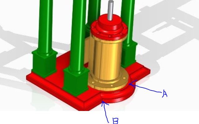

                A few improvements: the pillars weren't long enough to accommodate the piston stroke, so I lengthened it by eye. Jason's point about the tight corner is corrected, sort of, Added a conrod, and made a start on the guide slide, and connected the piston. Also moved the eccentric along the shaft – didn't dare look to see if it fouls the top, I think Jason is right, it will.
                The concentric constraint between cylinder and base isn't missing – optical illusion. the garish colours don't help!
                Ought to rotate and move the piston now but doesn't. Can't see why not. I'm finding Solid Edge fey about maintaining rotation lock/unlocks – seems to flip them when I'm not looking.

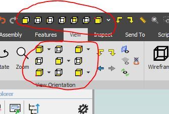

                jbclonega2.jpg .
                And I can't get the model straight on the screen!

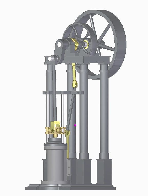

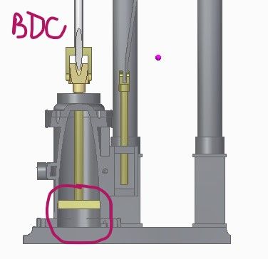

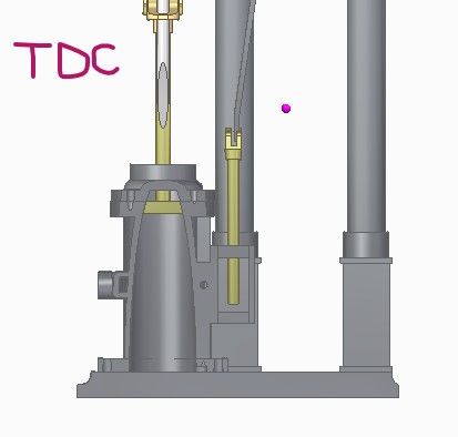

                  After dinner and beer, I found the duff constraint and fixed it allowing the flywheel, crank and piston do move together. Problem: the piston hits the bottom of the cylinder just before bottom dead centre, crunch:
                  I can turn off the cylinder to show the piston has about 4mm clearance at top dead centre:
                  Suggests shortening the conrod by 4mm will allow the piston to run full travel inside the cylinder without hitting the ends. Hope so because the other options are more complicated – changing the cylinder length, crank throw etc.

                    That's why you design the mechanism first, and add the pretty pillars and base once you know it's all going to work. That way, all you'd need to move would be a well defined plane….

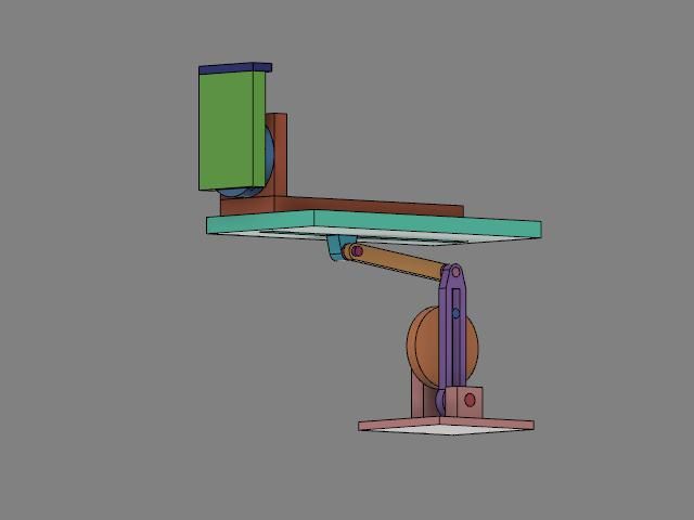

                    As an example here is my doodle for a small, fabricated, powered shaper that would work, but shows where the material needs to be rather than where I thought it should be(the blue top plate supporting the ram needs to be shorter in the front and longer in the back)
                    This was more of a mental exercise for how the mechanism works, using some guesstimated basic dimensions

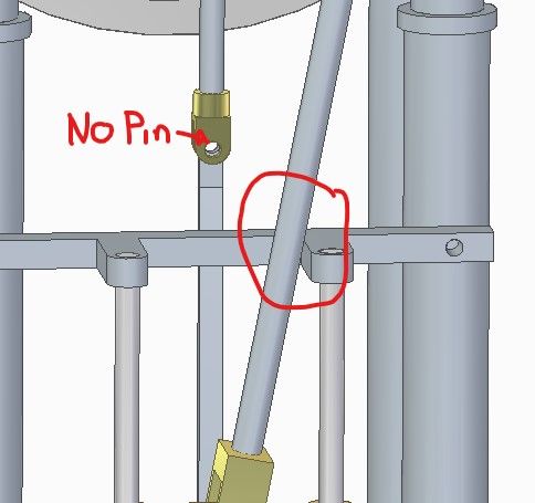

                        It's not just the piston travel that needs to be checked, the angular movement of the conrod needs to be checked to make sure it does not hit the tops of the guides in this layout so there will be some playing about with the guide length, cross head, conrod and piston rod.
                        I would have thought SE has a "section" option, I use that a lot in alibre to check for things like this when assembling parts. As Pat says transparent parts can also be useful..

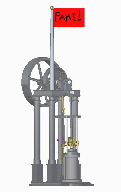

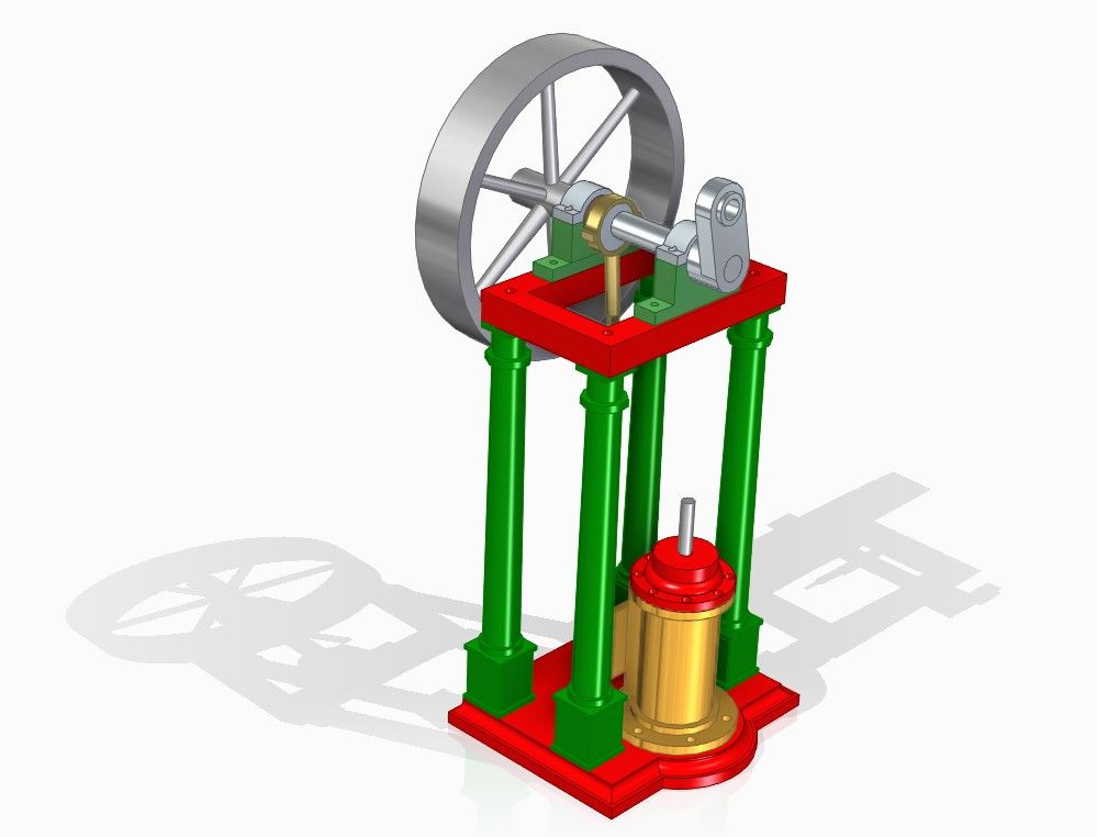

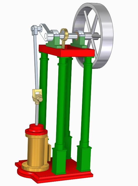

                            Well, 3 steps forward, 2 back. The reason the model wouldn't sit straight on screen was I must have accidentally rotated the base off the top plane at some point, don't know how – some sort of 3D earthquake.
                            Added guide rails, valve box, connected the eccentric and dropped the psychedelic colour scheme.
                            Another huge fight with relationship constraints today, I think because I don't understand them properly.
                            Despite bugs the model nearly rotates properly, except the axle jumps out of the bearing blocks unless the flywheel is turned dead slow. I believe the model's parts jumping out of position is caused by setting one or more relationships incorrectly and/or by an interference.
                            Jason was right about the eccentric not aligning with the valve box, it's about 7mm out. For the time being I've fixed the error with a bent strap.
                            Still lots of flaws in the engine and my CAD technique.

                                Dave, have you tried aligning the axis of the shaft and axis of the bearing blocks ?

                                  I'm impressed – that fixed the problem! I spent ages looking for an incorrect constraint, when it was missing entirely. A mistake!
                                  Choosing constraints calls for a level of judgement. For example, I've discovered leaving pins out of joints works well and is less likely to go wrong!
                                  Also rotating the crank shows the conrod comes perilously close to the guide rails, but I got away with it. However, if I upgrade to a proper tapered conrod like Jason's, there's a high risk it will collide with the stanchion. I have a choice: fix it properly, or pretend a straight conrod was deliberately chosen to be easier to make…
                                  Have to go shopping now and resent it. As Pat says 3D modelling is addictive – another kind of Joint!

                                    Dave, not usual to have two pivot points. in the eccentric rod as the valve rod could just remain stationary as the upper joint moves sideways.
                                    Otherwise you are getting close and at this rate should be able to start making it by the weekenddevil

                                      Thanks, I wondered about that. Blame my unofficial mentor – that part of the eccentric and it's rod aren't visible in the image I pinched off you!

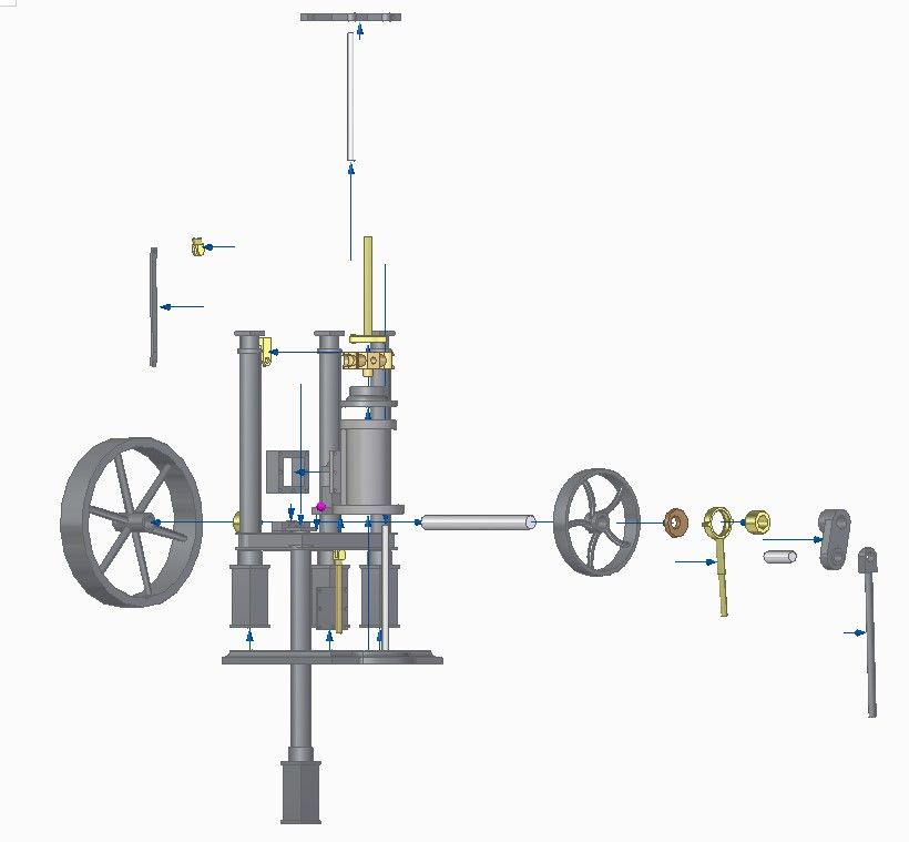

                                      Today I added the belt-pulley and defined all the part materials before moving on to 'Explode Render Animate'. Animation was a little fiddly, but I can now generate a video of the engine turning.
                                      Latest version:
                                      The purple dot is the Centre of Mass.
                                      Explode is quite fun and potentially useful when trying to work out how a pile of incautiously removed parts go back together. (Mum's kitchen clock never worked again!) Below is auto-explode, I think I could do better with the manual tool.
                                      Identifying the materials and looking at the final dimensions shows this to be big by my standards, Would stand about 300mm tall, weigh 3.75kg, and contain 34 parts of which 26 are unique (excluding nuts and bolts). Mostly structural steel and brass, except I assumed the cylinder is cast-iron,
                                      The Centre of Mass is slightly higher than the cylinder top, about a third of the total height. Better than I expected, and the COM doesn't move much when the engine rotates! Another credit to the original designer is the excellence of the static balance: X is only out by 0.35mm and Y by -0.94mm. Likely the Dynamic balance is less satisfactory because the whirling crank and power take-off are perched on top of 4 tall unbraced pillars, but even so may not have been a problem at steam speed.
                                      My reading of the CAD model is that this engine is a good design.
                                      As to making one, I have to confess I started filing a small slot in an Aluminium tube last Sunday and still haven't finished… This would keep me out of mischief for months.
                                      Other excuses, there's ore to do. I haven't tackled the steam passages or the valve yet.

                                        You have come up a bit short again Dave, mine is 390mm to top of flywheel
                                        #599493
                                          Posted by JasonB on 26/05/2022 20:30:20:
                                          No problem, my engine is now bigger than yours!

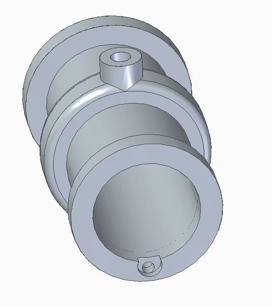

                                          Back in the Real world, I've started work on the cylinder and am unhappy about exhausting at the front through a belt; I can't think of a way of fabricating it with a lathe and mill.
                                          Complicated around the back too:

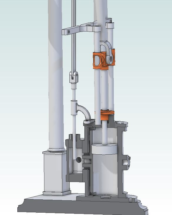

                                          A section view like one you did with Alibre would be handy:
                                          Today's mission is finding out if Solid Edge can do the same. And then swap armchair for bench and catch up on some actual metalwork. (Tedious filing, which I can't keep straight.)
                                          Edited By SillyOldDuffer on 27/05/2022 09:19:41
                                          #599533
                                            Good news, producing Section Views with Solid Edge isn't too difficult, especially from a simple plane:
                                            Shows a couple of potential build problems. The red ringed steam inlet hole is close to breaking through into the cylinder and the two vertical steam ways are dangerously close to breaking into the exhaust passage, The holes are drawn with flat ends, real ones would be made with 118 degree tipped twist drills, and the deep holes might wander too.
                                            The entry points at the rear into the belt look a tad awkward to get at:
                                            And I don't like the square edged steam-ports either!
                                            Best to fix it even though I suppose most builders would ignore the design and mill a semicircular port.
                                            Another design question: how deep and wide should the semicircle be? I think the output area into the cylinder should be somewhat larger than the steam passage. In my cylinder the passage is a 3mm diameter hole, 7.1 square millimetres, so specifying the exit slot be cut with a 6mm end-mill 2mm deep gives roughly 10.5 square millimetres, an aperture that shouldn't throttle the engine. Nor should the exhaust belt, which is twice 15 sq mm into a 5mm diameter exit (19.6 sq mm)
                                            The bends and narrowness of the cylinders steam ways might be improved. Increasing the diameter of the steam passages through the cylinder would be good because a pipe's steam capacity follows a square law. In this engines a 4mm hole rather than 3mm almost doubles the amount of heat available for conversion to mechanical work by the piston.

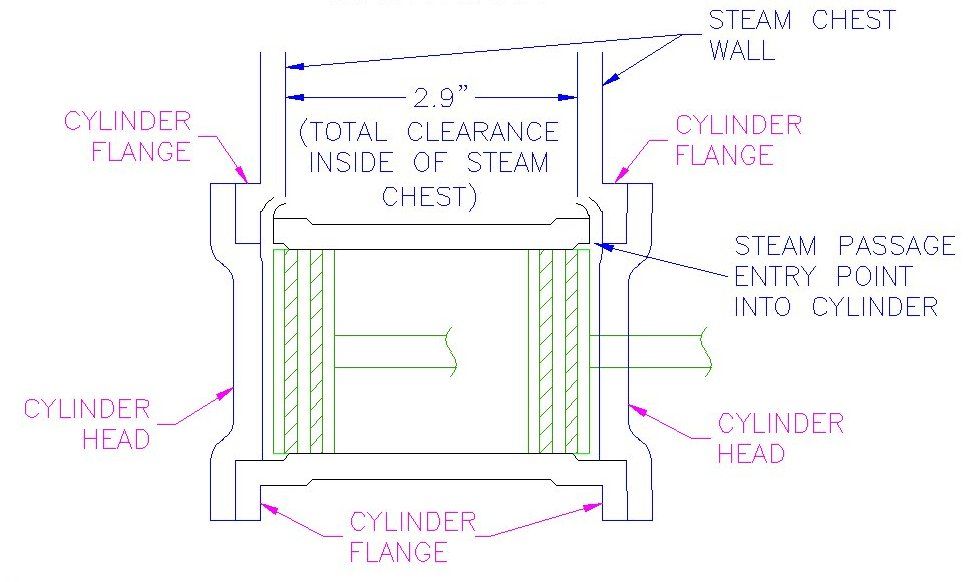

                                              Dave don't forget to take into account the fact that part of your semi-circular notch could get covered by the usual spigot on the cylinder covers so it may need to be deeper or you can notch the cover spigot.
                                              The Stuart casting has the passages formed by rectangular section cores and area is 22.8mm2
                                              On cylinders that have the passages drilled it is not uncommon to use more than one hole, I'll not make you draw this many but they start from a different position around the diameter but all end in a straight line so 3 different angles x 4 sets of 3 holes. Also no issues with the cylinder cover stud in the middle on this engine.

                                                I would think that this model works at fairly long cut off so clearance volume won't affect the mean effective pressure very much. Making the ports and passageways bigger will reduce the pressure drop therein, but piston speed is so low in models that small ports are acceptable. Given the bore/stroke/rpm and passage size I could work it out, but I doubt it's worth it.
