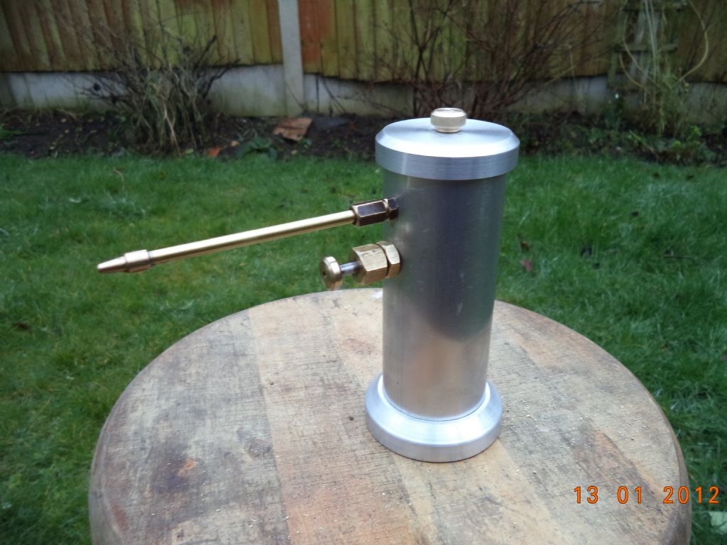

                                                  Stewart Hart
                                                    @stewarthart90345
                                                    Hi Bryan
                                                    Her's a picture of my eagle type oil can, I've got a Reilang can and can say the eagle is just as good but in making it I did find one important thing out if you have a perfect seal the can won't work you need to let air into the top of the can to fill the space of the displaced oil as all you are doing is creating a vaccum, I also never fill it above the plunger as this is another area it can leek from, I regularly take the eagle to the track I just keep it standing up, that's why cans of this type have a nice flat base.
                                                    Take care I'll call soon
                                                    Stew
